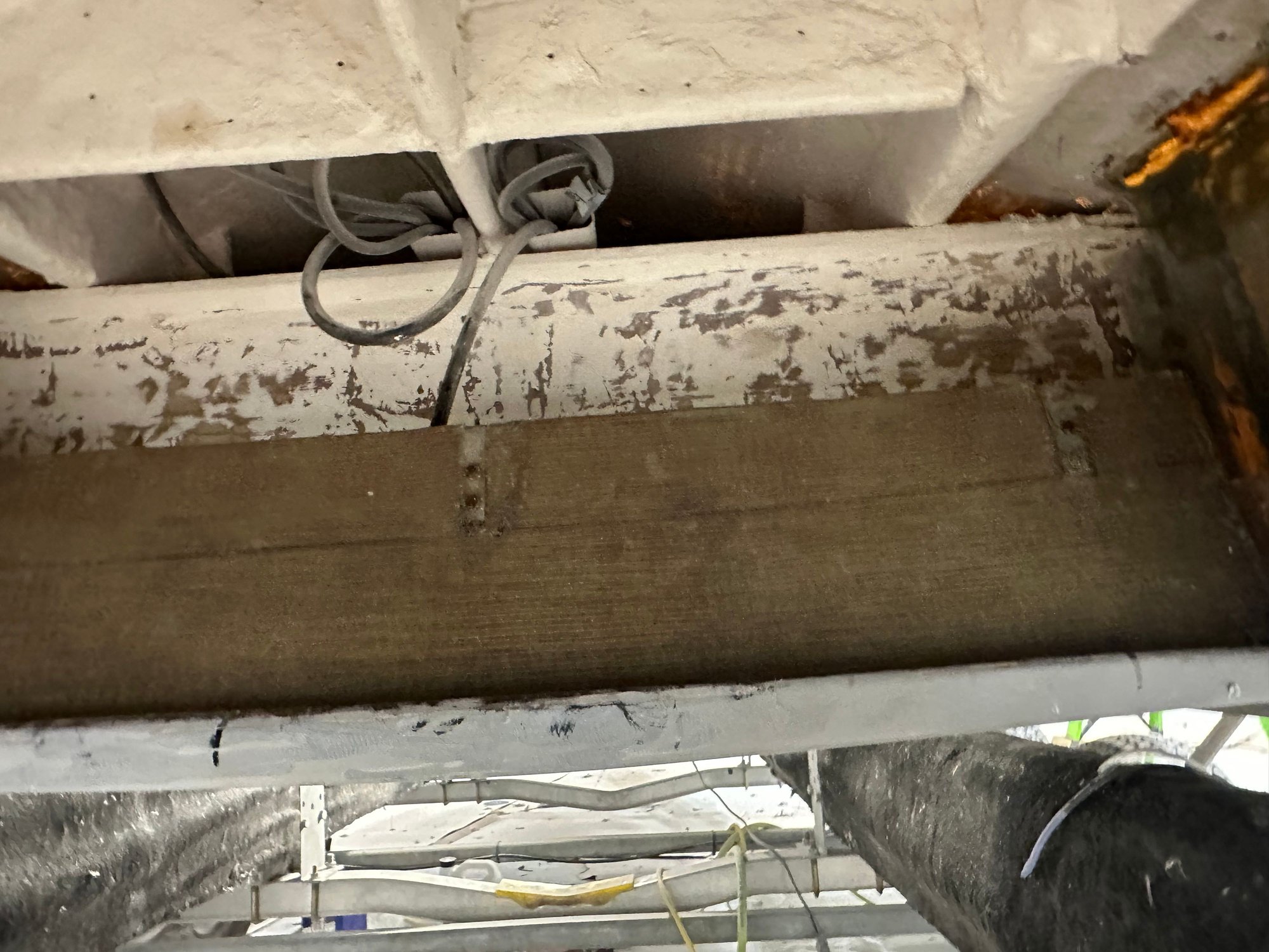

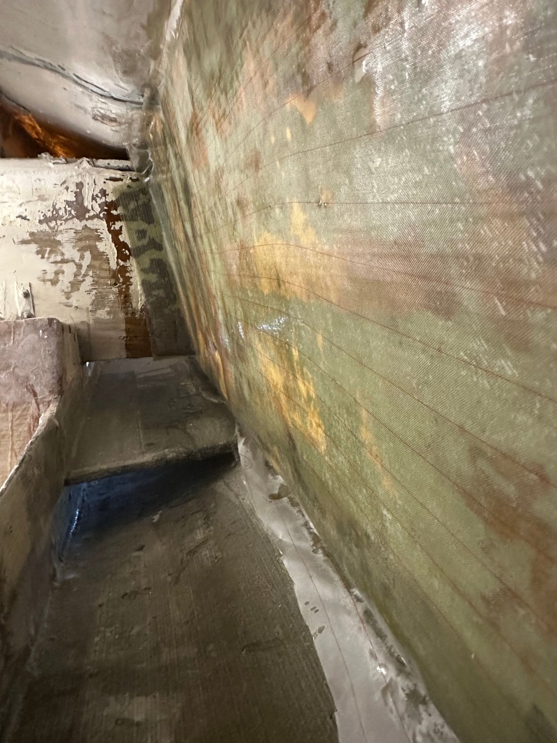

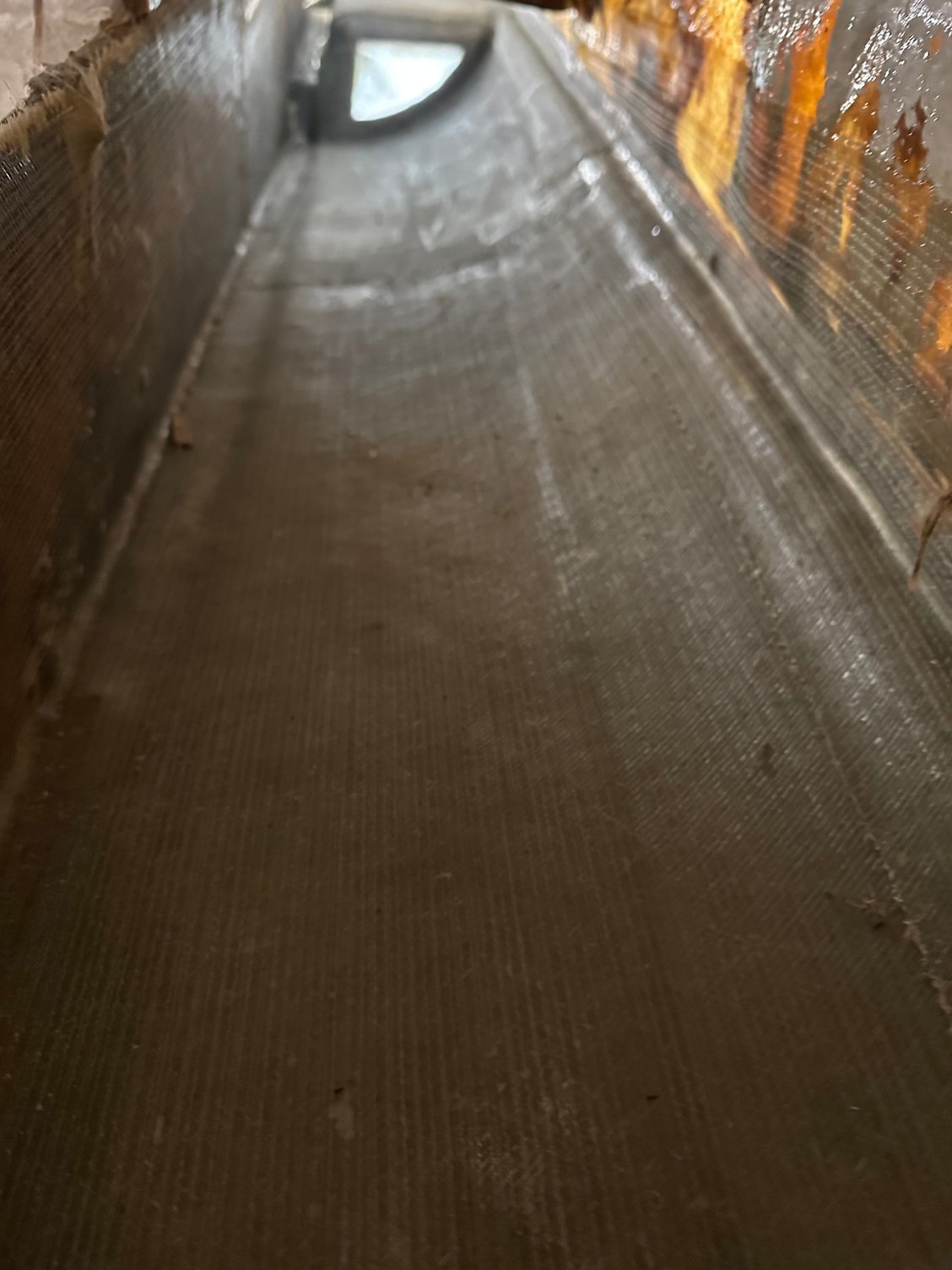

Gunnels glased
https://cimg8.ibsrv.net/gimg/www.off...9bdf1f87c.jpeg
Port and Starboard ground out and glasses with 1708

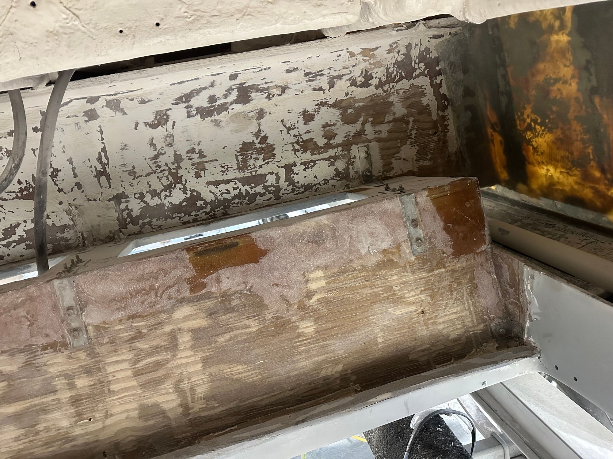

Drake22.250 04-21-2025 07:42 PM
Air vent boards
https://cimg7.ibsrv.net/gimg/www.off...ac116ca46.jpeg

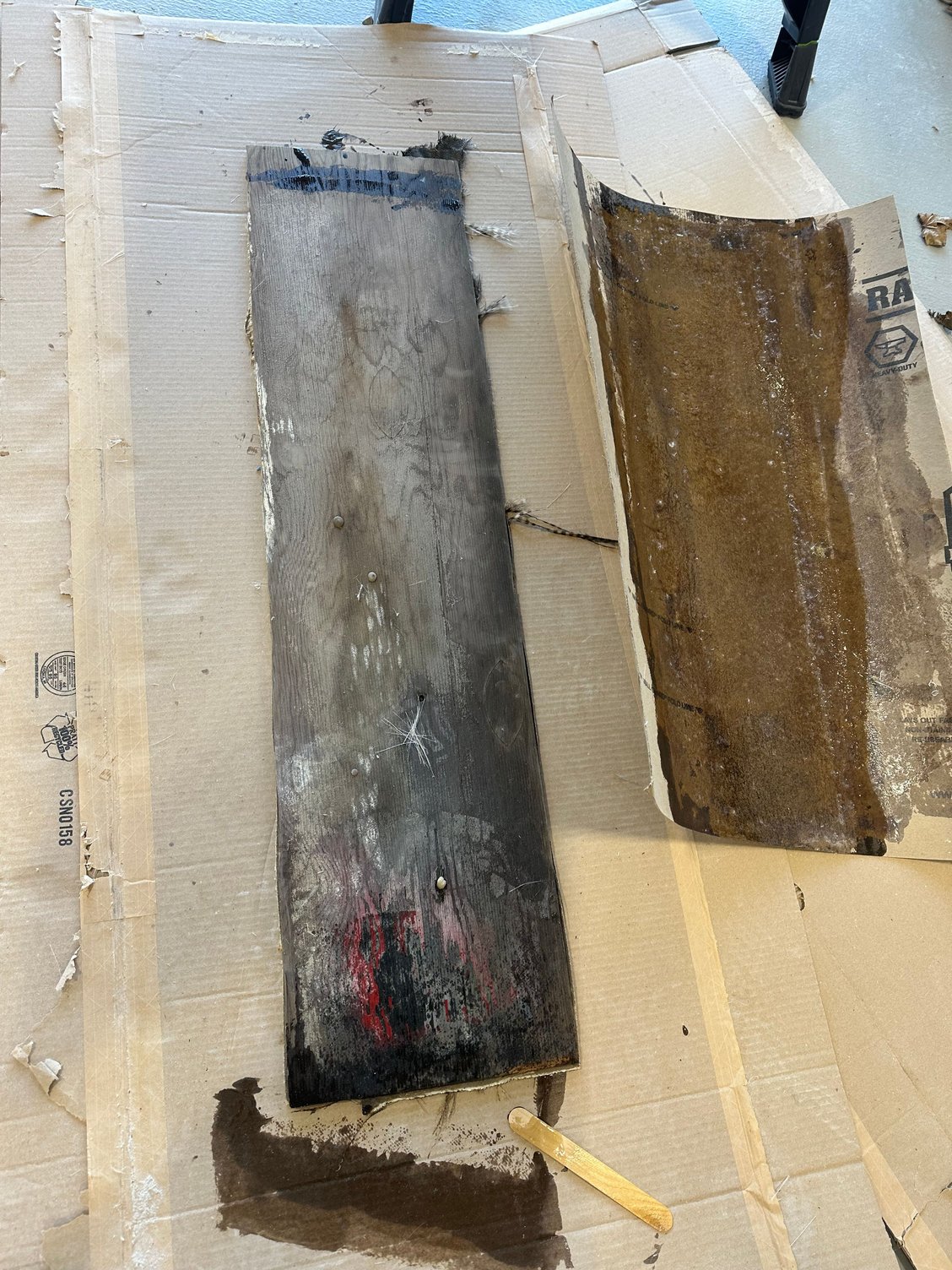

Old board was not covered, bare wood exposed
https://cimg9.ibsrv.net/gimg/www.off...ddc079d3d.jpeg
New vent structure will be out of coosa with layer of 1708 on each side and glassed back in with 6 inch 1708

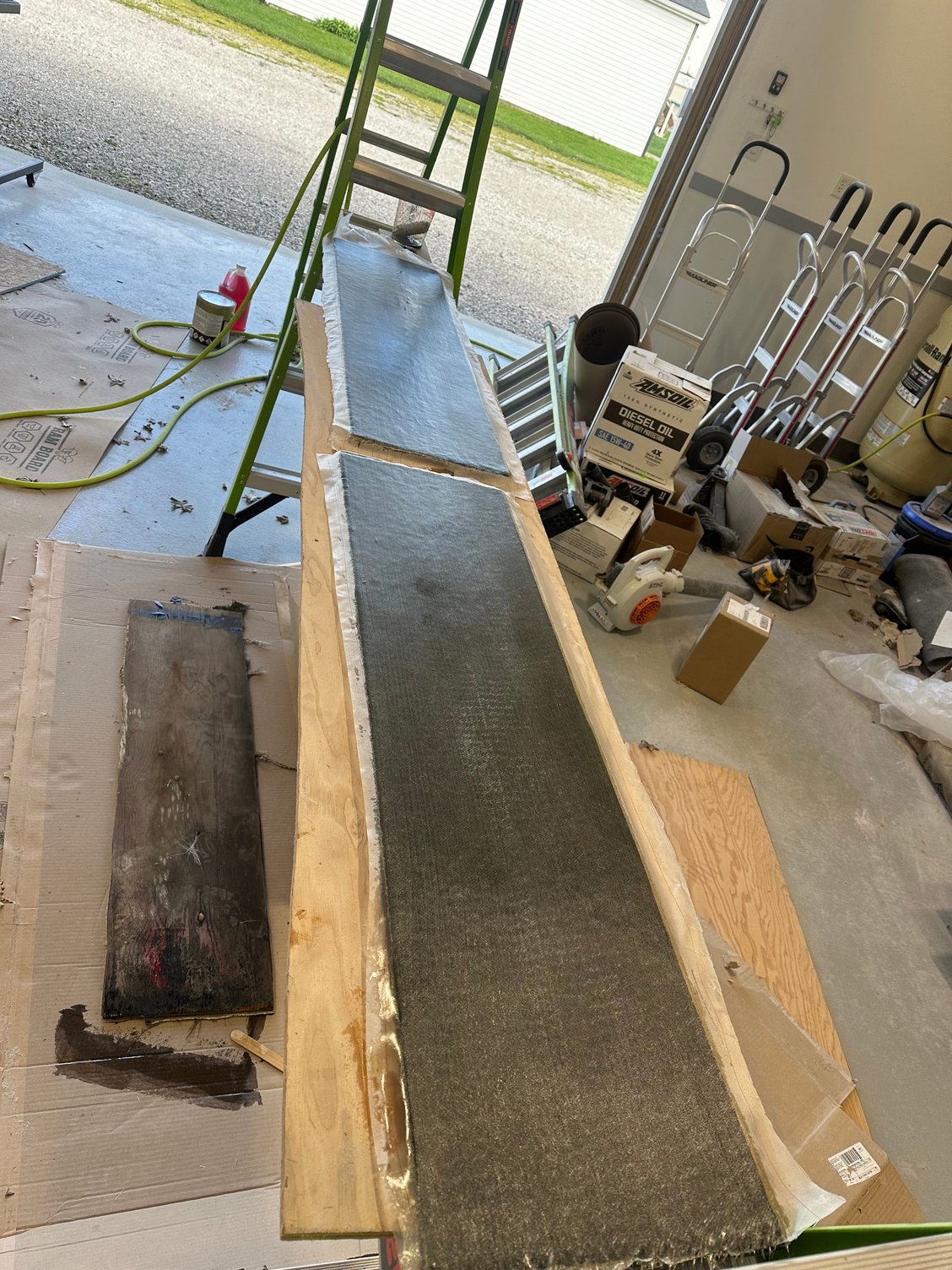

Drake22.250 04-27-2025 12:20 PM
https://cimg5.ibsrv.net/gimg/www.off...3b111662b.jpeg
Air vent board glassed in add 2 layers 1708 with peel ply to sides.
https://cimg2.ibsrv.net/gimg/www.off...9966754e3.jpeg
Coosa board for air vent

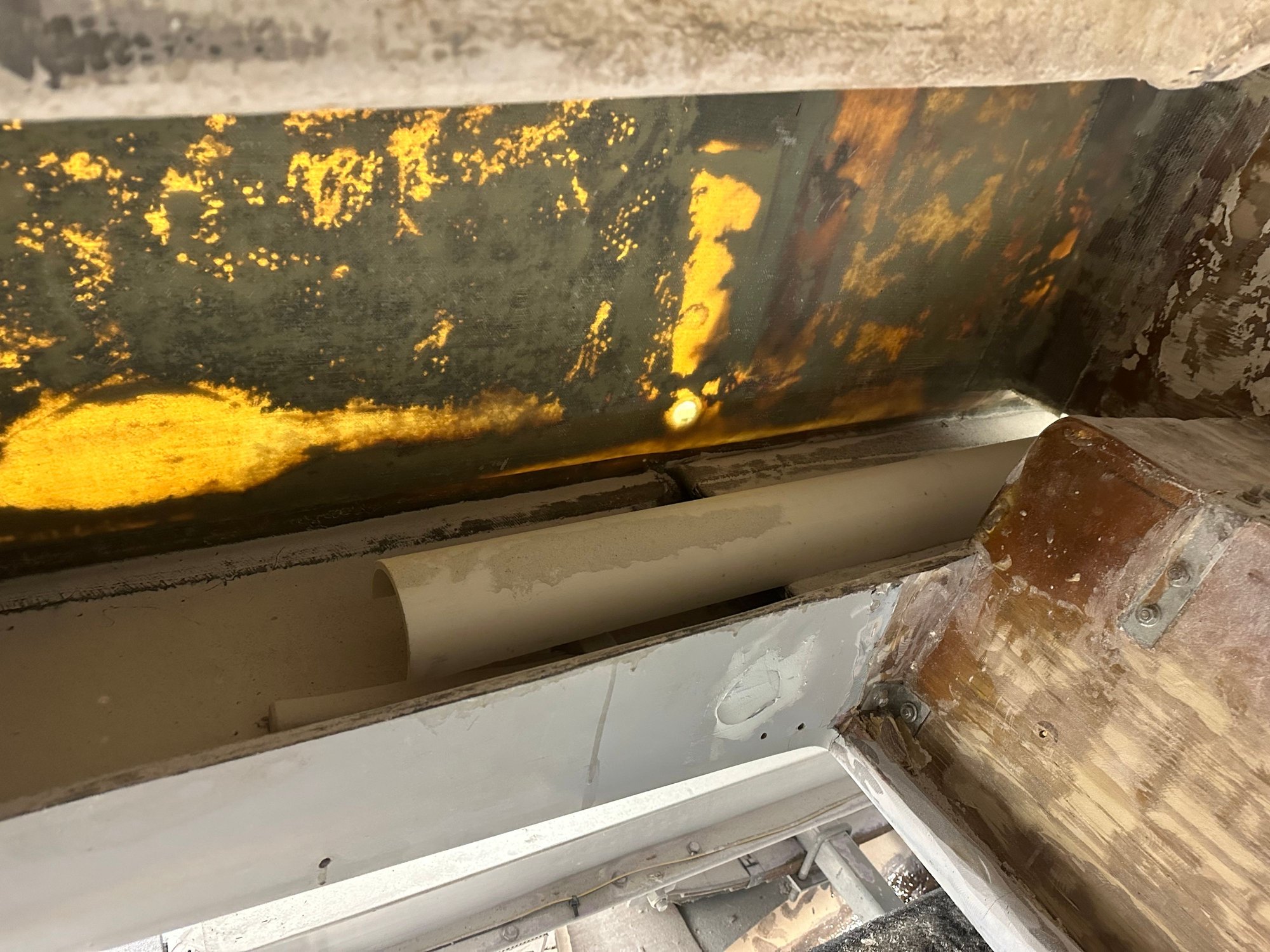

Rigging tube
https://cimg2.ibsrv.net/gimg/www.off...81ee7b871.jpeg
Cut some 4 inch tube to sit flat, going to glass in should make rigging cleaner
