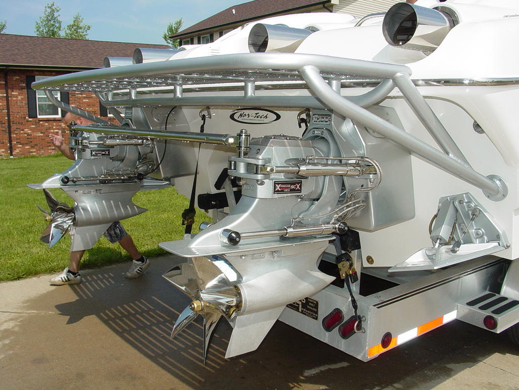

First day was a disaster. Yesterday we fired them for the first time on the hose, they fired instantly and sounded great. Put it in the water today and cant get it to idle and wont go over 1200 rpm's in gear. Bring it back to the shop and go through the carbs and run a larger wire from the ignition switch (spark would shut down and would not start for about 5 minutes each time it would stall). Go back to the water at 6 PM and the engines are still not running right but we are able to run the boat. Get out in the lake and it runs up to about 20 MPH and brakes the props loose nose starts to settle down and the props would grab again and cuts the engines out. Burned my hand, cut my leg and cut the end of 1 of my fingers.....done for today.
