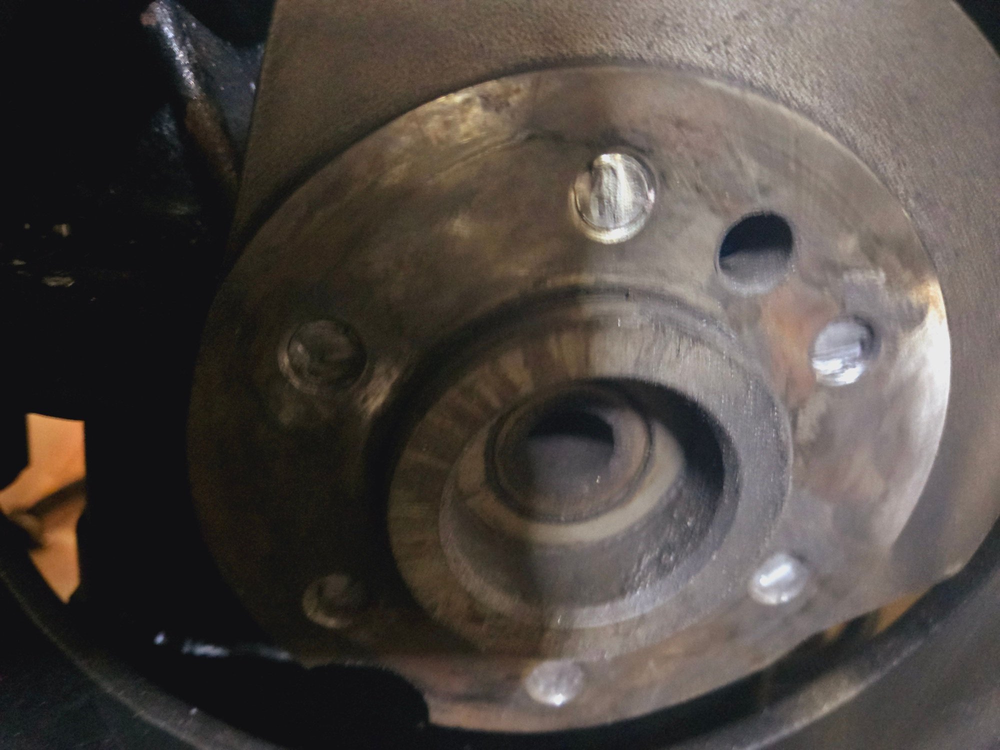

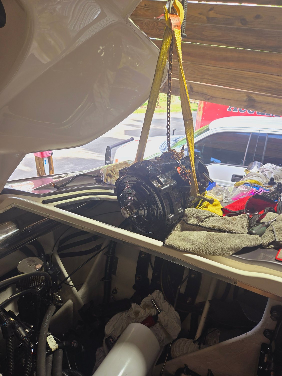

Motor started to sound funny , clanking at idle and after replacing blower fluid (sounded like gear lash)and adjusting lash it broke at home on the hose. I guess Im lucky in that way, could have exploded at 5000rpm causing a ton more damage
Anyway, new parts will be here tomorrow. Billet flywheel instead of cast and a heavier duty dampner plate and ARP bolts.
5 broken bolts took an hour to dril thru and extrack but of course on one the easy out broke inside the hole ... that took 2 days of swearing and throwing things to fix, but thanx to IZOOM Mike and others that helped with some specialized cutting bits I got it out .
Thank you Nor-Tech for the nice opening , seems like it was made to take out the trans .

That is not motivating for sure... so what broke in the engine?
IGetWet 07-12-2024 05:14 AM
Sh!t son. A flywheel broke and lost some blower gears?
What caused the flywheel to shear like that? Obviously was under a lot of stress for some time.
ICDEDPPL 07-12-2024 09:53 AM
The blower gears are fine , I thought that was the noise but it was a loose fly wheel the entire time.
Not sure the cause .. bolts loosened up is my guess. Also cast flywheel for 1200hp? Not the best choice.. should be billet .
