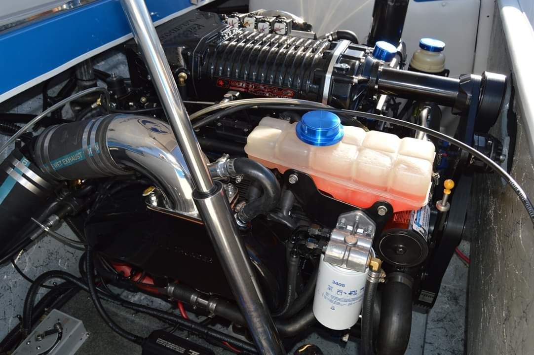

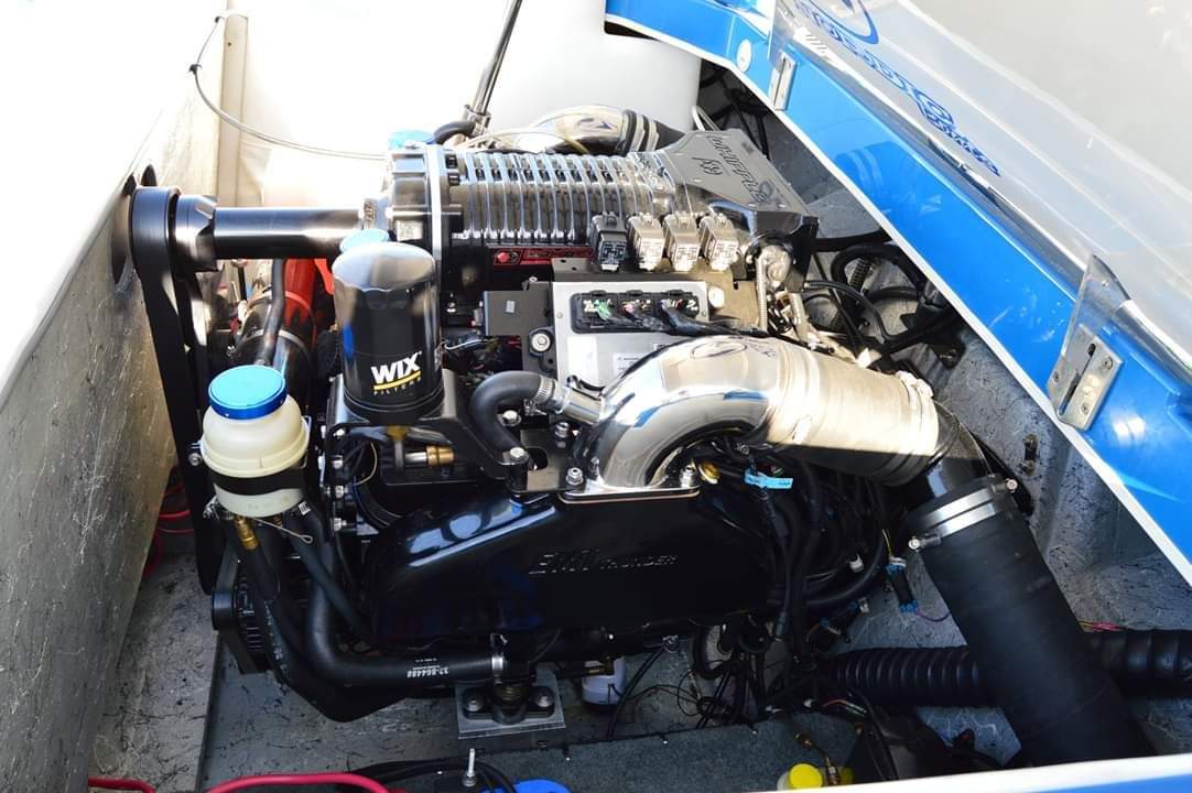

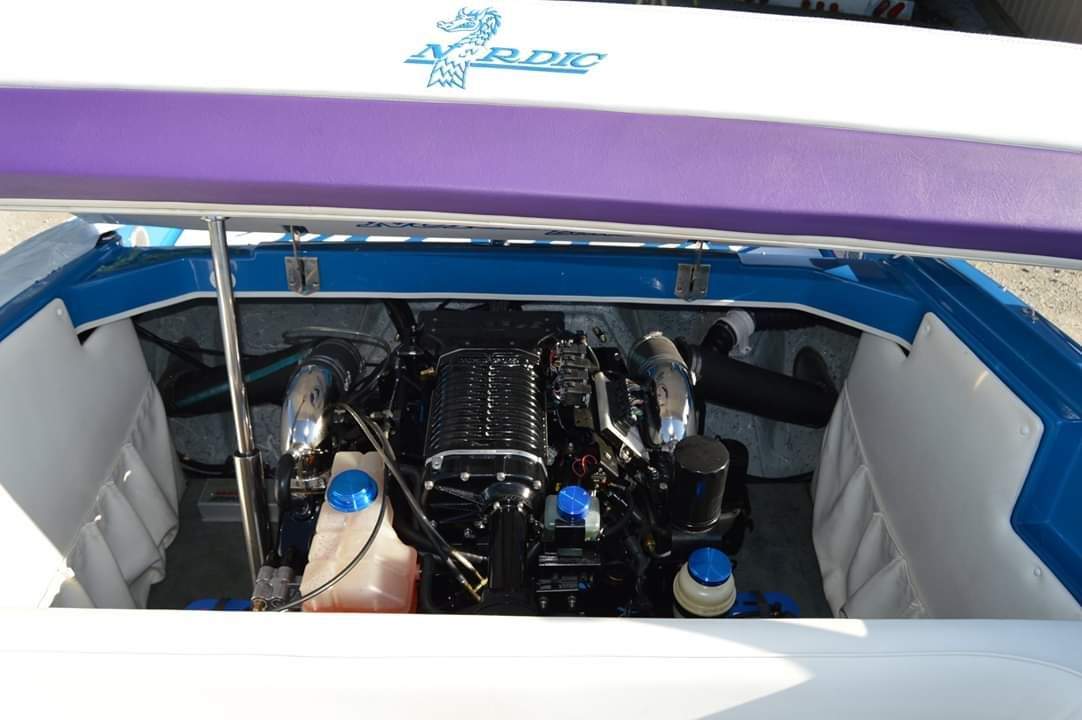

I'm researching adding a whipple to my 2004 Heat with a 496HO. (I will be doing forged internals at the same time). I'm getting conflicting answers on the rear seat clearance. I found several pics of the 25' Rage install and it needs a fair amount of seat and hatch modification. I found only 1 example of a heat install (performed May 2018 I think) and I have attached those pictures. Does this representation look right? It appears there has been no modification to the hatch, only holes cut into the seat back. I think this example is a mid 2000s vintage like mine. Any help on this would be appreciated! Thanks

I know this boat pretty well. The seat was moved forward 1.5" for clearance. There is also a 1.5" spacer behind the purple strip on the engine hatch.

Now that you mentioned the purple pad I see what you mean. This helps me greatly thanks so much! This looks like a great solution that should be easy to do.
