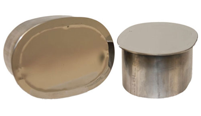

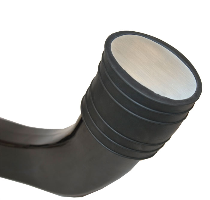

You could just pull the diverters out and replace them with a straight black exhaust hose and then cap the Y-pipe oval openings.

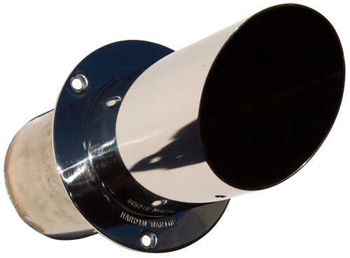

Another option is just remove the Q&Q pipe and replace it with a thru hull exhaust modification pipe and new tips.
Now the right way would be to remove both engines, remove the Y-pipes all together and install the block off plate for the thru prop exhaust opening. Then remove the Q&Q tips wile the engines are out and install new tips of your liking.
