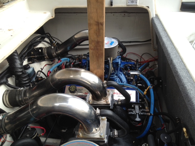

eriknelson 06-21-2012 06:05 PM
1 Attachment(s)
Attachment 477238
