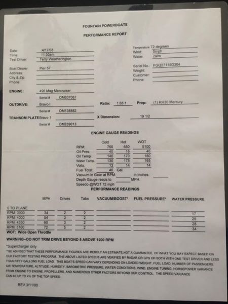

c0ncEpT 08-09-2019 12:44 PM
Originally Posted by F-2 Speedy (Post 4701260)
Have you measured the center of the bullet ( prop shaft ) in relation to the bottom of the boat in neutral trim ? the drive must be high
X-dimension on these boats are 19-19.5"

PFL 08-09-2019 05:24 PM
Thanks for the info. It also have a notched transom, so should I measure from the notched part or from the lowest point at the bottom?
c0ncEpT 08-12-2019 08:51 AM
You should be able to call Fountain with the HID and get the performance report.
https://cimg7.ibsrv.net/gimg/www.off...5e86f0d97b.jpg
