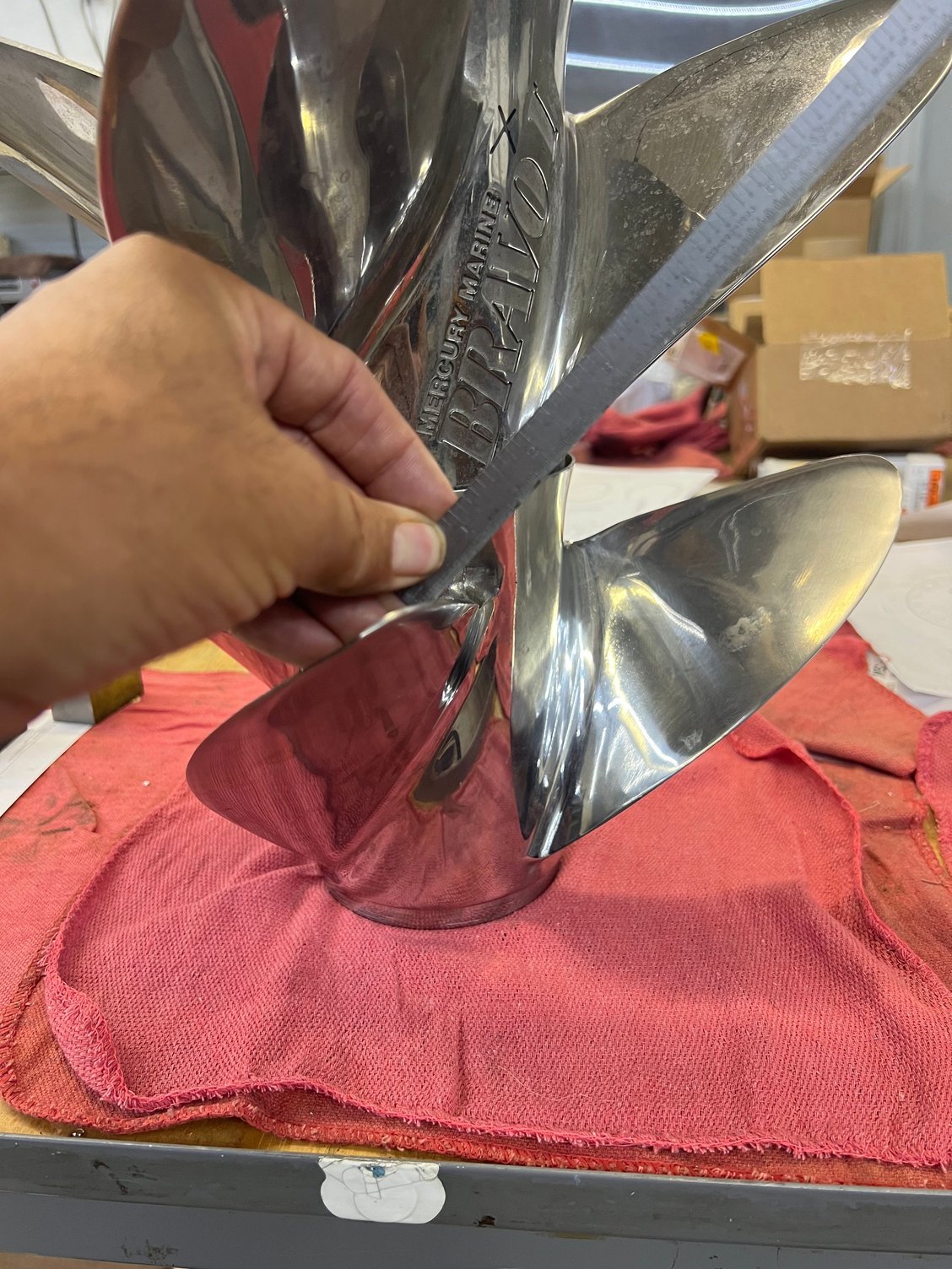

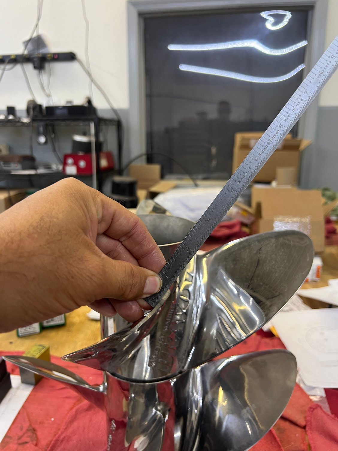

Guys,
I think I found it: Trailing edge cup.
Trying my best to duplicate measuring method and target points…..https://cimg7.ibsrv.net/gimg/www.off...6be185fe6.jpeg
https://cimg8.ibsrv.net/gimg/www.off...49d95773e.jpeg
Can you tell which one is faster? The older prop has an “X” marked in Sharpie on the hub, right above the “Bravo”. You can also easily feel the distinct reduction in cup in the last half inch or so of the trailing edge of the newer, slower of the two props.

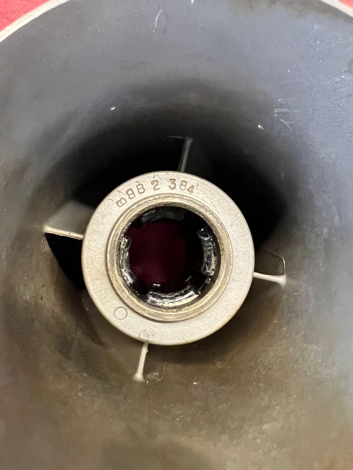

Also found this:
https://cimg9.ibsrv.net/gimg/www.off...98a5ee609.jpeg
Is that a BBlades documentation number?
Thanks. Brad.
Griff 07-25-2023 03:42 PM
Yes, that is a BBlades labbed serial number and they keep all the specs on file.
