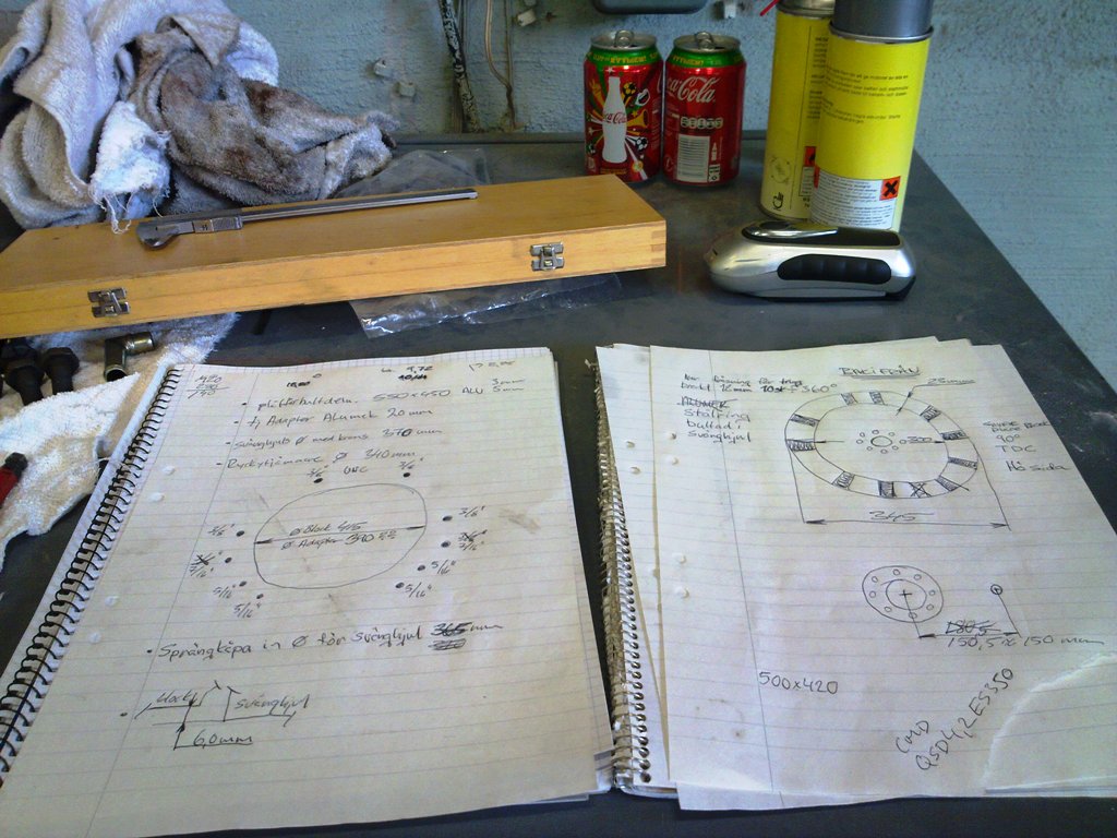

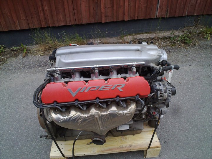

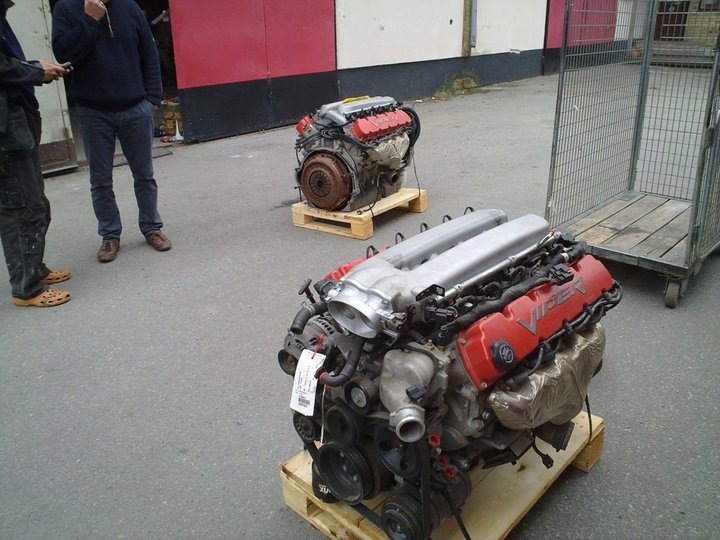

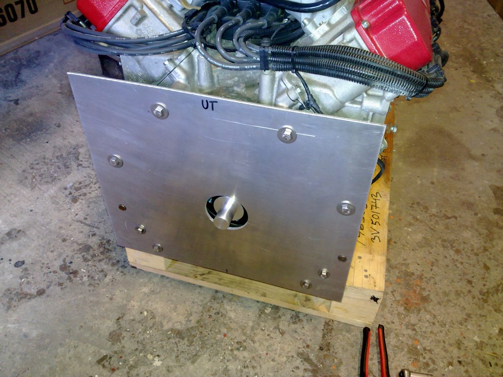

The engines arrived after a long wait and we started to make a template for the adapter to make the Viper engines work with Mercury transom.
[ATTACH=CONFIG]511137[/ATTACH] [ATTACH=CONFIG]511138[/ATTACH] [ATTACH=CONFIG]511139[/ATTACH]
[ATTACH=CONFIG]511140[/ATTACH] [ATTACH=CONFIG]511141[/ATTACH] [ATTACH=CONFIG]511142[/ATTACH]
[ATTACH=CONFIG]511143[/ATTACH] [ATTACH=CONFIG]511144[/ATTACH] [ATTACH=CONFIG]511145[/ATTACH]
[ATTACH=CONFIG]511146[/ATTACH]

Here are the adapters finished
[ATTACH=CONFIG]511147[/ATTACH] [ATTACH=CONFIG]511148[/ATTACH]
[ATTACH=CONFIG]511149[/ATTACH] [ATTACH=CONFIG]511150[/ATTACH]

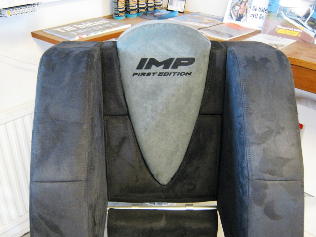

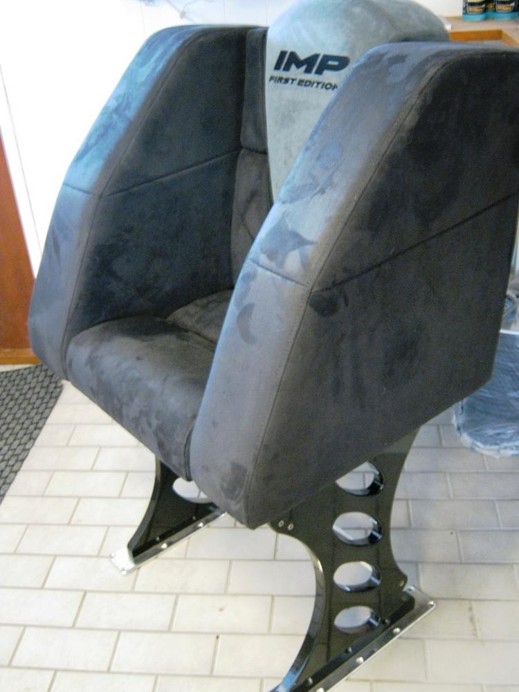

The last pics for the day is on the finished bolsters
[ATTACH=CONFIG]511152[/ATTACH] [ATTACH=CONFIG]511151[/ATTACH]
