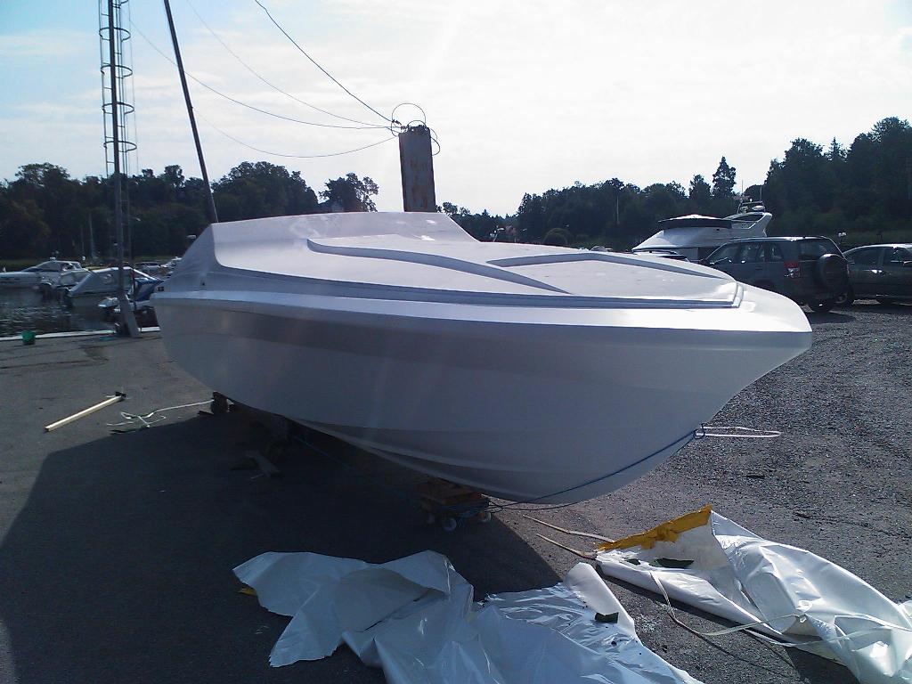

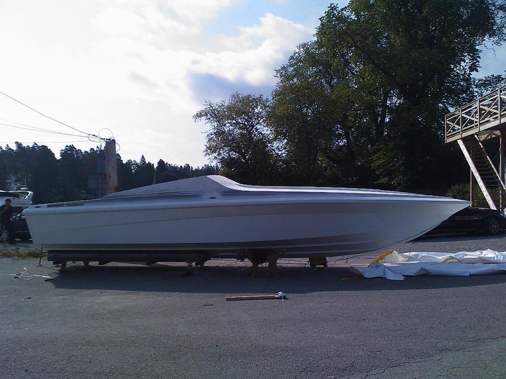

A few pics of the paint job
[ATTACH=CONFIG]511133[/ATTACH] [ATTACH=CONFIG]511134[/ATTACH]
[ATTACH=CONFIG]511135[/ATTACH] [ATTACH=CONFIG]511136[/ATTACH]
Attached Thumbnails IMP 310 Rebuild/modification-31.jpg   IMP 310 Rebuild/modification-31_1.jpg   IMP 310 Rebuild/modification-31_2.jpg
IMP 310 Rebuild/modification-31_3.jpg
