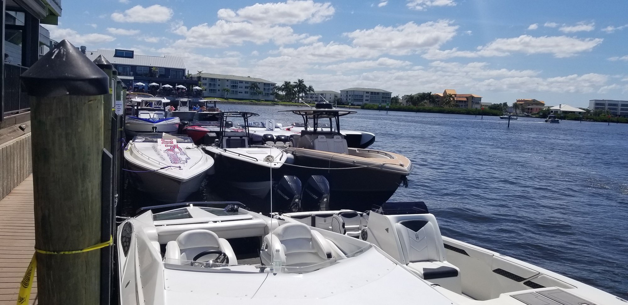

Here is a few pics from the Charlotte Harbor run last weekend. Was first time for the event, but still a nice turn out on short notice. Curious wet spot on the side of that bridge I noticed.

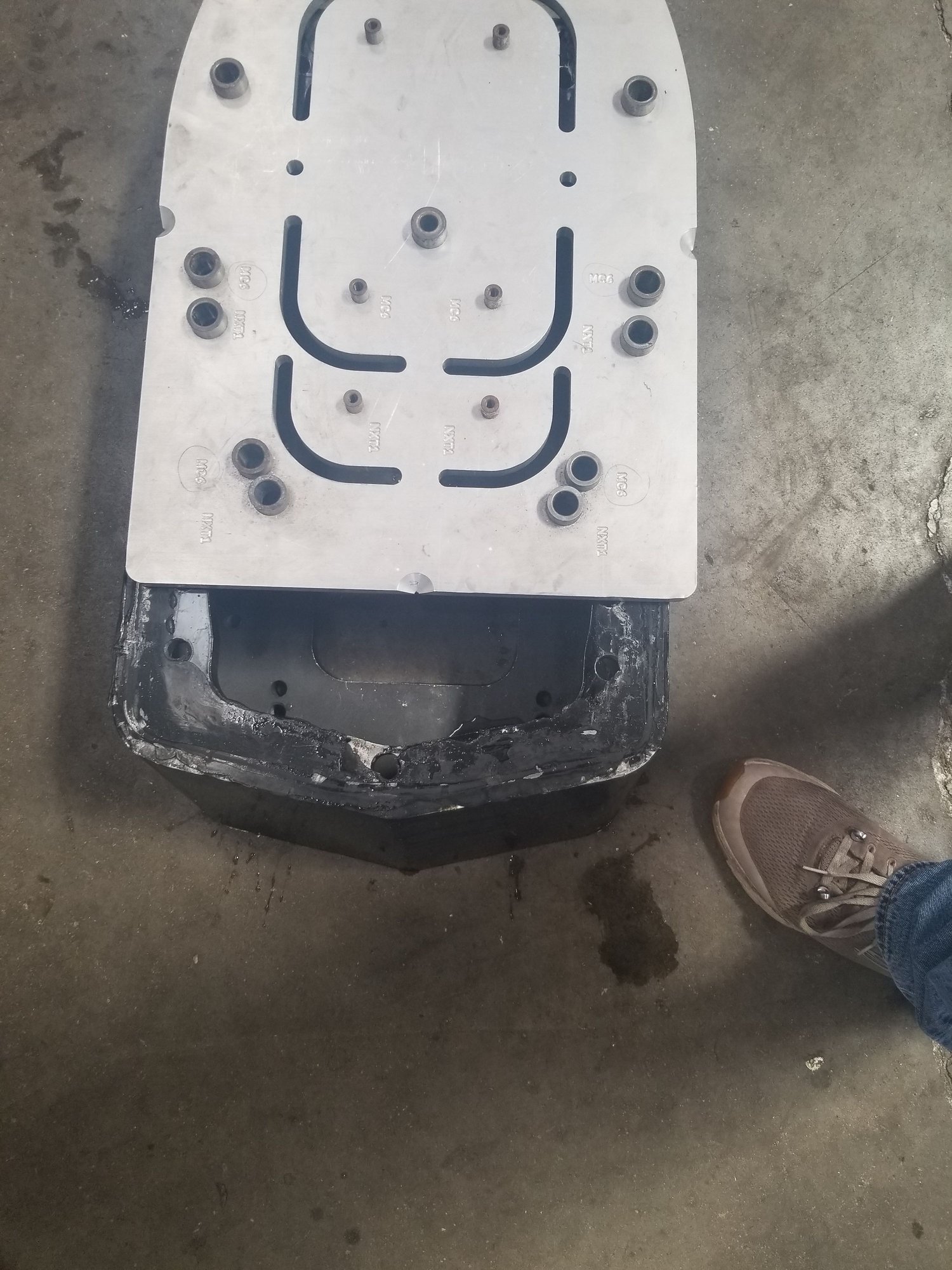

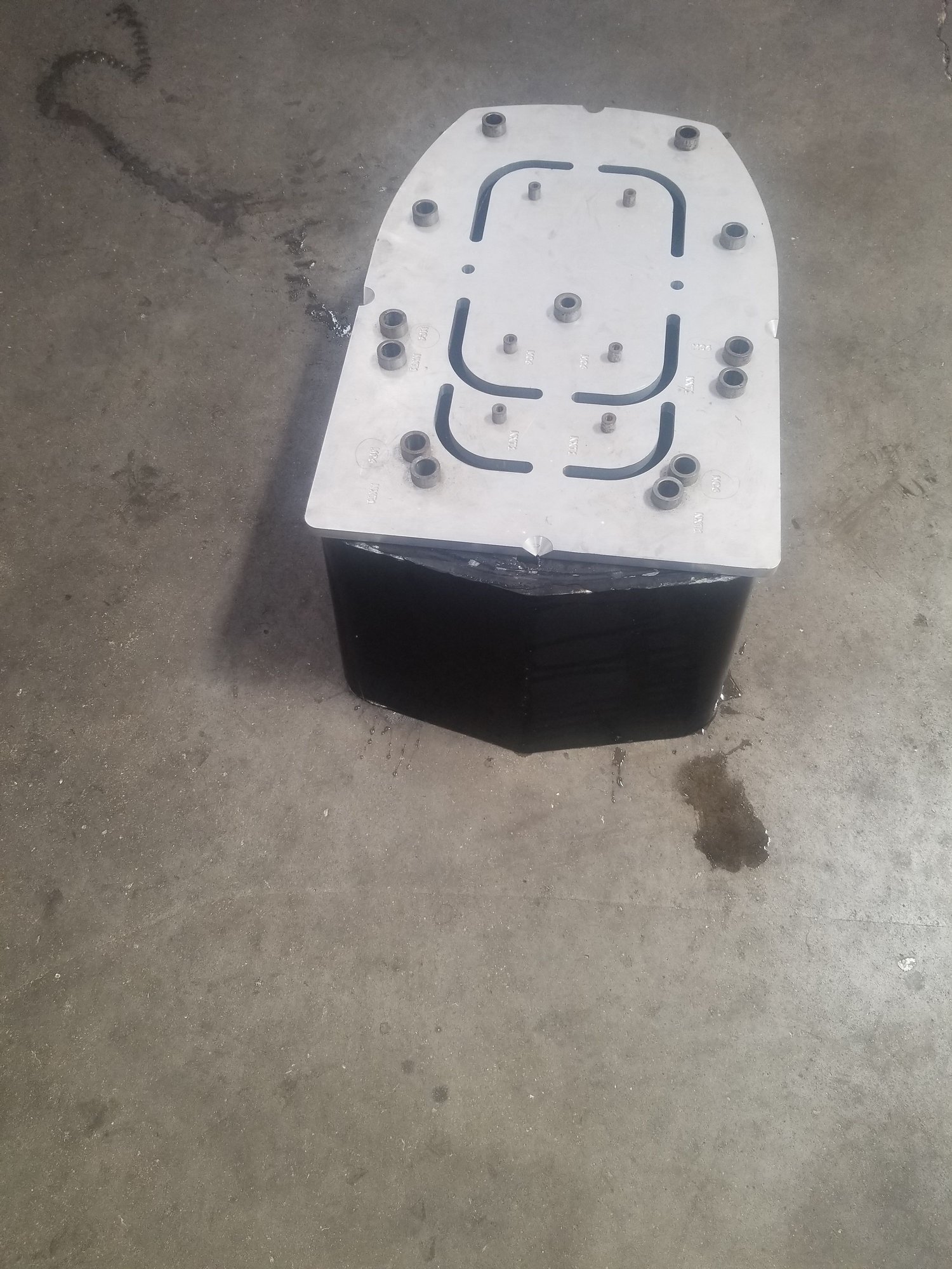

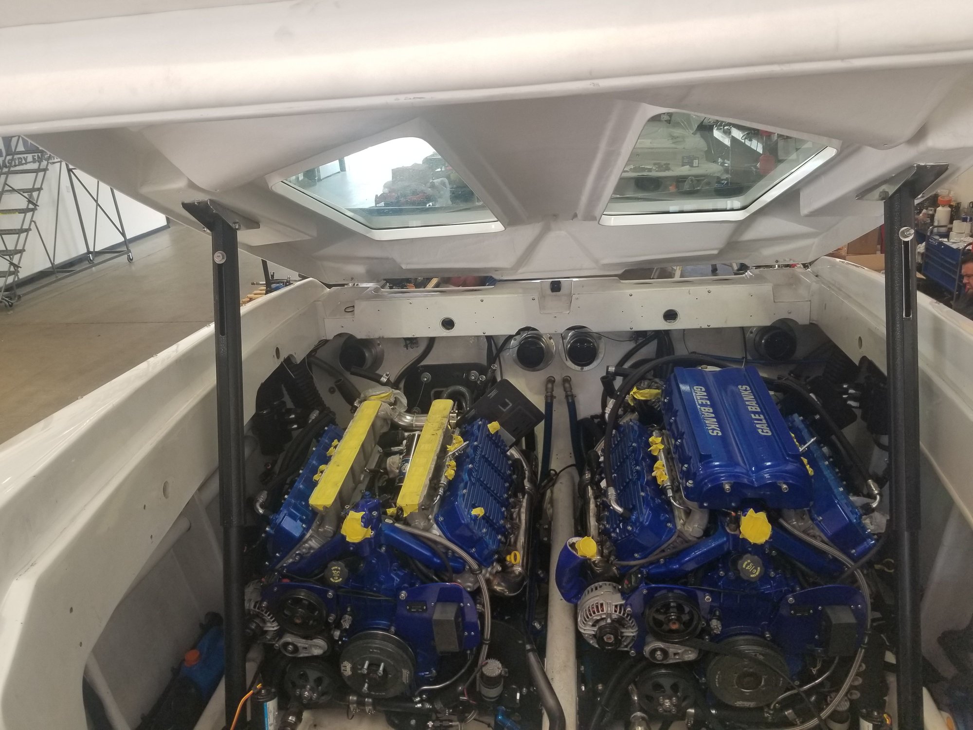

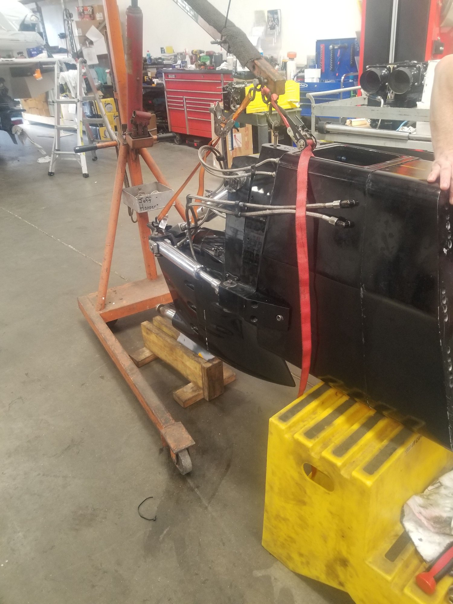

Took a few days off to take care of some other biz, and let the diesel pump gurus sort out why we had 2 failures so close together. Believe they have that sorted out now, so I moved to swapping the drives. Plan is figure out the extension box setup again. Try to start with the prop shafts as close to where they are running now. So yesterday we pulled Stbd unit off and split extension box from transom assembly to check the dimensions. As figured, the Wesimann transom assembly doesn't match up to #6 dimensions. So gotta start from scratch again.
Looking for a good pair of #6 extension boxes if anyone has some laying around. I have the patterns in CAD to make new end plates if need be, but would really save time just bolting some up.

No the transom has old 6 pattern factory.
