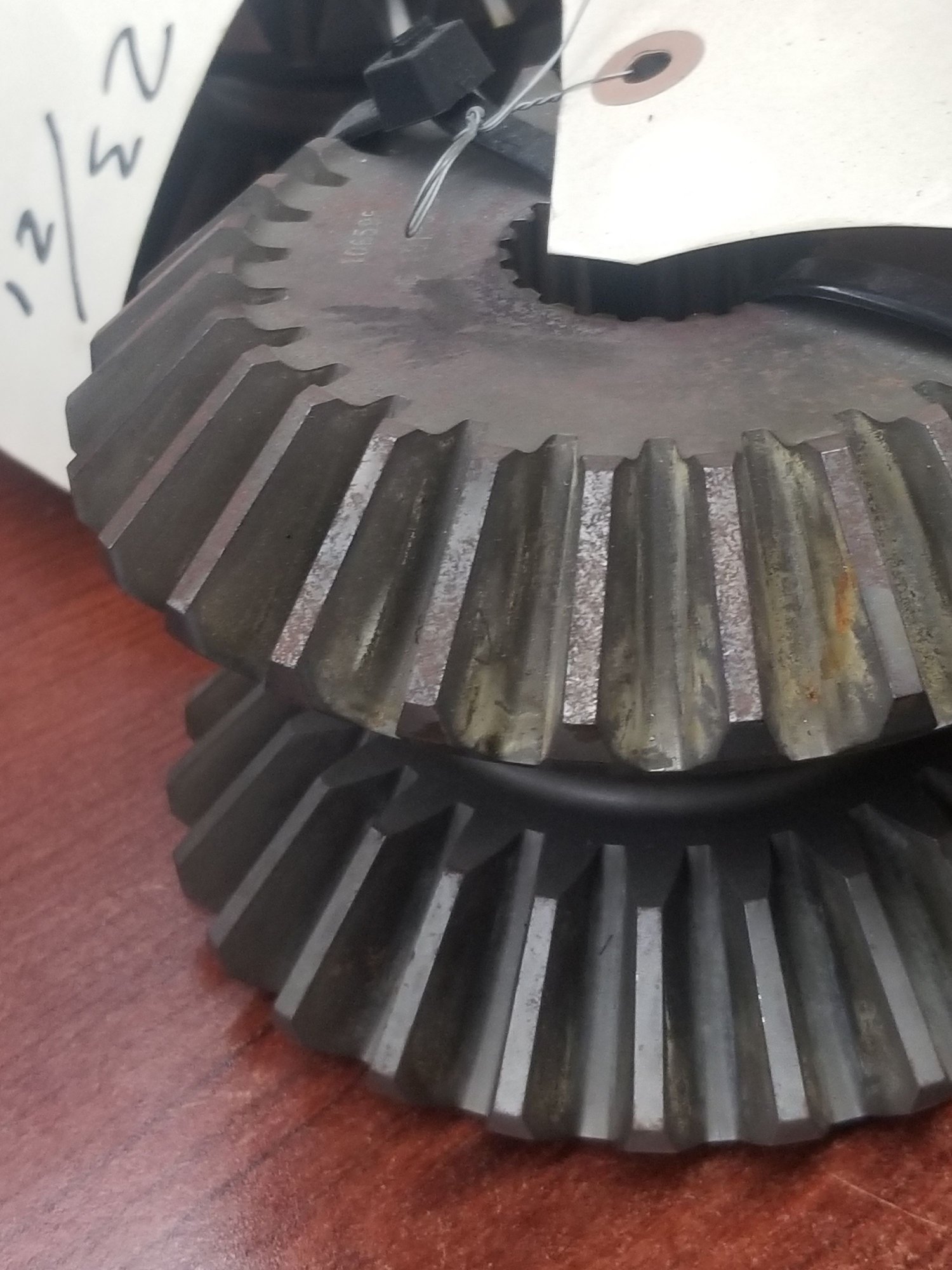

Thanks for reading all 31 pages. Ya could have probably skipped to page 30 and likely came to same conclusion. Drive options are the weakest link.
The rare M7 is great option. But from what I saw a couple months back, the #7 upper gearset wasn't designed for big torque. See pic.
While the only true 1:1 upper produced, the 27/28 teeth look pretty skinny compared to the 21/23 sets I picked up from an M8 couple pages back. So long as your not making over 1200lbft, I don't see a problem. Plus higher propshaft speed with lower pitch prop will likely work well to lower prop slip numbers.
As for engine choices, I was actually considering swapping a 6 leaker into the original Duramax Warlock boat a decade ago. Now after driving one for past year, the Ford 6.7L with reverse flow heads is my next target. No exhaust manifolds to make or marinize is very attractive.
Good luck with the build and feel free to ask if you need any input.

Thanks for the reply.
You make some great points and suggestions.
Was considering the 6.0 because it is cheap and readily available. But by the time you add in a set of water jacketed exhaust manifolds $3.5-4k and bell housing adapter $1k, the 6.7 is looking more favorable..
The 6.7 has a SAE 2 bell housing pattern and like you said center exhaust. These 2 features greatly simplify the install.
Now need to find a tuner and make the ecu standalone.
Only need about 3500-3700 rpm and 900-1000tq max.
Boat previously ran 100mph with 750hp/tq supercharged 502efi.
So just need a SAE 2 or 3 bell housing to trans and #6 gimble for the M7 drive.
