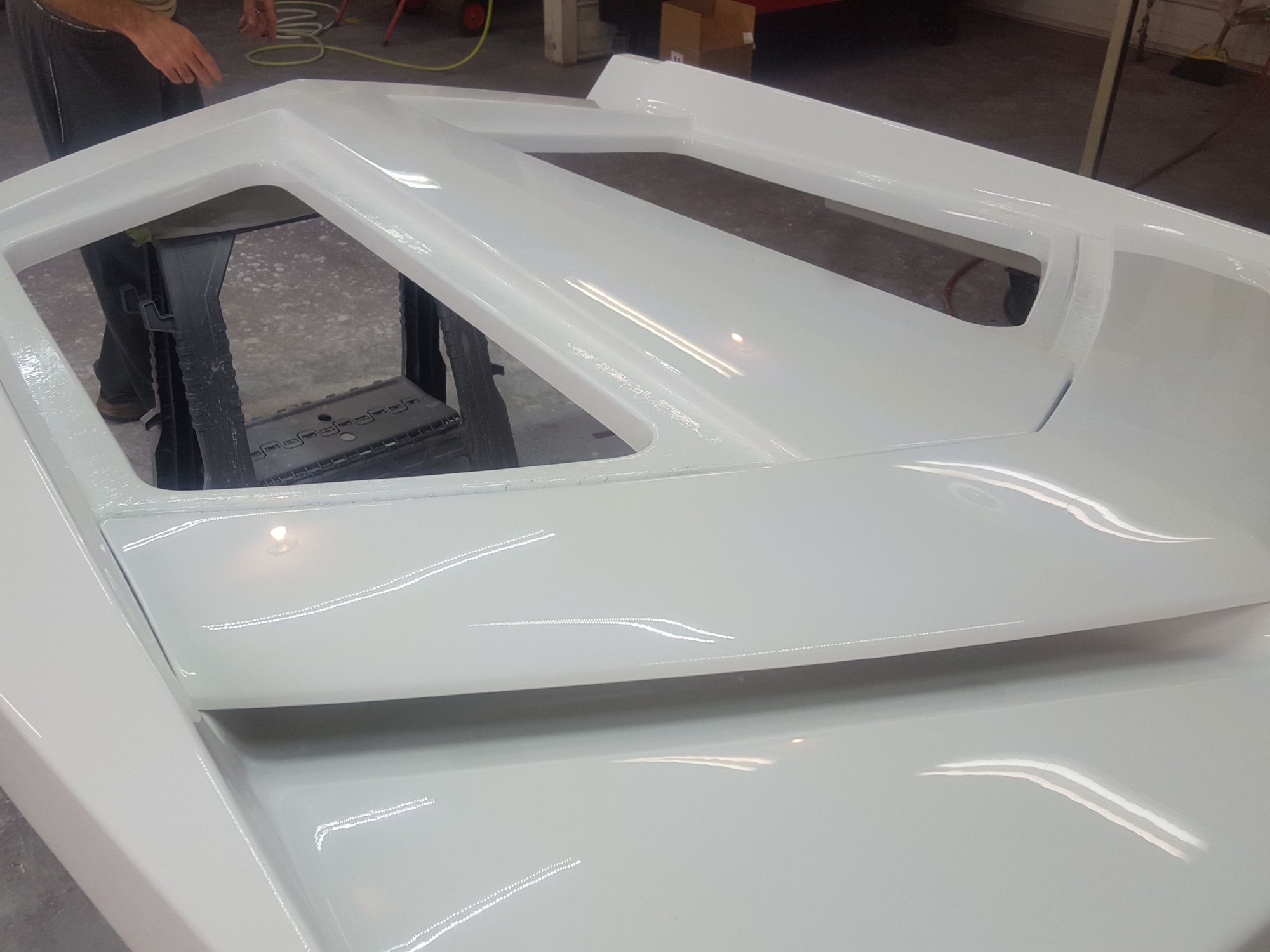

Also have the engine hatch wet sanded and buffed out. Turned out great. Still need to paint the wing, soon as I go help move the hatch. As for those glass panels, replacing with a 3/4" thick, lightly tinted, optix acrylic.

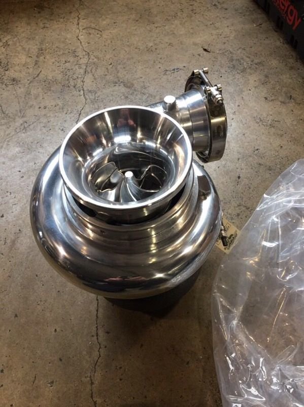

New turbos are here. Love the adjustable MAP ring. Now to rework the up-pipes and intake tubes to fit.
NLX S476/87 SS V-band 1.0AR

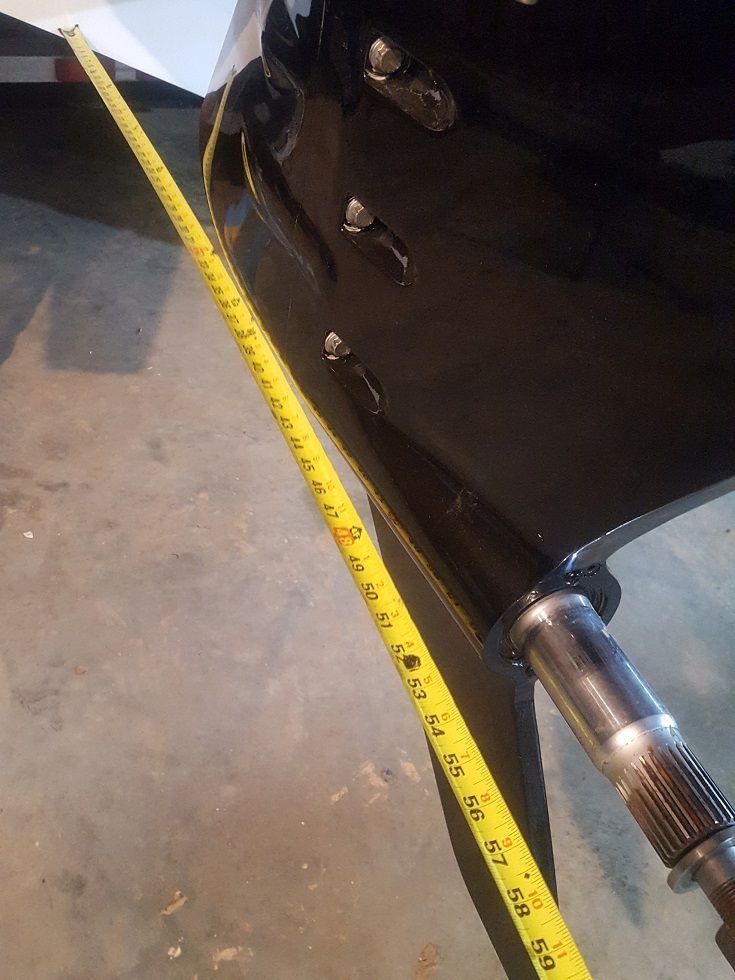

Would love some input from other 40OL owners as to actual performance. I done pumped a fresh tube of silicone sticking those 280's back on, so guess we'll see how they do. But with our props setting 54" off the transom, doubt those little 280's will make much difference. Once Dave gets it's home, he can upgrade em if operating on Sydney harbor calls for it.
