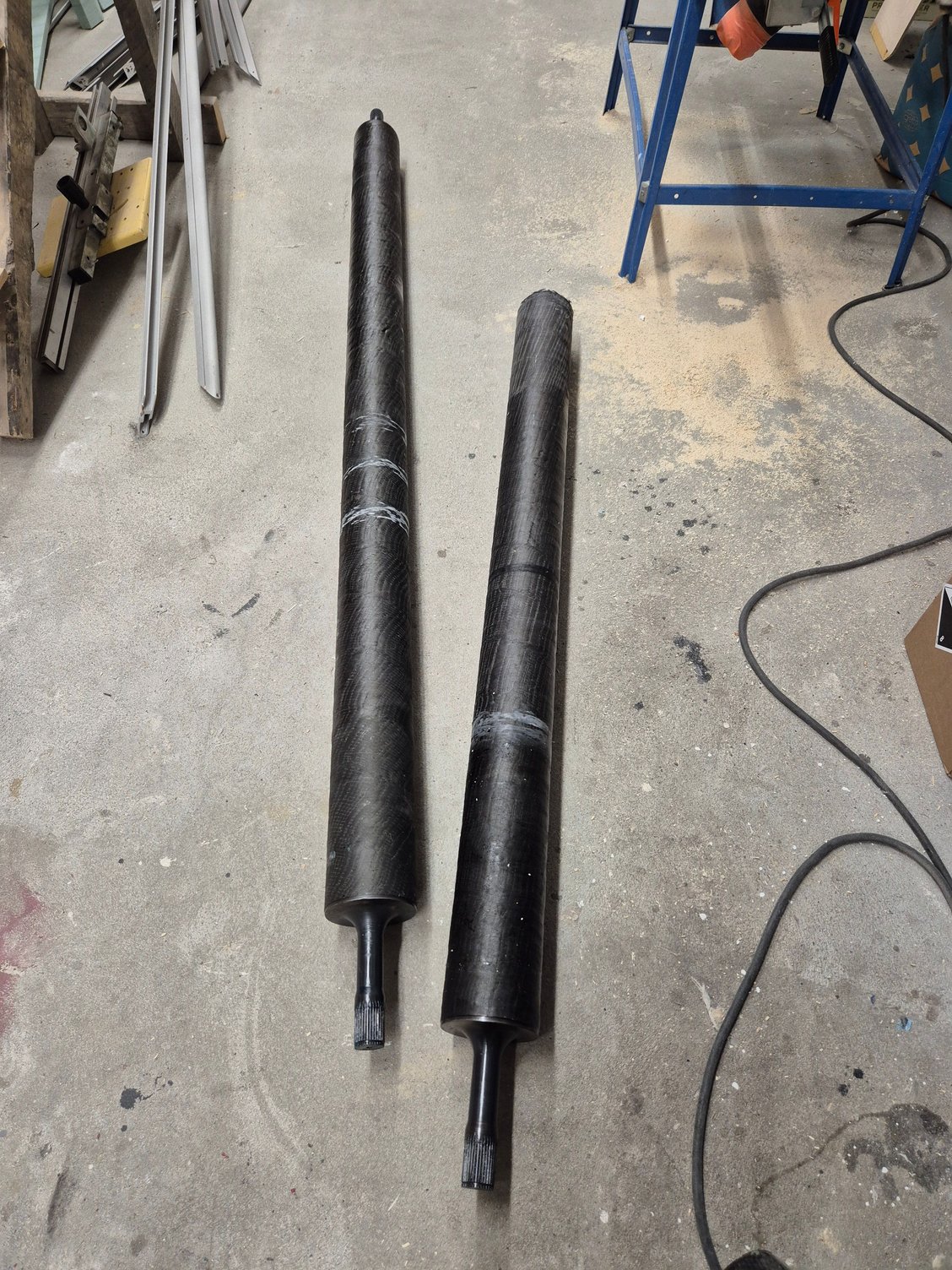

Driveshafts are out, end pieces have to re-use
https://cimg6.ibsrv.net/gimg/www.off...d898bcdc0c.jpg

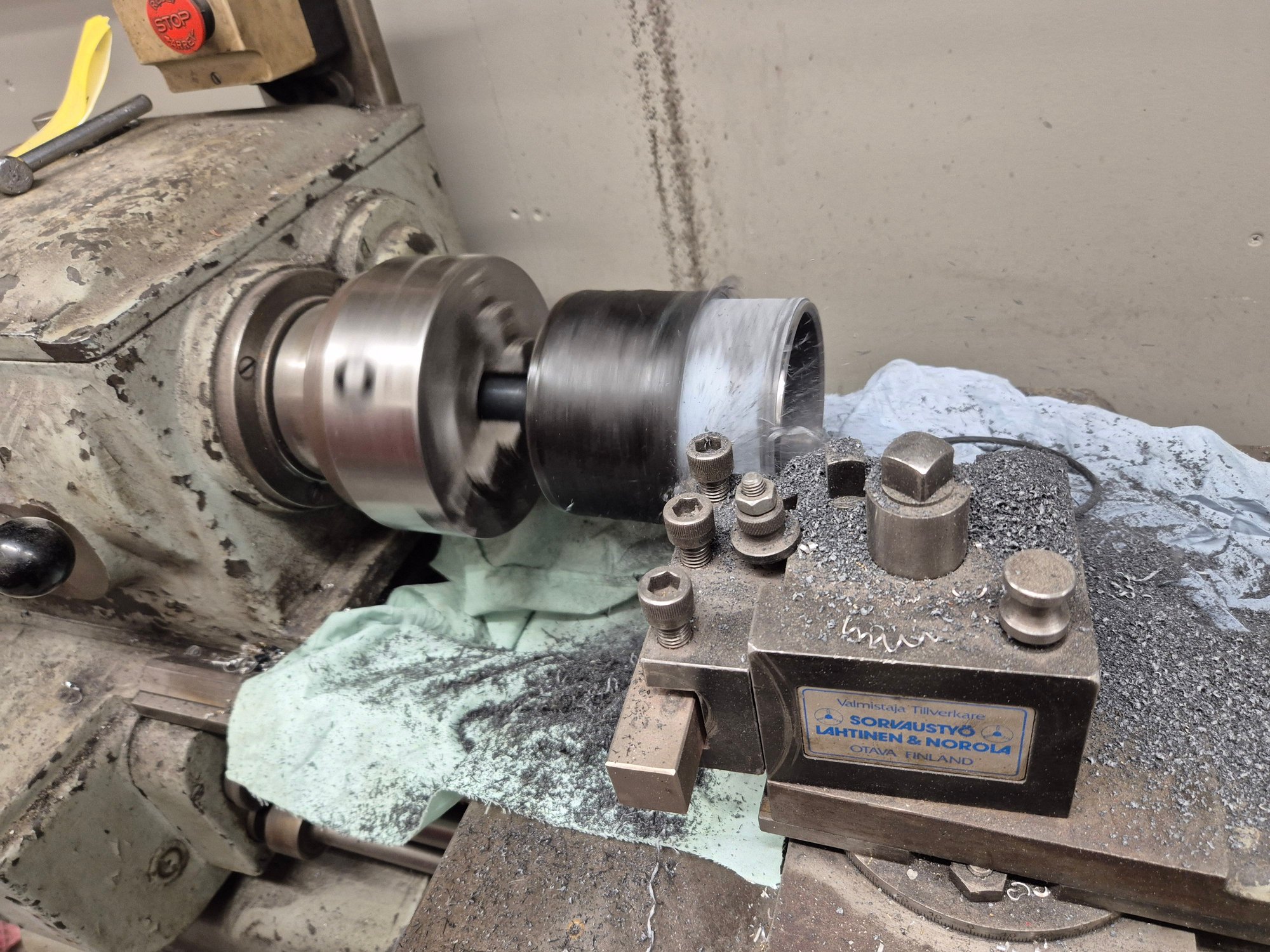

Exodus to lathe when turning carbon fiber,dust go everywhere. Luckily my -60's swedish garage lathe don't care.

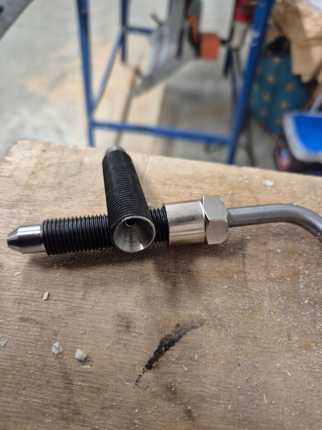

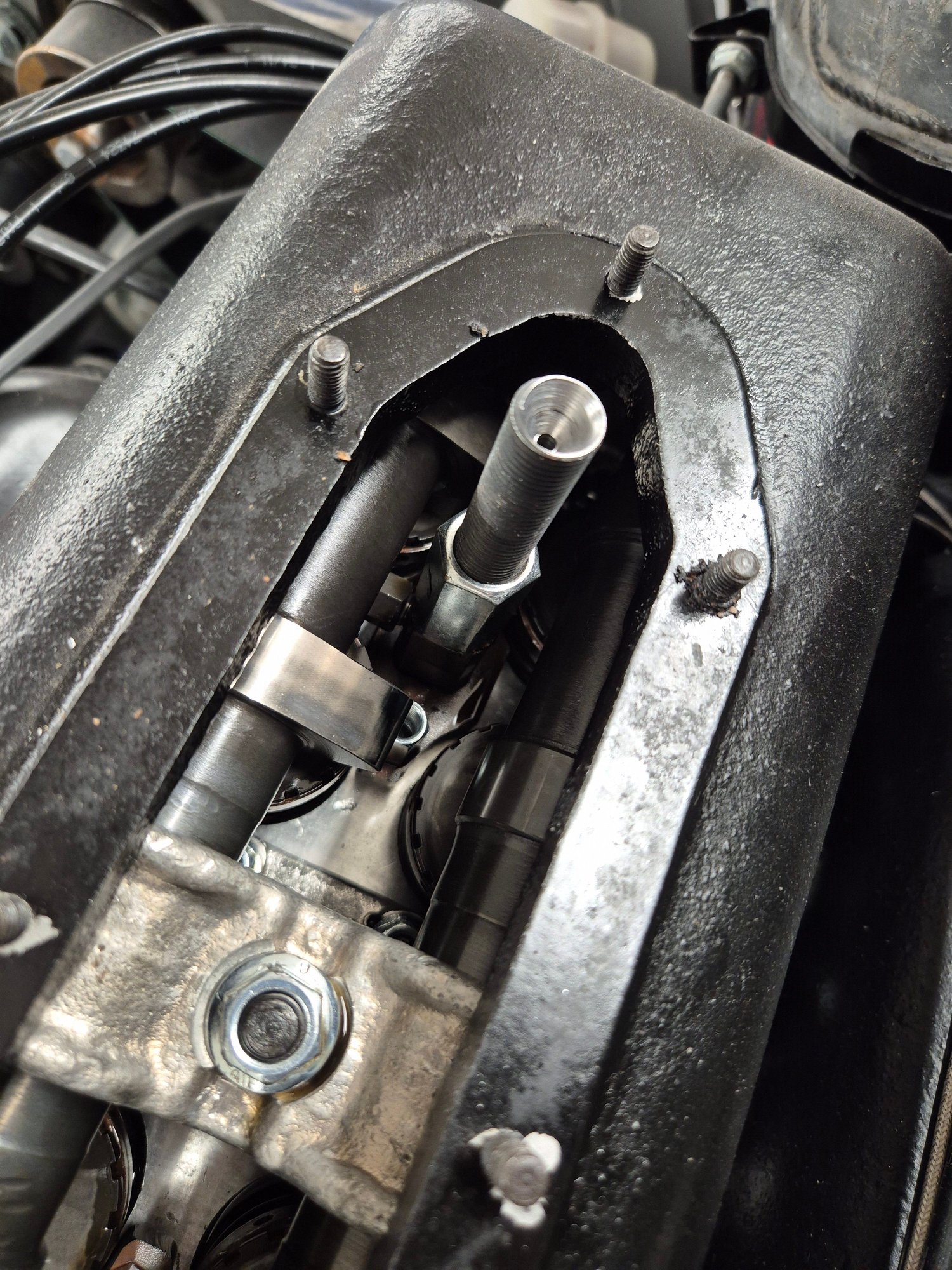

New injection lines, I had to make injector extensions so normal end tubes can be used, last ones had long hollow bolt end to fix tube to injector. Now extensions allow use normal M14 ends in both ends.

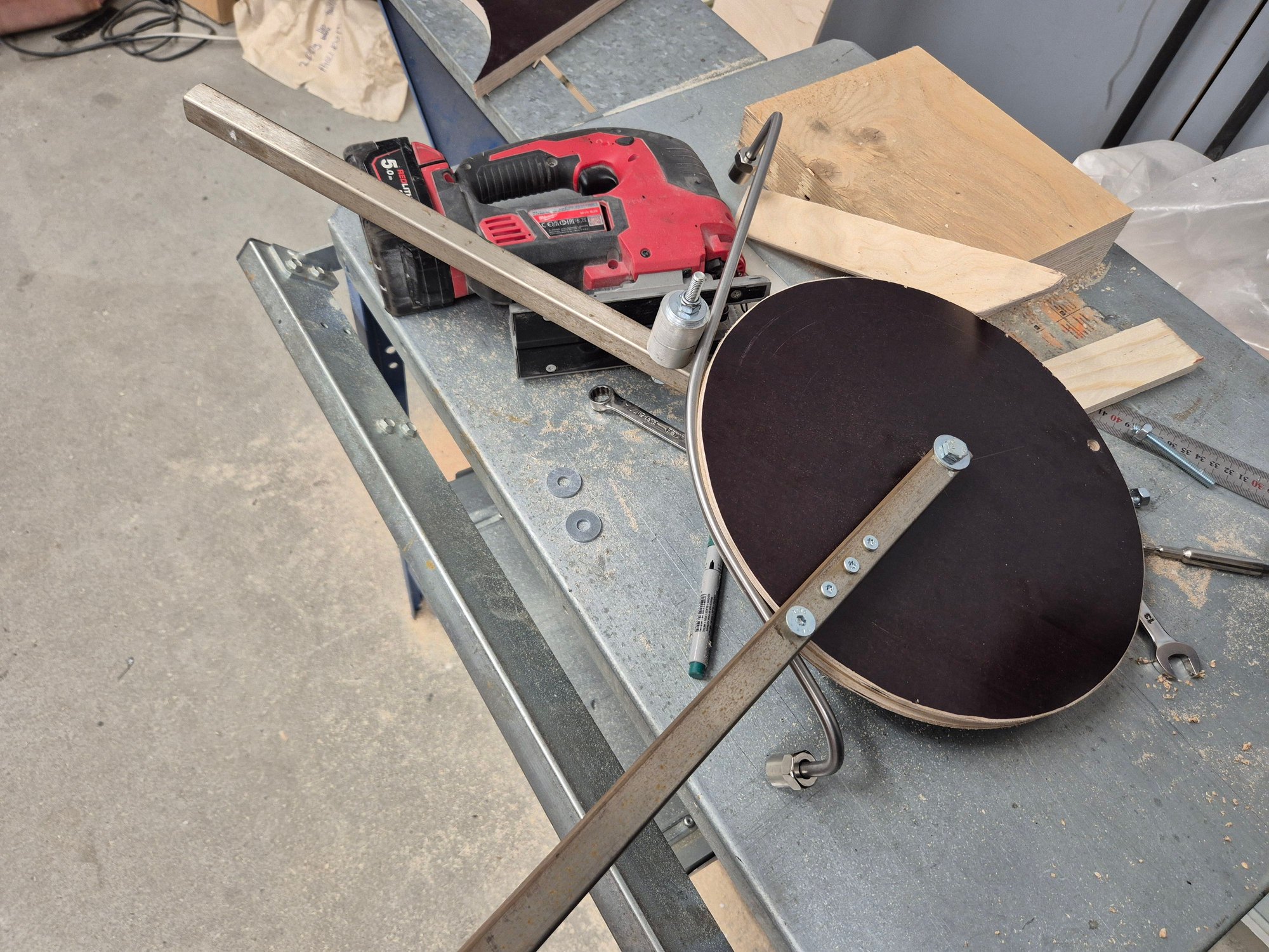

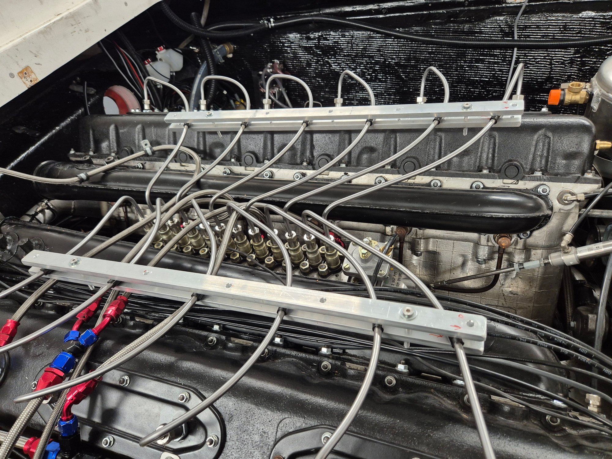

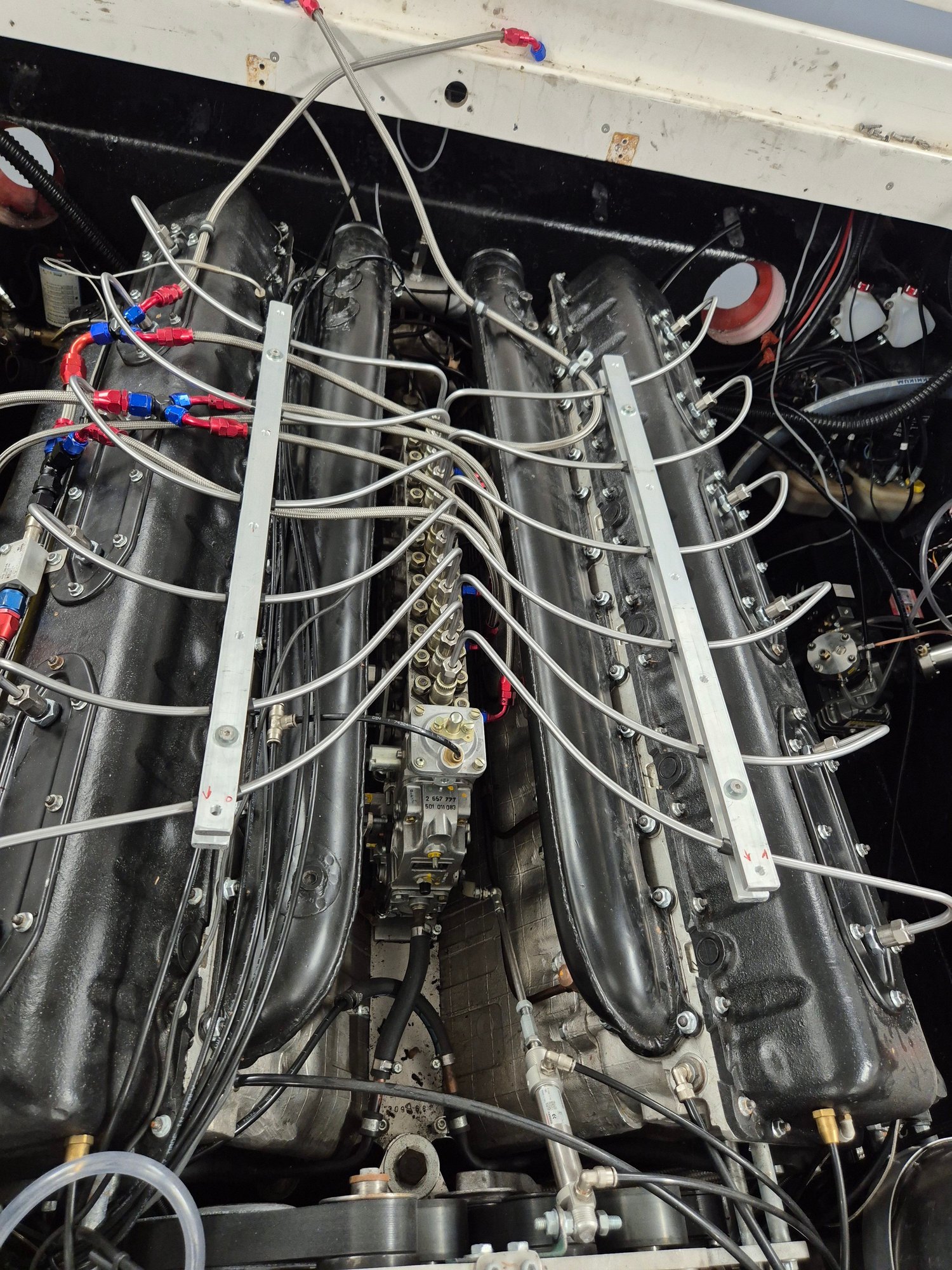

Special big radius bending tool from plywood, it works way better than looks....
https://cimg5.ibsrv.net/gimg/www.off...3c269ae548.jpg
https://cimg8.ibsrv.net/gimg/www.off...909f3e2b87.jpg
Lines are ready, heavy 10x25mm solid flat aluminium bars fix lines together and prevent vibration and line cracking.

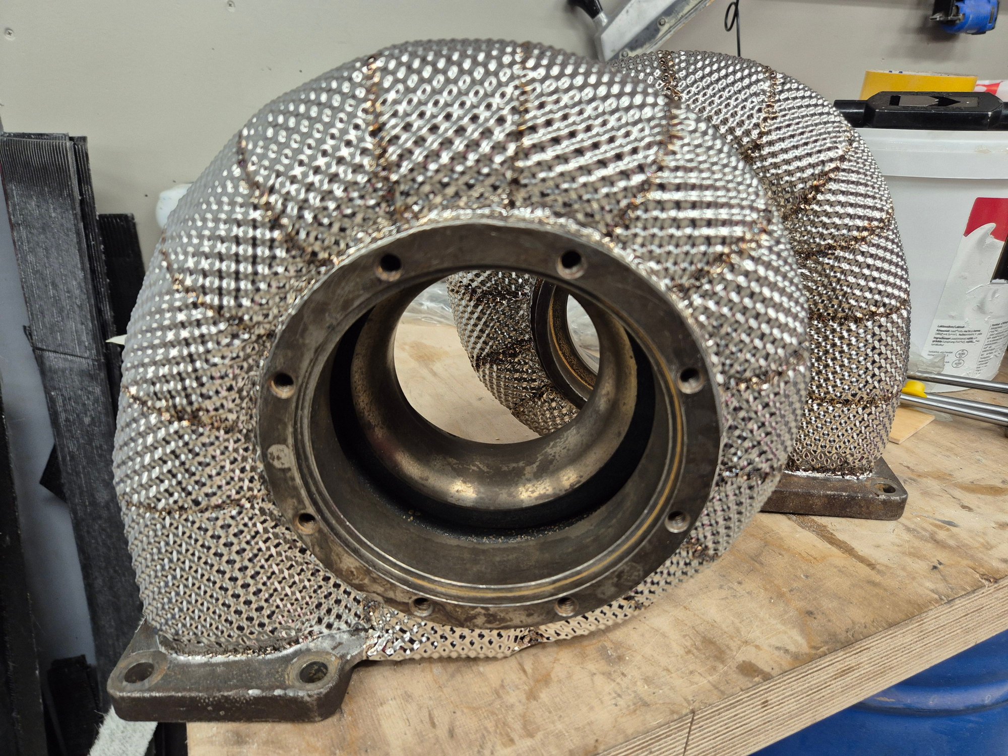

Turbine housing heat shielded, KKD motorsport make very nice job!!! If you need insulating somewhere, I recommend Kalle, he are professional. KKD have parts,turbos and soon light stainless V band turbine housings, they will be very good for marine use.

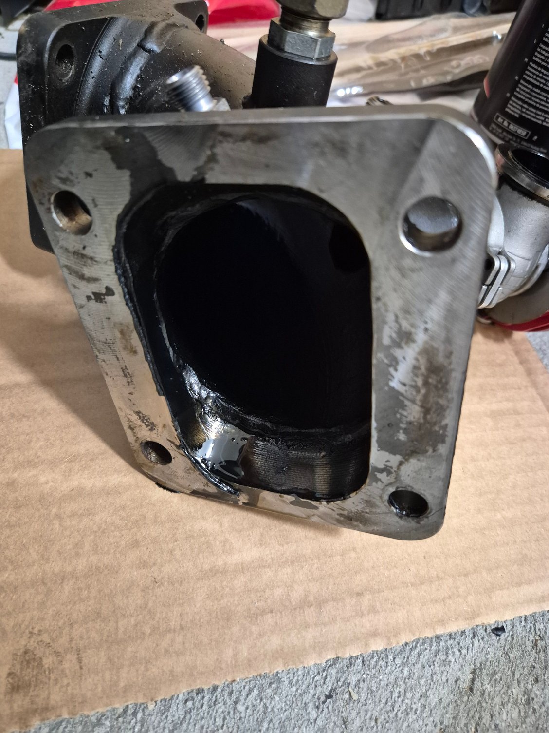

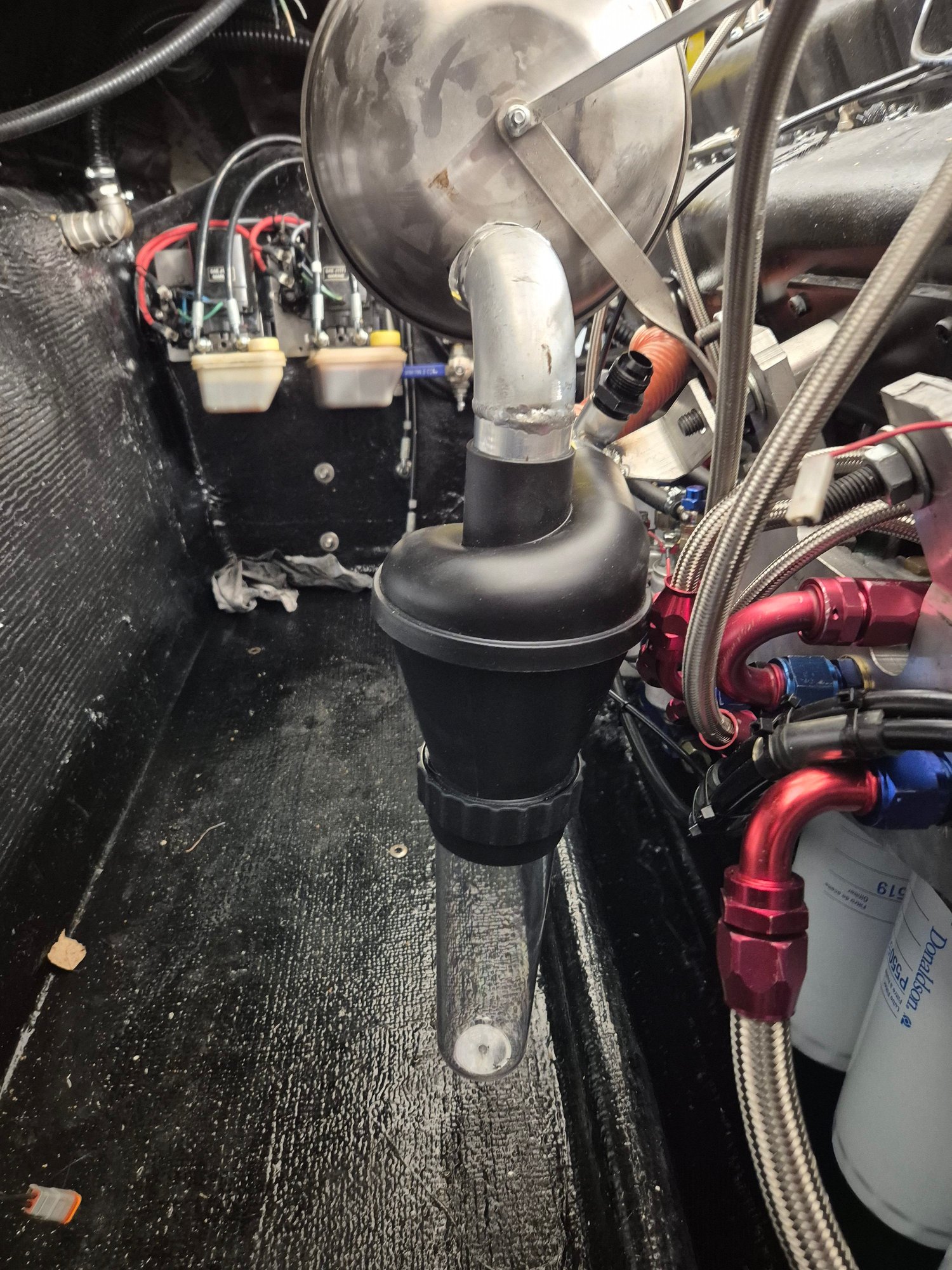

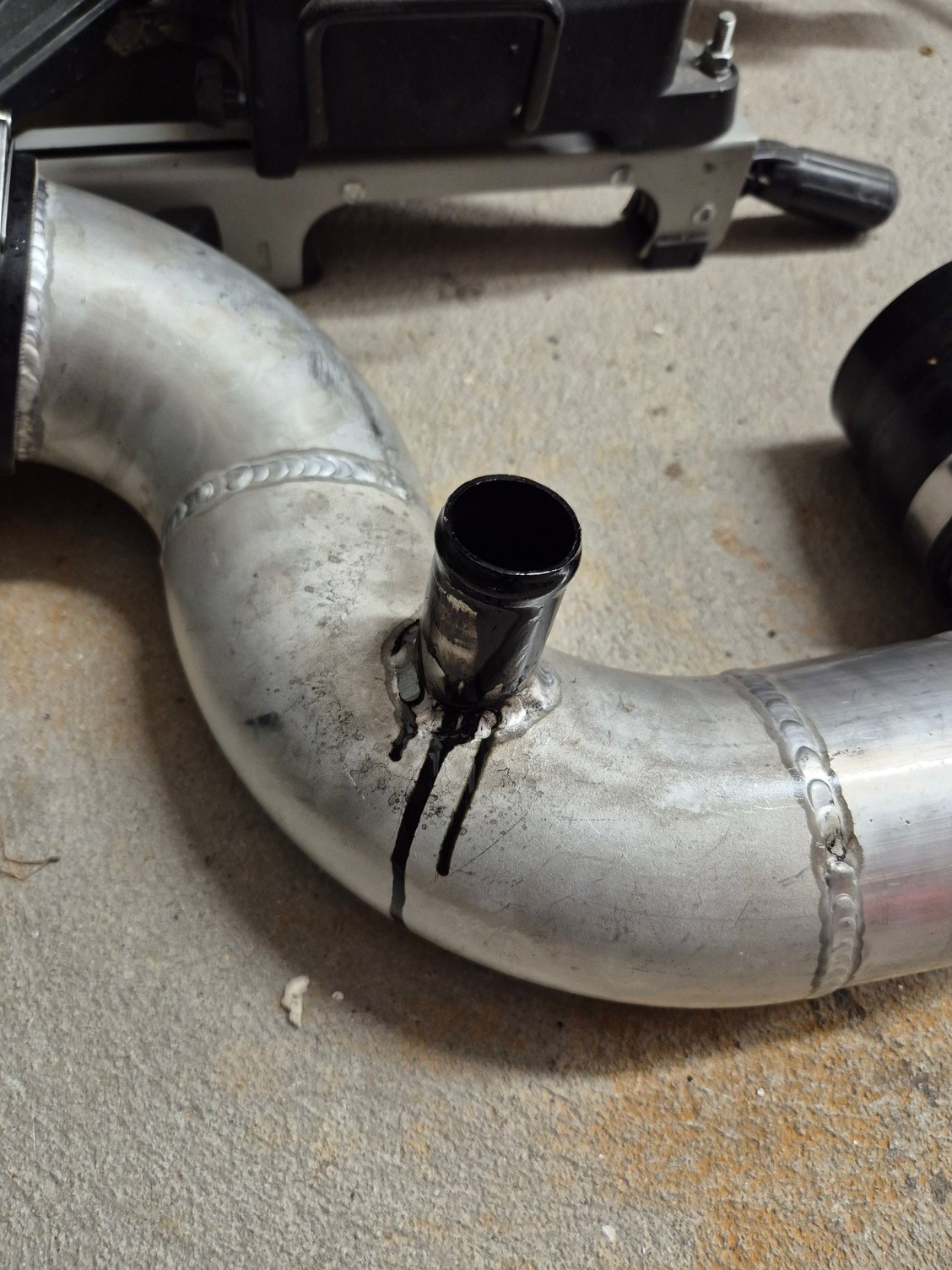

Last summer smoky running was due to leaking turbos, they leak oil to compressor and turbine side. Breather was way too small after I remove crankcase vacuum pump because it seized. I really want this massive diesel running without any smoke like nowadays engines.
https://cimg9.ibsrv.net/gimg/www.off...62e96c5ca4.jpg
https://cimg7.ibsrv.net/gimg/www.off...2ae37b8e0f.jpg
Solution is bigger breather, I found very nice vacuum cleaner cyclone with see through tank. Now it serve as oil mist separator and puke tank, clear part is easy to remove and empty. hose size is 50mm, it should be more than enough but 2372cid engine will blow through like 1.6l toyota from exhaust pipe at full tilt.

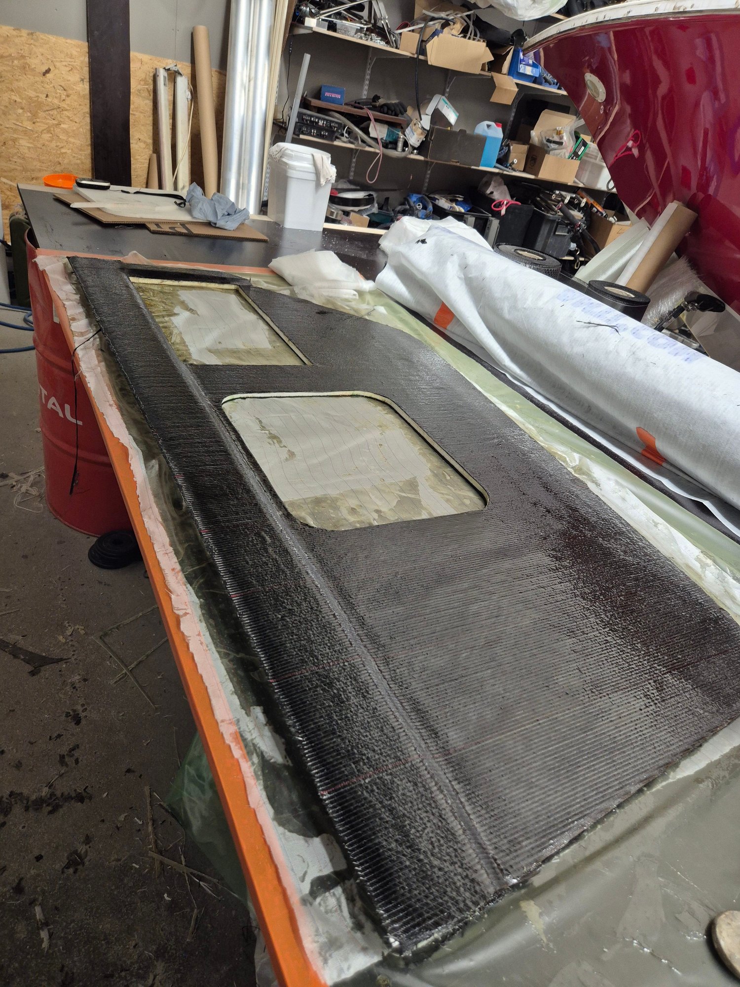

Interior parts are made from carbon fiber and Airex core foam, very light and stiff. Who else have carbon fiber kitchen and dinner table:cool-smiley-011:

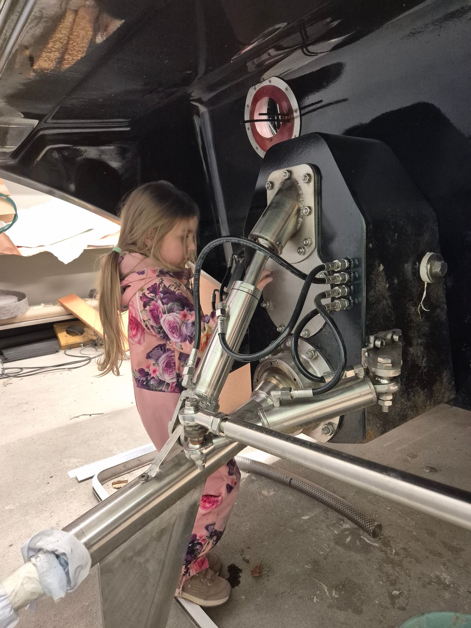

By the way, I have full time employee now, 4 year old can disassemble surface drives easily.
