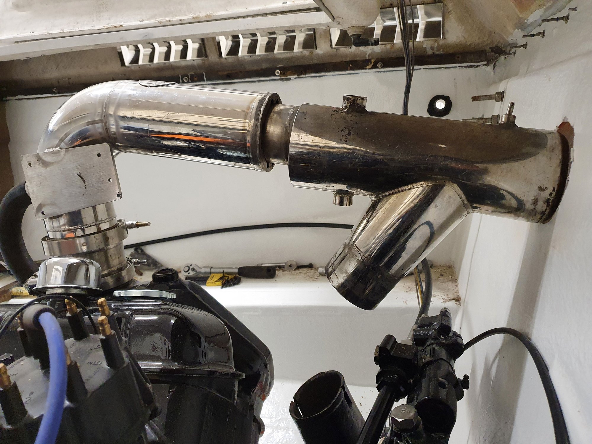

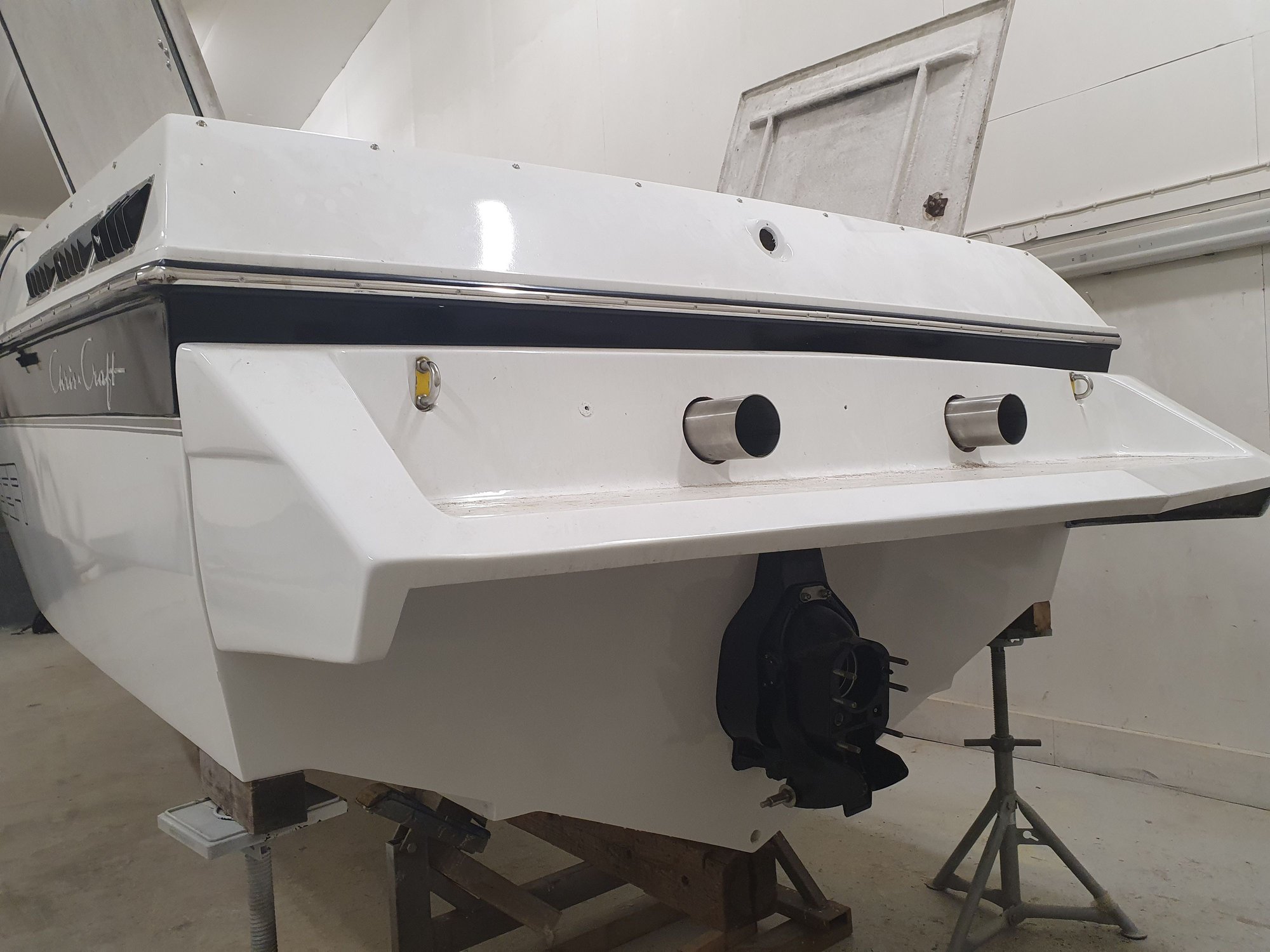

Should i forget the diverters 😜😜 and go with cmi sound eliminators only.

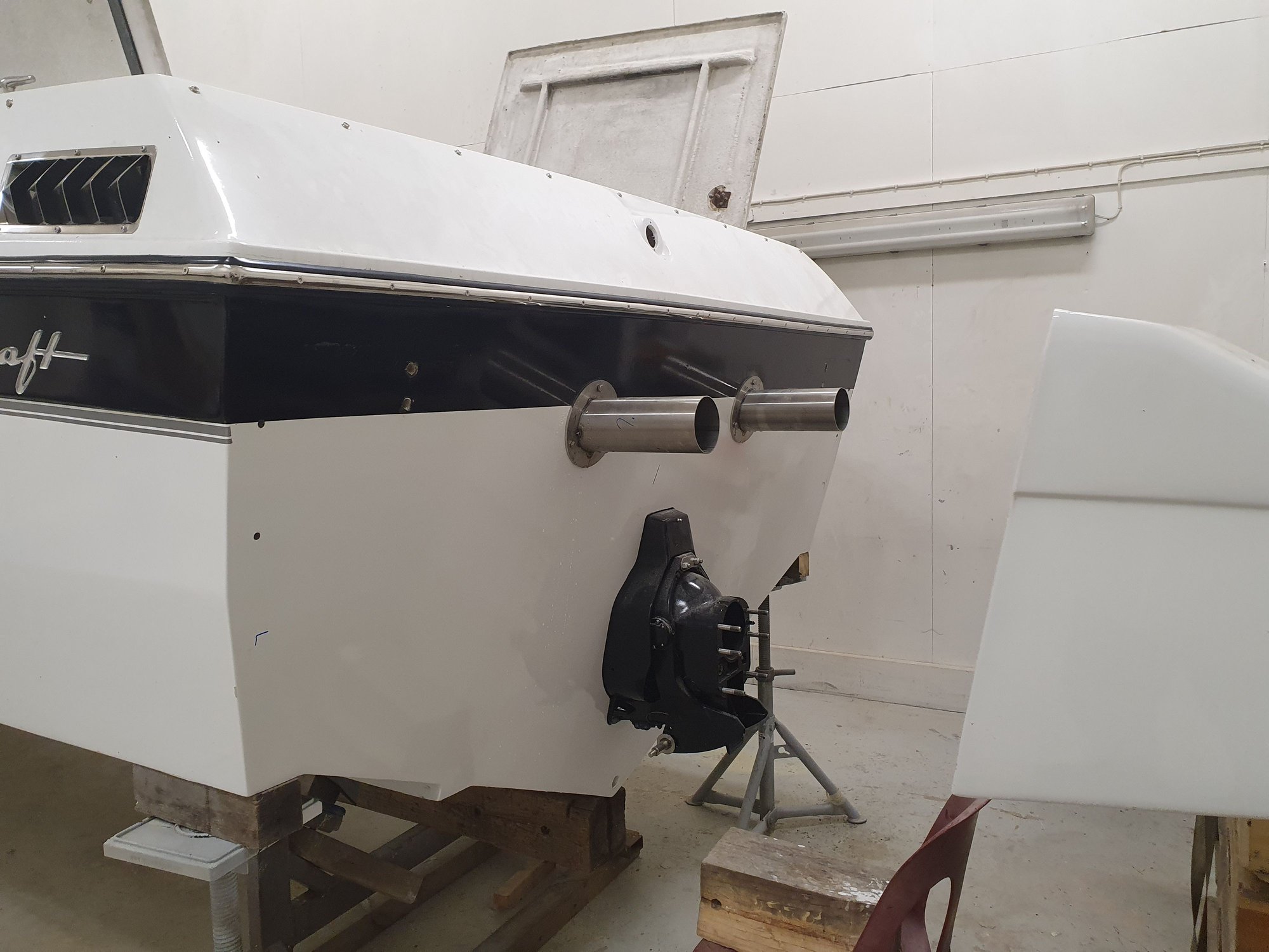

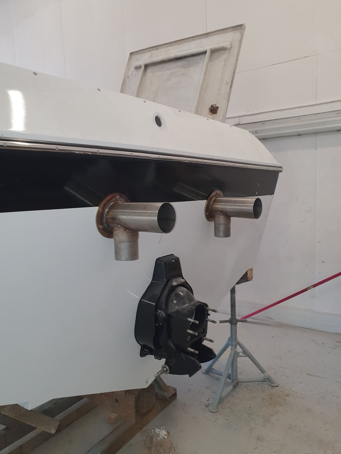

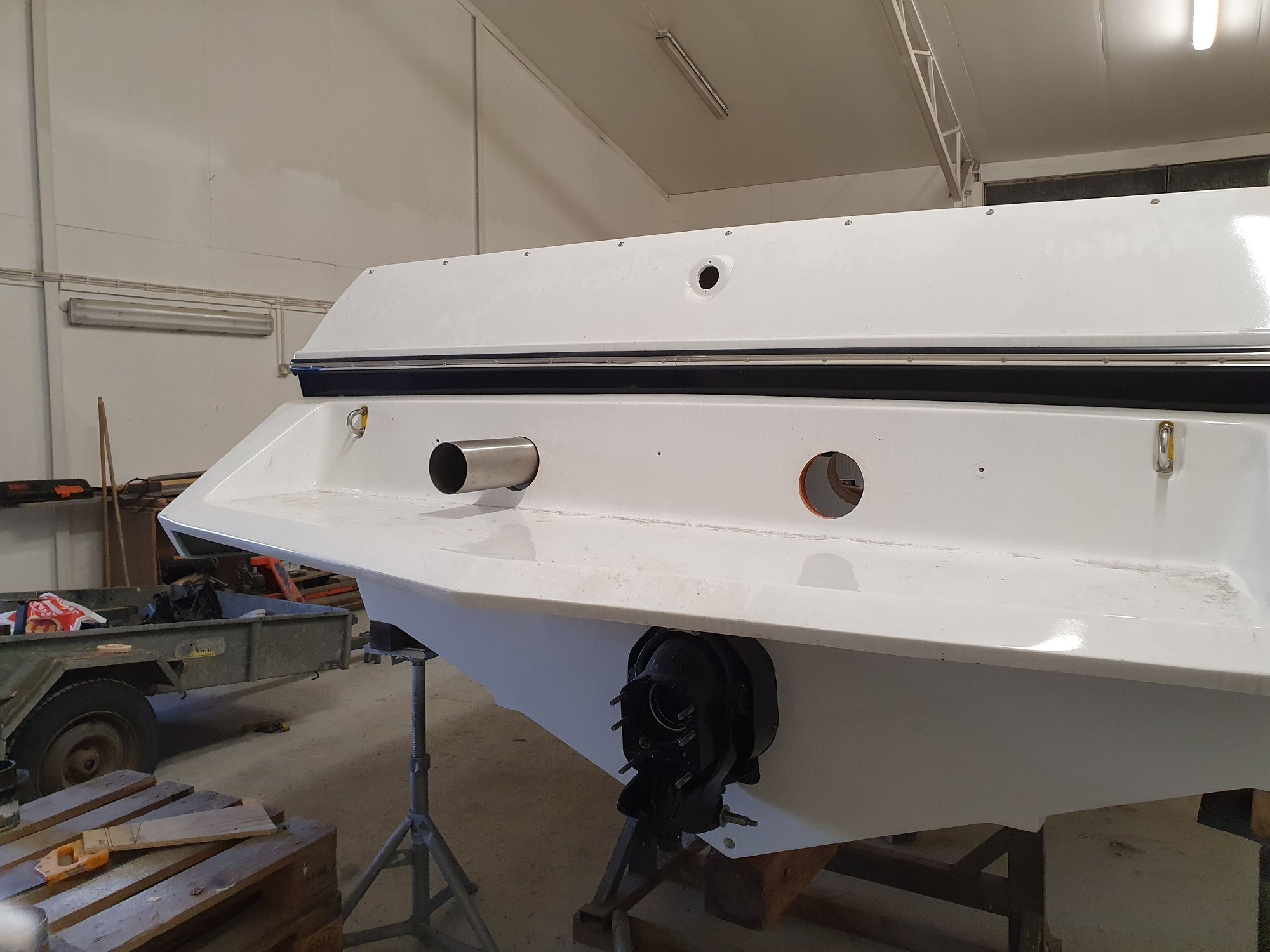

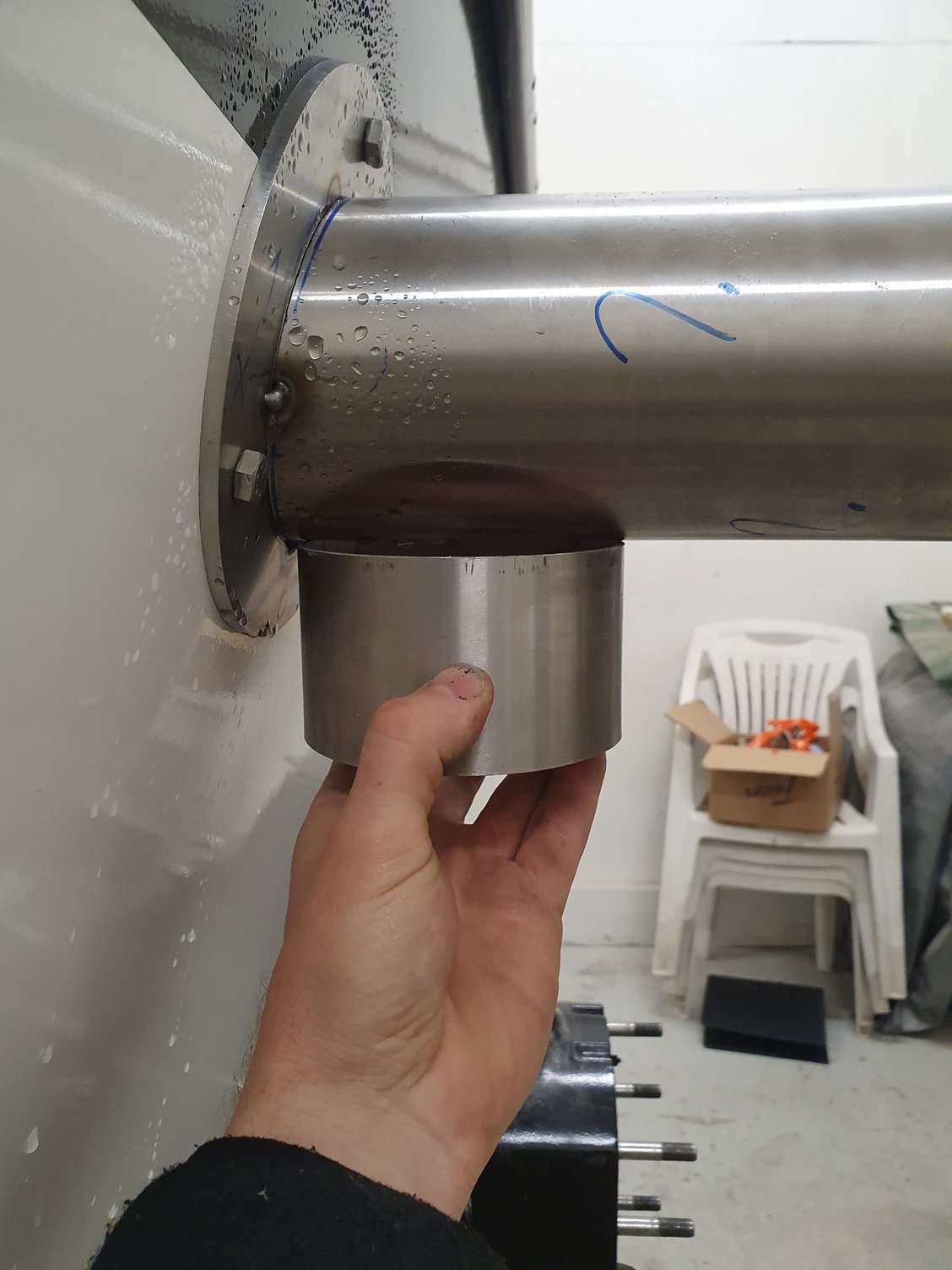

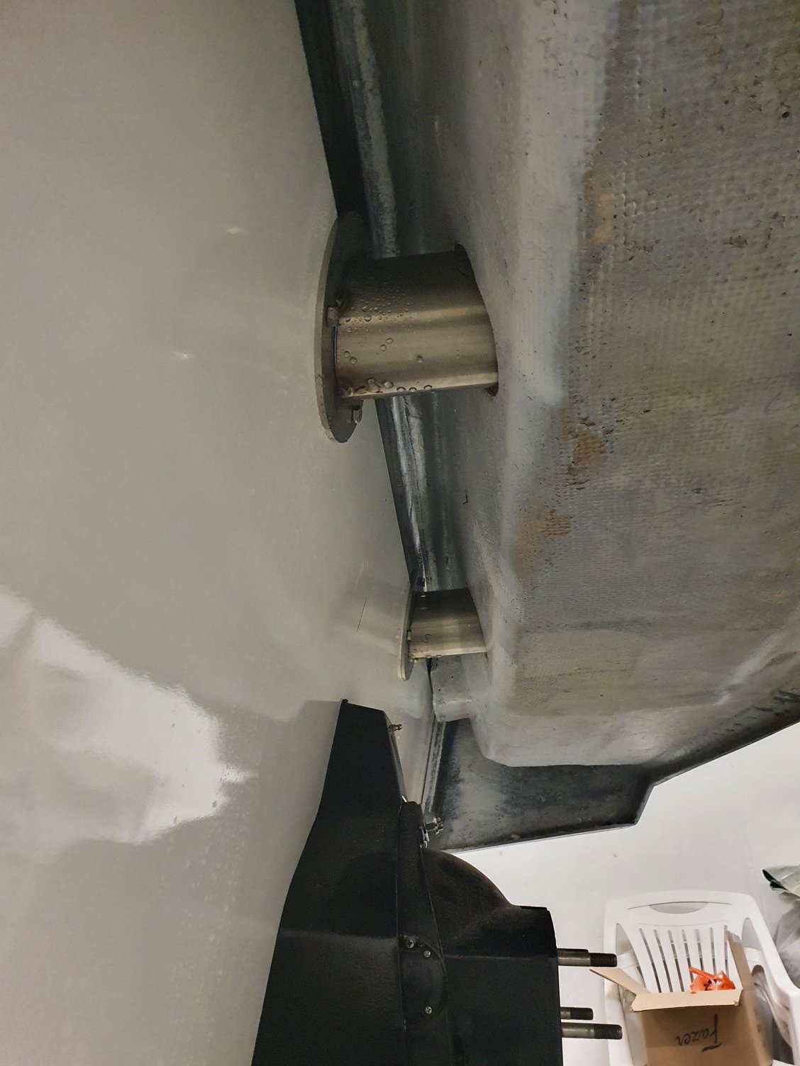

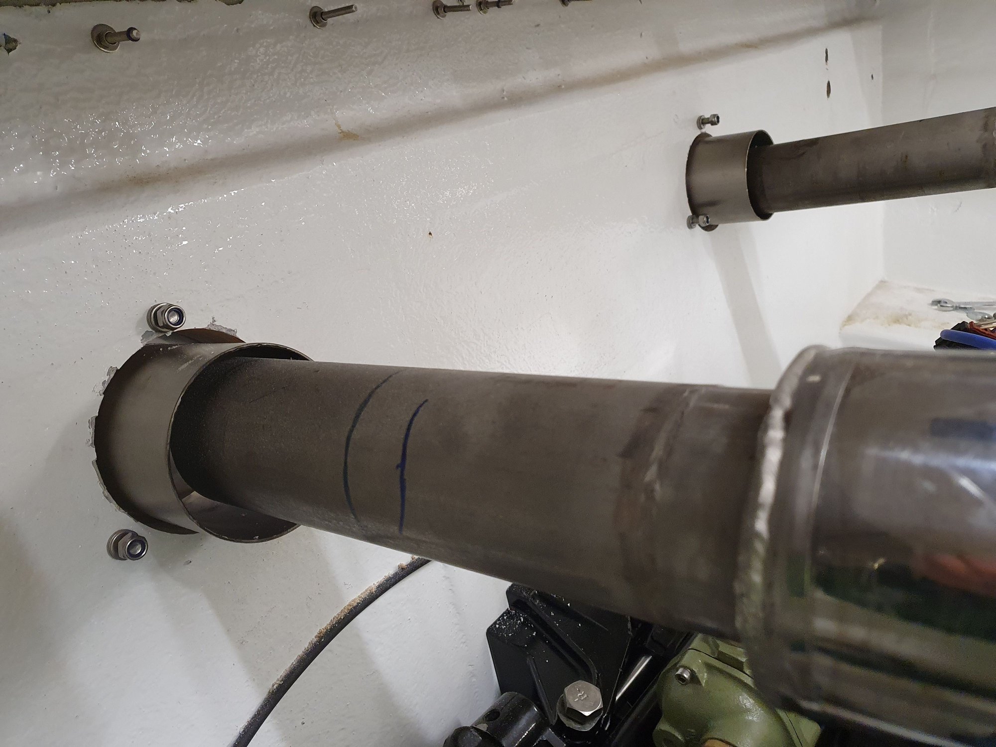

Dry to transom.
going to make down turn between the swim platform and transom, and modify the sound eliminator mufflers to be blocked when i want.

Originally Posted by PA.WOODCHUCK
Sometimes it's nice to have quiet, that said any room for silencers?
Going with CMI sound eliminators above the swim platform.

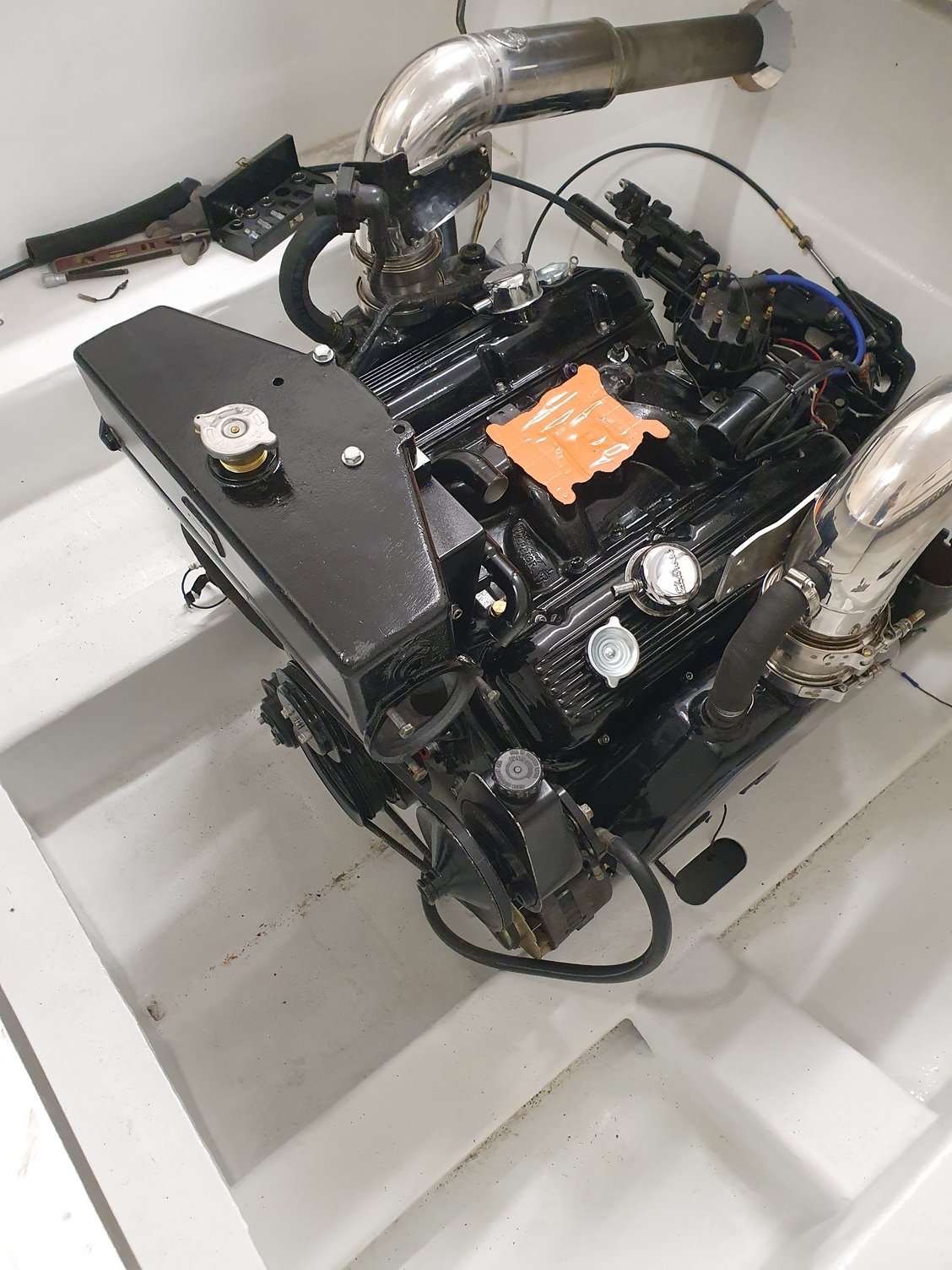

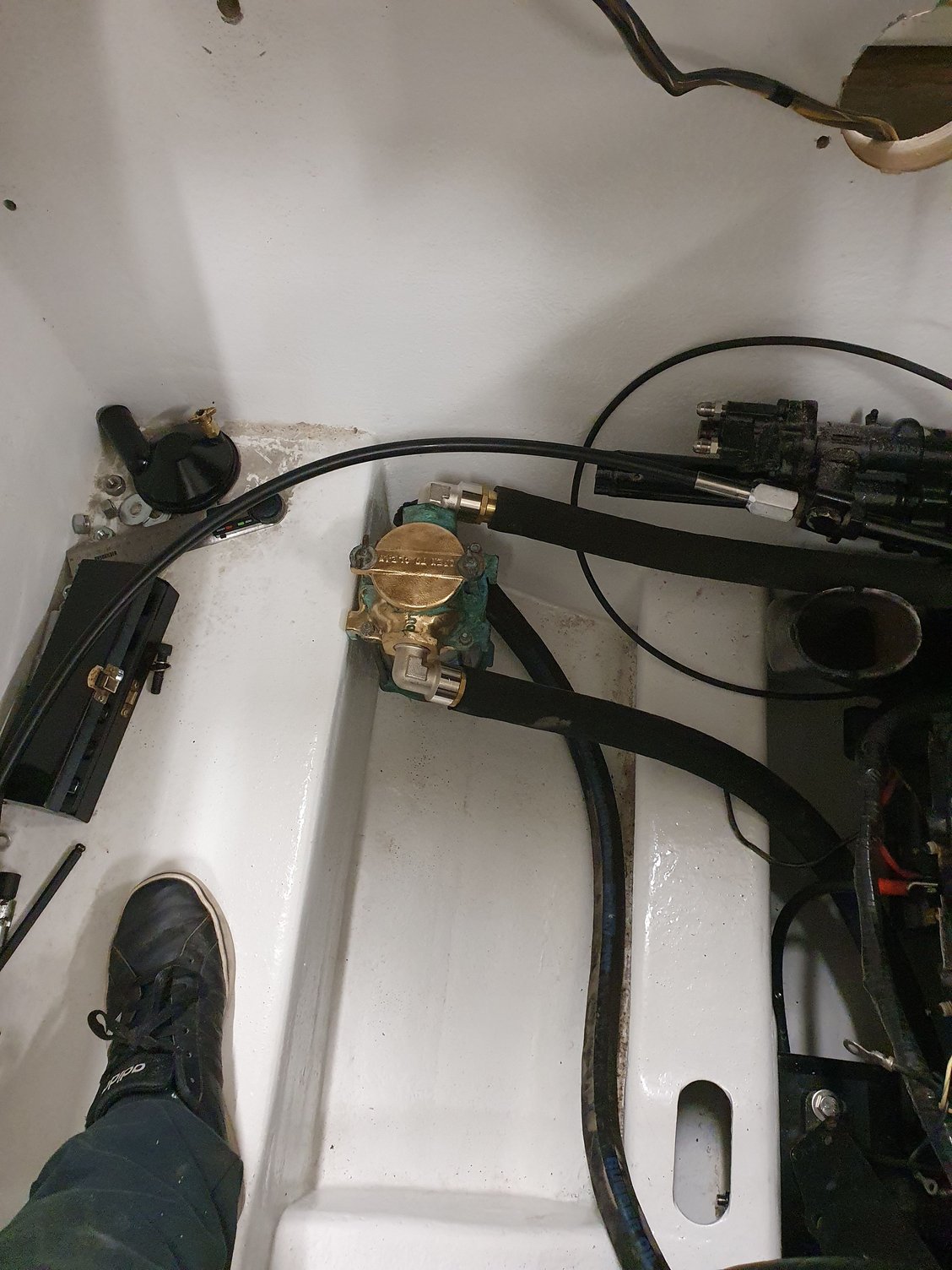

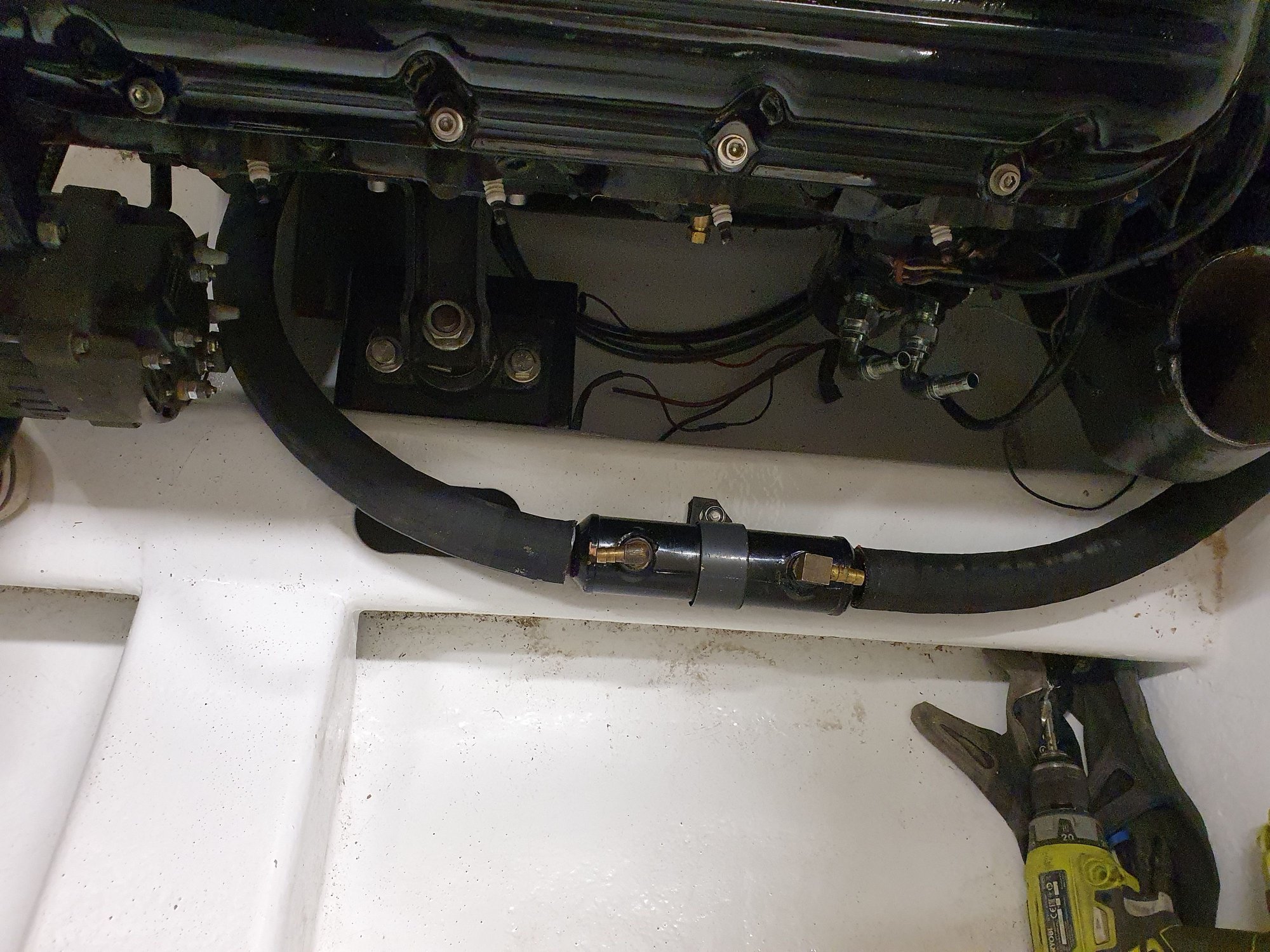

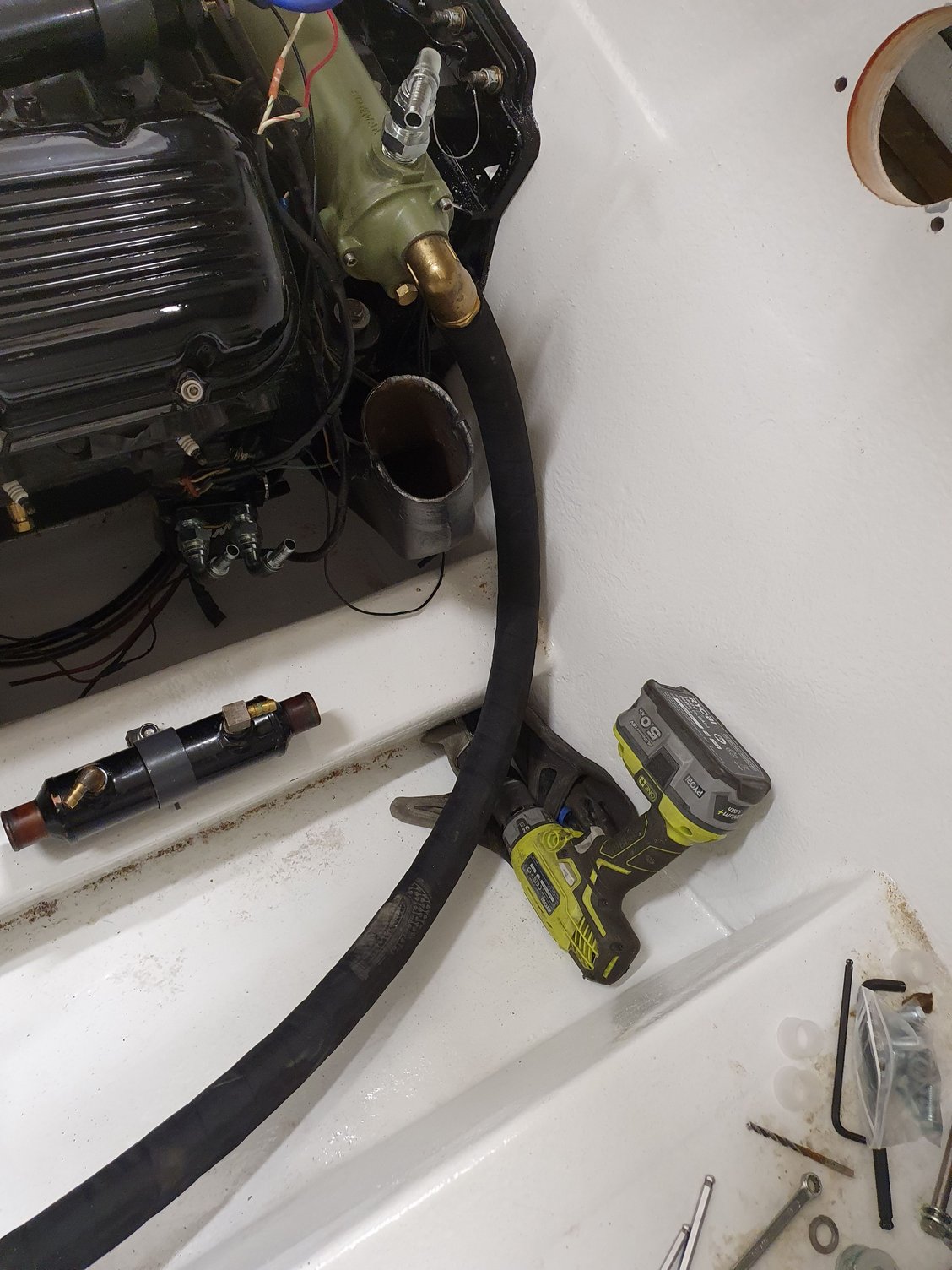

Cooling system mockup. Seems to be easy job without the silent choice.

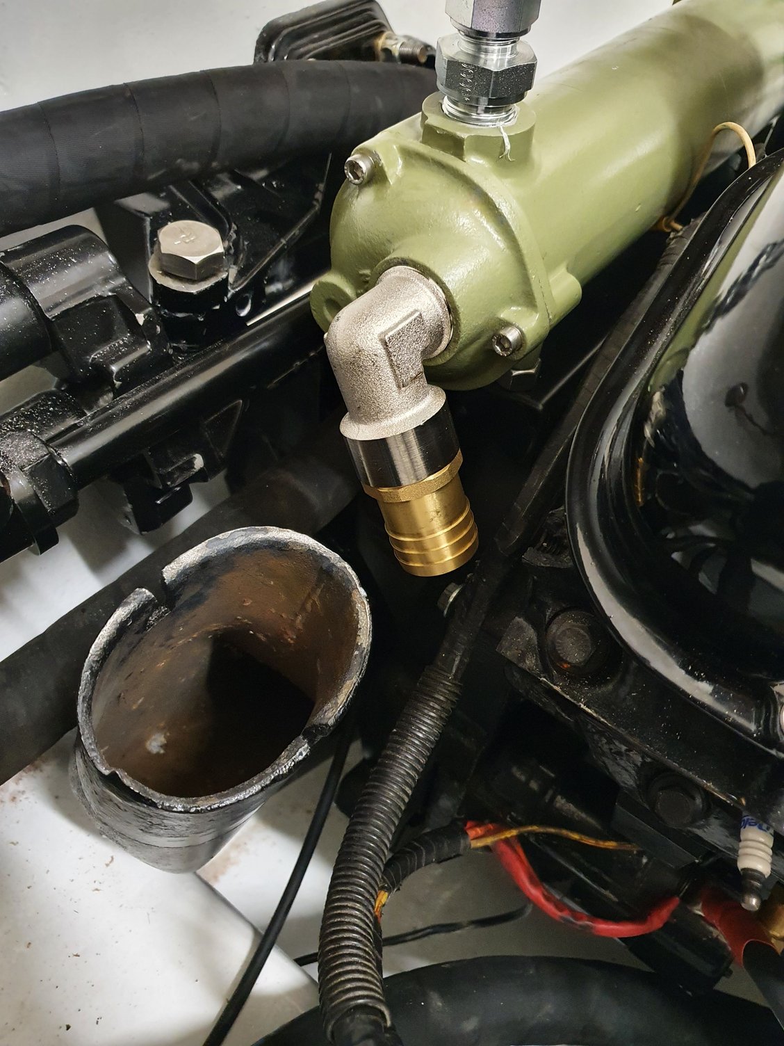

There are 2 things i dont understand in your pictures... first, dry to transom... where is the water from your top exhaust riser going? And if the answer in no where, water eont circulate thru the engine ! And your dry dry smaller exhaust tubes, if there is no water at all cooling them, i would be effraid for heat and rapid fire of the whole boat!!
so, what am i missing?
jeff32 is offline
Exhaust hoses are missing in the picture, water comes out of the riser to the exhaust hose, just like in 99% of the inboards.
