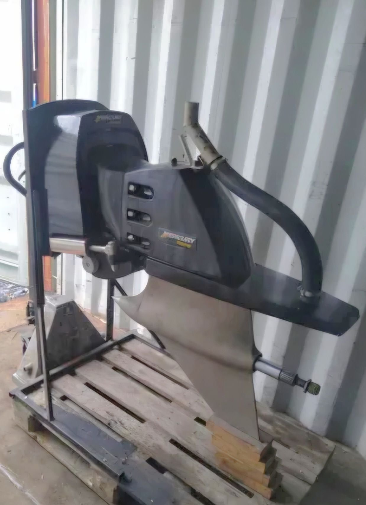

Hi all
A new member from Norway here.
I bought an old racing boat that was raced in a series called SuperVee here in Norway.
The boat was buildt here in Norway.
Not sure what the setup was back then, looks like a trimax drive or something similar.
But its been a pleasure boat the last 10 years now, and its been running with a supercharged Teague V8 and a Speedmaster 6 drive.
I bought the boat without the engine, but with the drive. The drive needs to be rebuild after it broke down. Not sure how bad it is yet.
But could somebody tell my what generation drive i have?
Tried to do some research, and from what i understand it was first the K-Drive ( Kieckhafer) , then Speedmaster 6, then 6A and then the M6?
Do i have the Speedmaster 6? And is it worth rebuilding? Can i still get parts for it? When did the drive get reverse internaly ?
https://cimg2.ibsrv.net/gimg/www.off...35a5ae225b.jpg
https://cimg6.ibsrv.net/gimg/www.off...37bfbbdd72.jpg
https://cimg0.ibsrv.net/gimg/www.off...dd9cad0c8b.jpg
https://cimg1.ibsrv.net/gimg/www.off...12338ac54e.jpg
https://cimg2.ibsrv.net/gimg/www.off...d7b4a2398d.jpg
Agreed looks like you had a TRIMAX with a Rudder or possibly an Arneson with a Rudder back in the race days.
#6 drive now
Agree with General Concensus its probably Wetsump gearcase & modified Skeg
The way its painted reminds me of the old #7's that
were set up for Diesel... but anyway could have painted it this way.
You will need to know the gear Ratio when picking out replacement gears. Any identification on the gear itself? Engraving or Laser Etch?
Very Cool boat you have 👍

From what I have found out, the drive is under the defenition in the Mercury system" Early style pre-1998". And I found a number on the upper casing, its 10002. And the parts i need are not available anymore. I probably have to get them machined.

I found a second hand drive with a low hour count. Thought it was a drysump, but the seller didnt know cause he never used it himself. Checked with my local dealer with the serial number, but they couldent tell either!? So how to know for sure?
OM958475
https://cimg1.ibsrv.net/gimg/www.off...e85a6ede90.jpg
https://cimg2.ibsrv.net/gimg/www.off...927d69fc1d.jpg
https://cimg3.ibsrv.net/gimg/www.off...7fada80364.jpg
https://cimg5.ibsrv.net/gimg/www.off...13687f1f92.jpg
Hoodoo 2.0 04-12-2026 06:28 AM
That one is a dry sump
