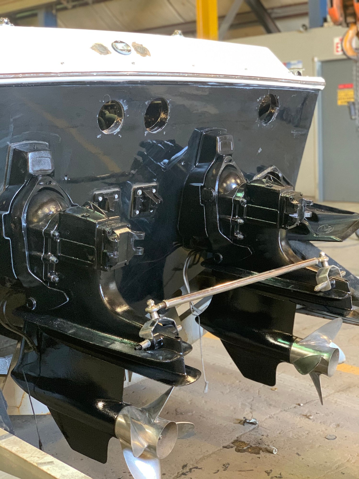

Deleting a bunch of holes and the rear pickups, found some cracks and glass that was delaminating so my quick job has inevitably changed. Most the parts are blasted and ready for paint. I keep staring at the engine bay and I think while it’s apart I’m going to scuff it up and repaint, maybe it’s a mistake but I want to do black...

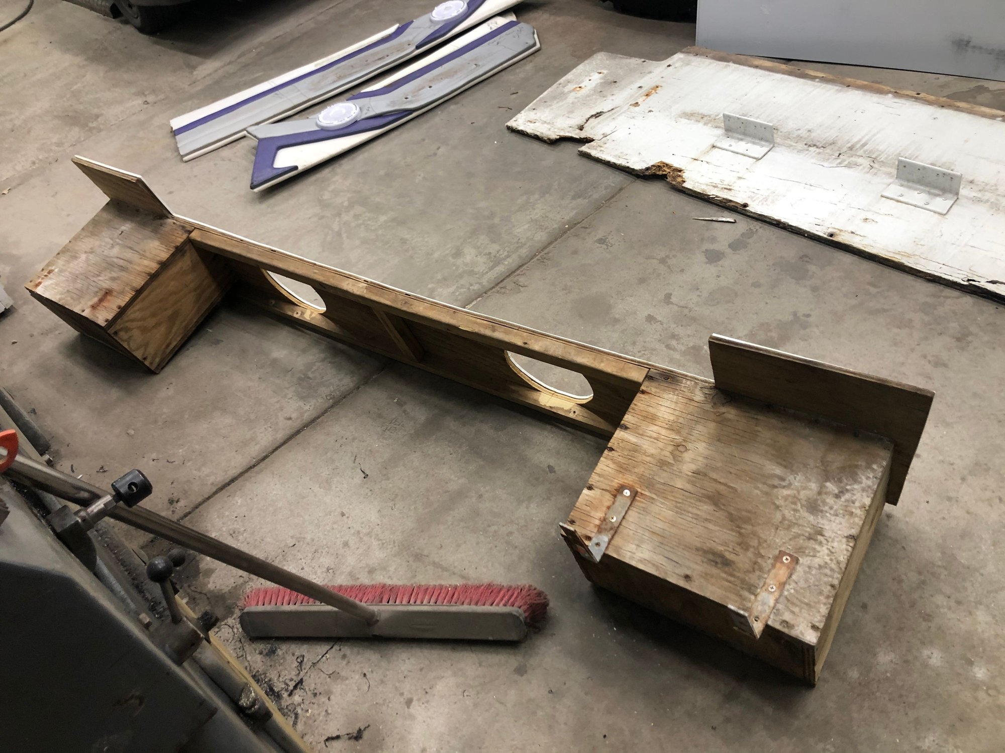

Nocoast 05-03-2021 08:36 AM

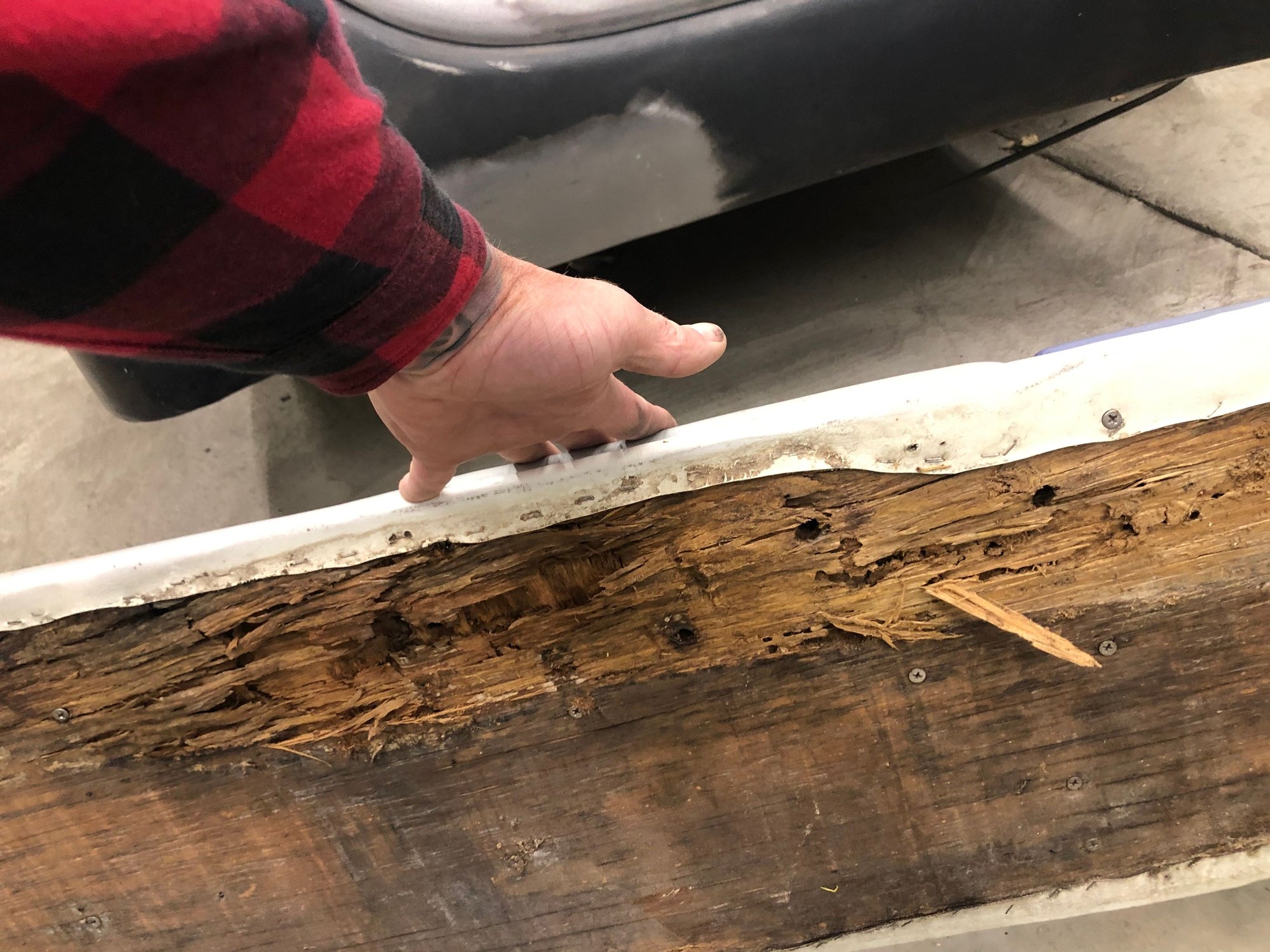

Got back on the boat, spent the majority of the weekend sanding. Pretty sure I’m going to itch for the next month lol also found some rot, the firewall was made out of 3/4” melamine so it looked good but was toast behind the white face. Back seat was rotted along with the side panels. I have a different plan for repairing most of this from the hot rod world that I think you guys will like so stay tuned for some aluminum vood

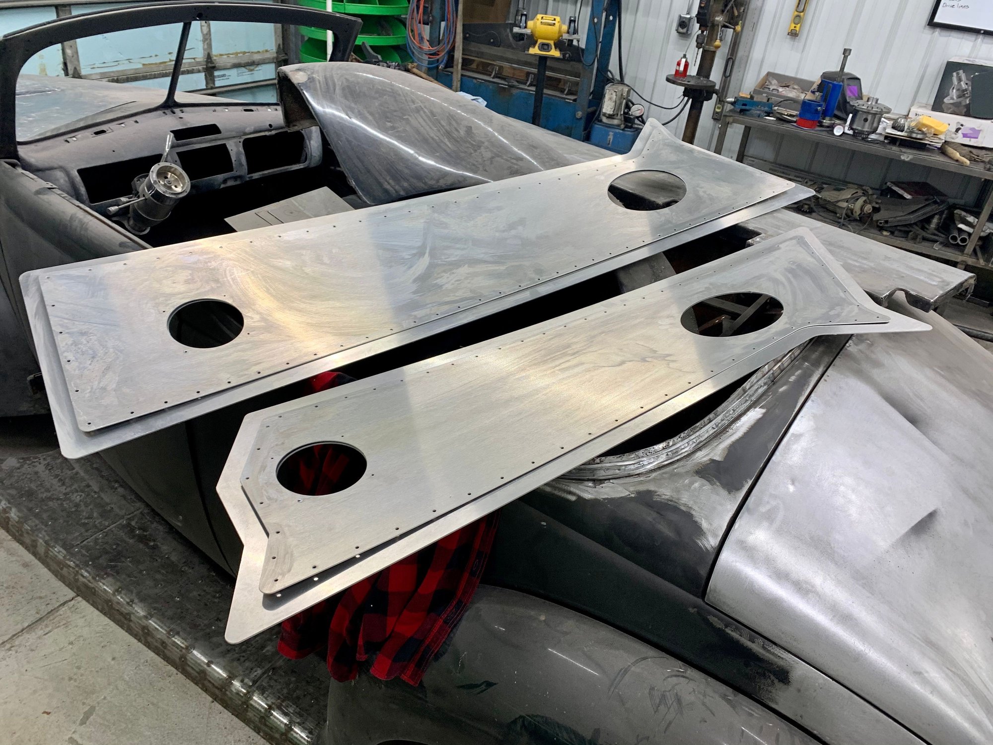

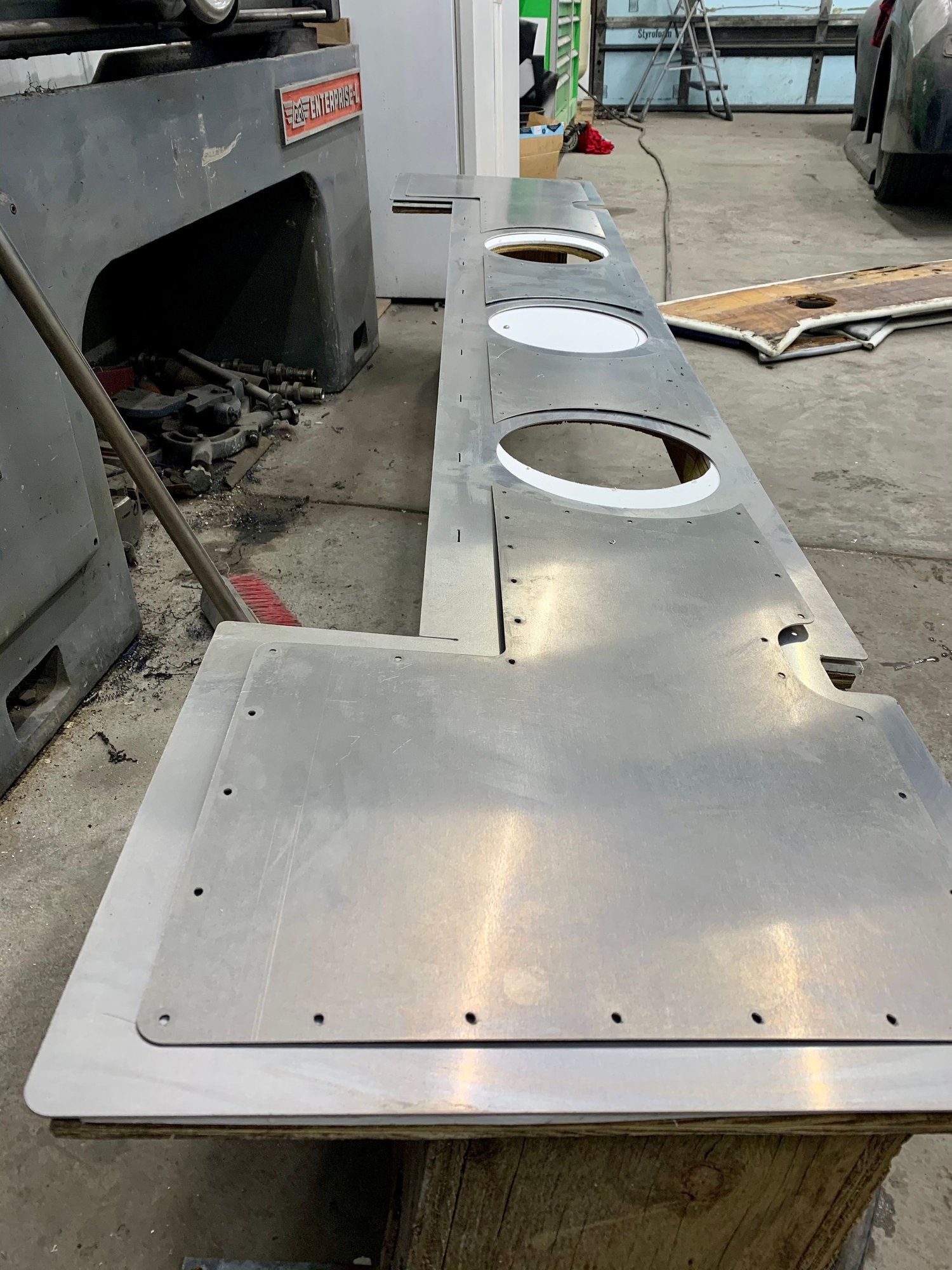

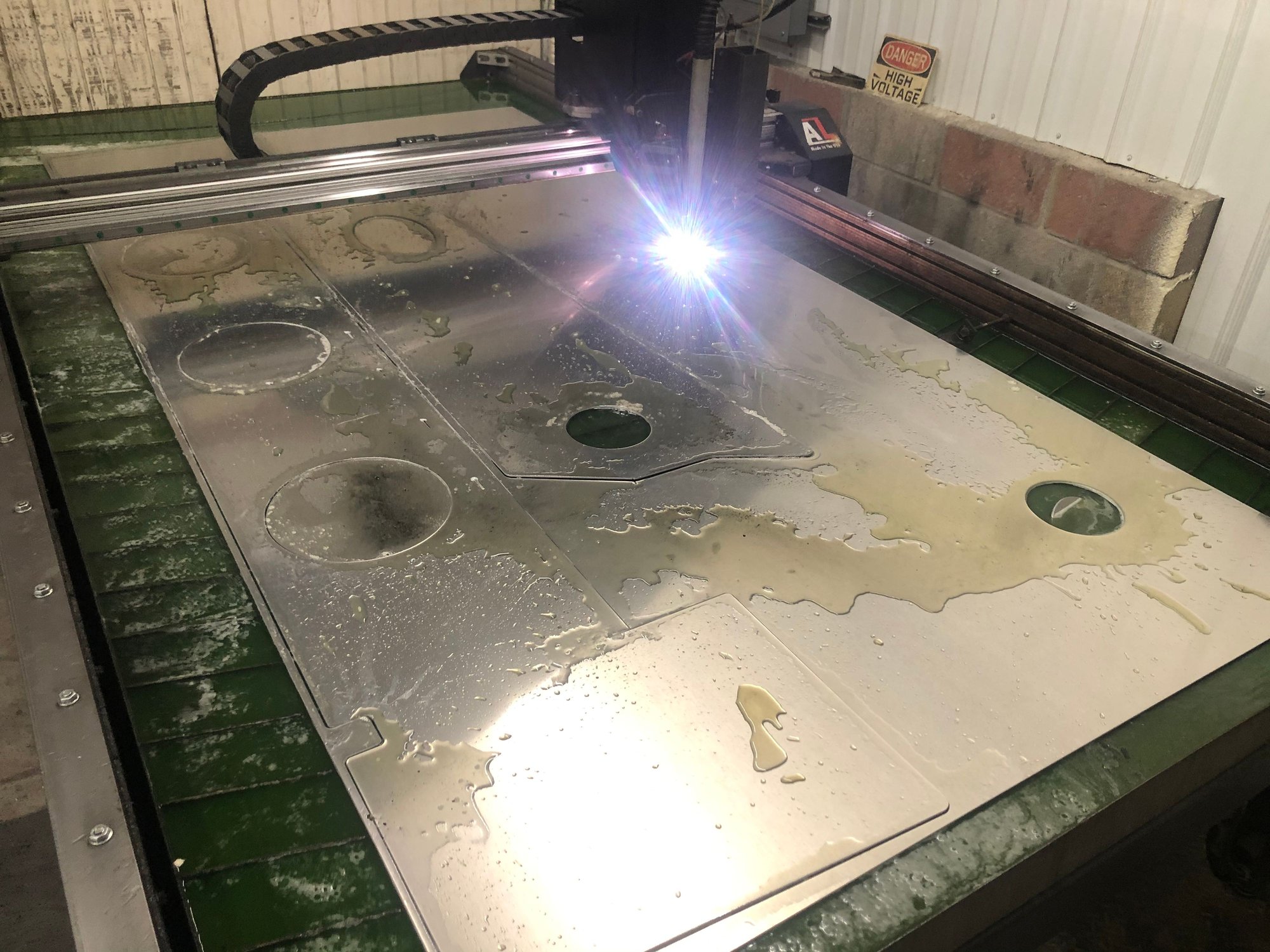

Been rigging the last few nights, should be dropping the motors back in this weekend. Also started on the interior panels, got them drawn up and burned out I have quite a few hours of bead rolling and riveting before they’re ready. Nothing exciting but here’s a couple progress pics.

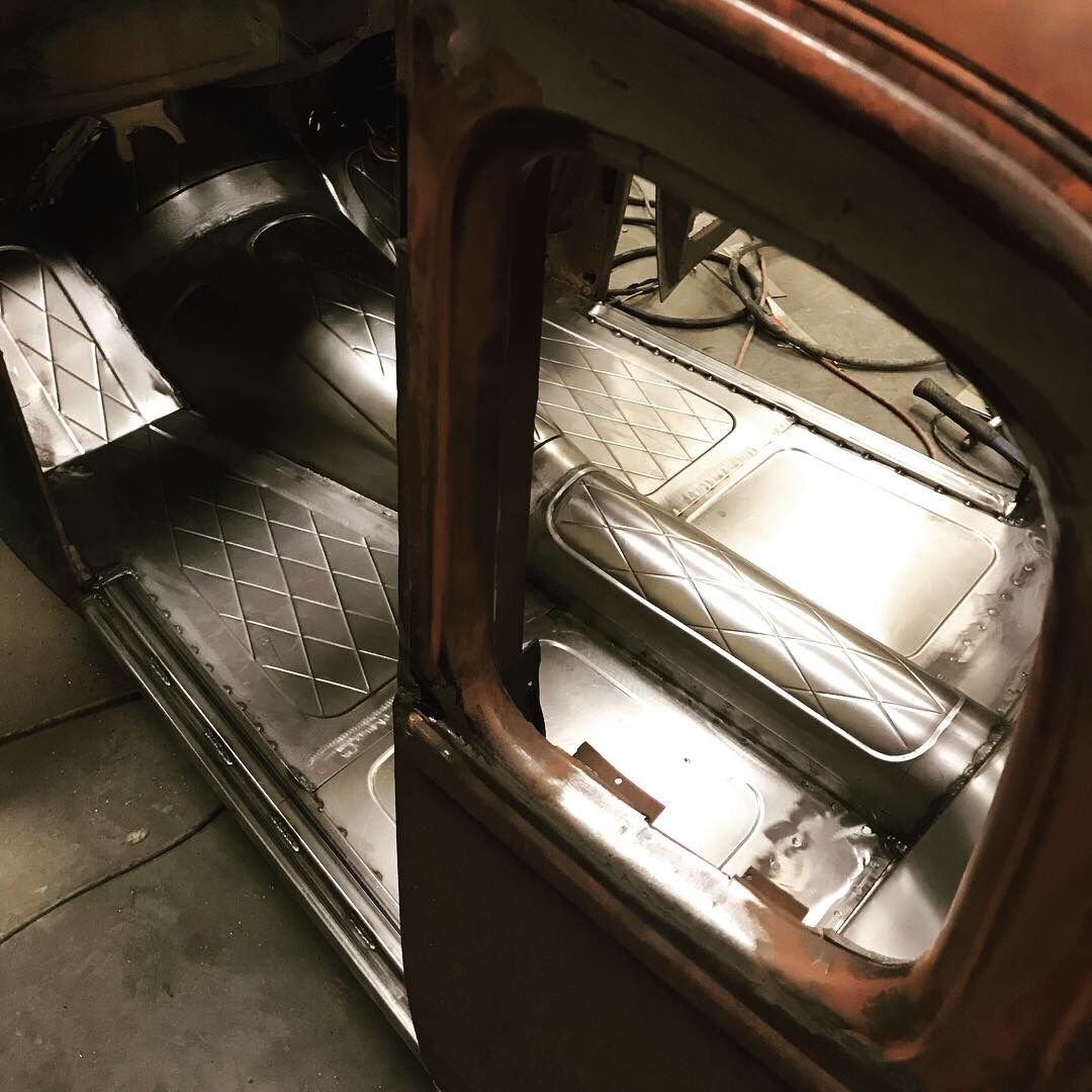

This will give you an idea of what I’m doing with the panels. All the inserts will carry the diamond pattern and be attached with aircraft rivets. The new panels weigh about 1/4 as much as the originals. So far I’ve shaved around 300lbs off the boat, mostly from ditching the closed cooling

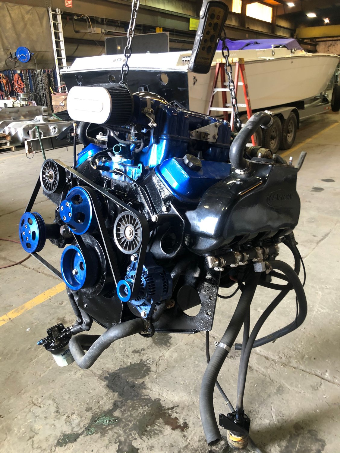

Got everything thrown back in, I still need to run cables, hoses, wiring, etc. found a couple cables that look questionable so I’ll get those ordered, I’m digging the colors now that it’s together, I still have some clean up to do everything got destroyed from a dust storm. The drives look ok’ish I didn’t put a lot of time or energy into them, this will more than likely be their last season. I think I’ve decided I want to put Konrad’s on it.

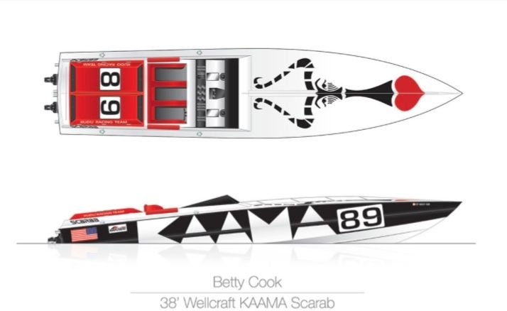

This is the paint scheme I’m going with, gotta love the legends
hblair 05-18-2021 12:48 PM
I seriously considered that paint scheme, but couldn't talk myself out of the MV scheme. That will look awesome.
