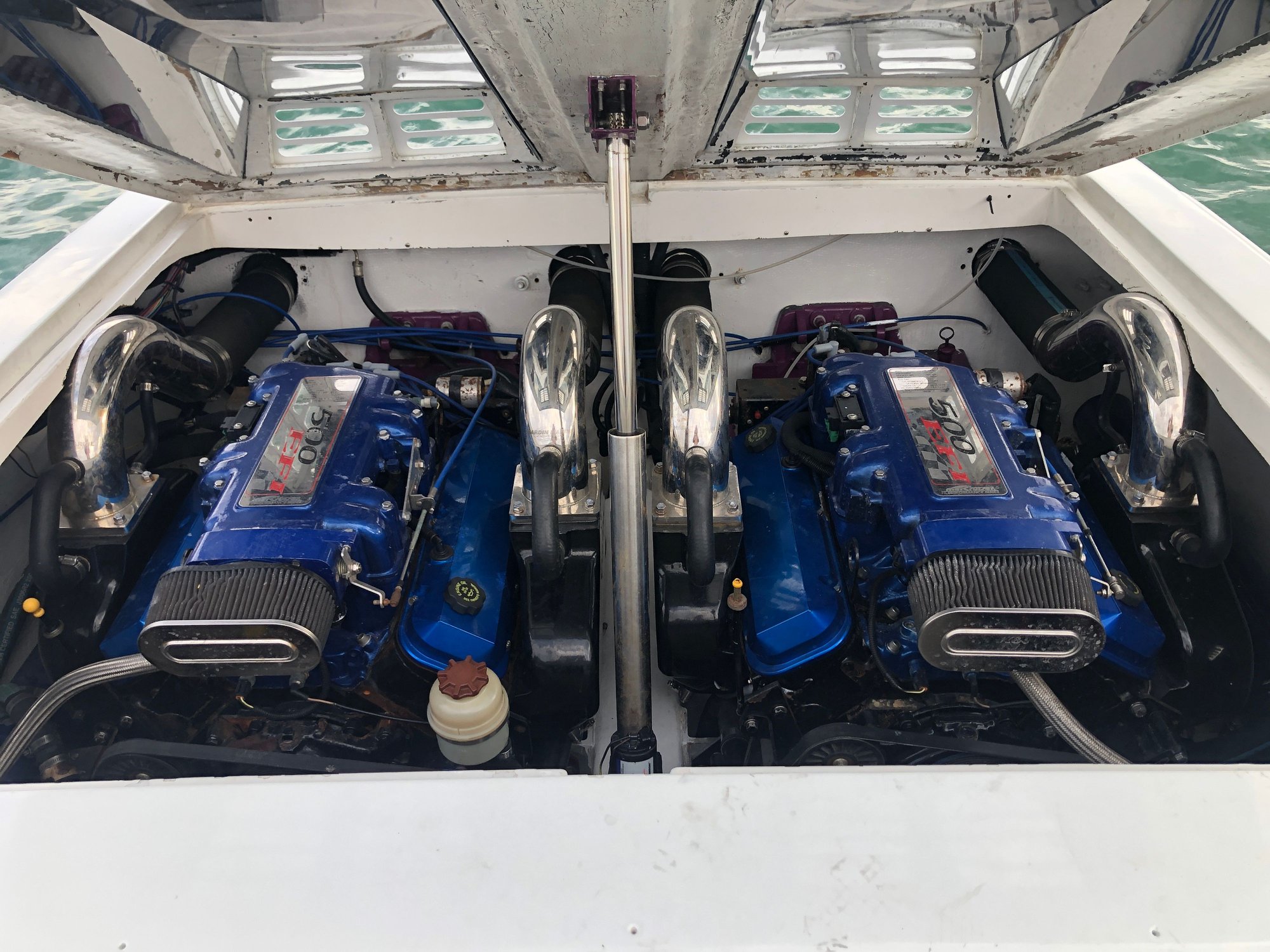

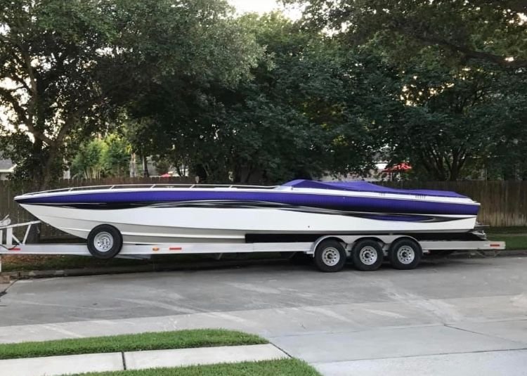

Nocoast 02-24-2021 11:50 AM
I can finally post pics so that is the boat. I'll post as I do stuff but it is more of a long term project. This years plan is to blueprint the bottom, get rid of the graphics and fix a glass issues in the cuddy, I think I am going to gut the front and ditch every bit of wood in favor of composite. The long term plan is to have a wood free boat hopefully shedding 1k lbs or so, quad turbo the 500's since it was an option back in the day, drop the floor a few inches so you sit further in the boat and do the betty cook 89 kaama paint job. I am far from being a knowledgeable boat guy I have had a few but my background is in building hot rods and fabrication so any input along the way will be greatly appreciated!
