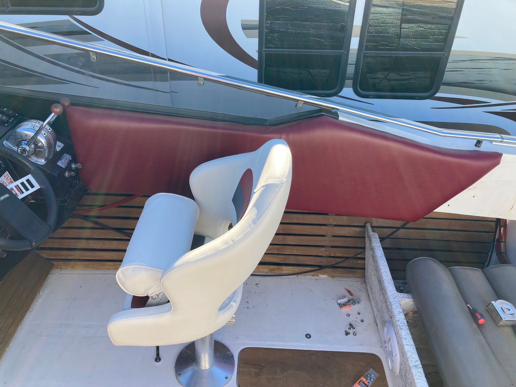

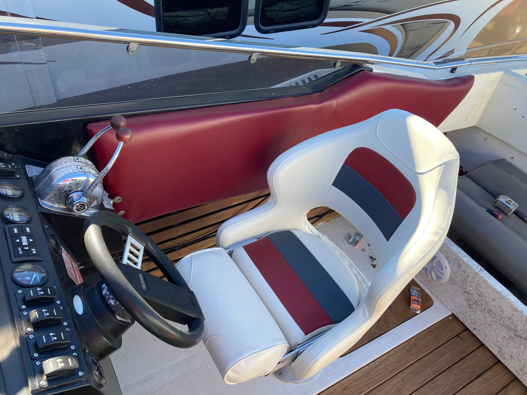

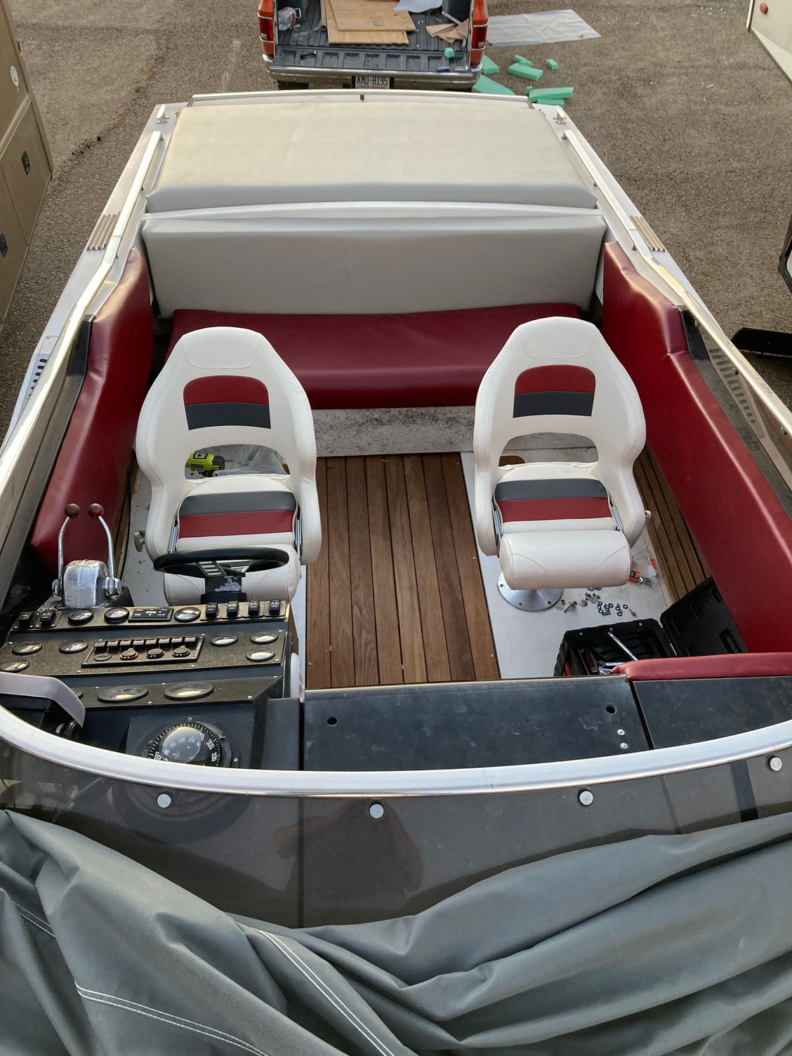

Haven’t posted in a while. I fixed the bad thermostat, put in fresh spark plugs, and adjusted carburetor idle. Both engines are reliable and don’t stall anymore. I did another Havasu trip in October. Today I gutted out the old cockpit upholstery and built all new panels. I kept it plain and inexpensive. Jo-Ann fabric was having a liquidation sale so I got foam & vinyl for cheap.
She’s not gonna win any shows, but the interior is great for beaching at the sandbar with the dogs!!
https://cimg7.ibsrv.net/gimg/www.off...fdba90645.jpeg
New Wise seats and custom built side panels.
https://cimg8.ibsrv.net/gimg/www.off...909049221.jpeg
https://cimg9.ibsrv.net/gimg/www.off...95975daf9.jpeg
All interior panels Re-upholstered.
