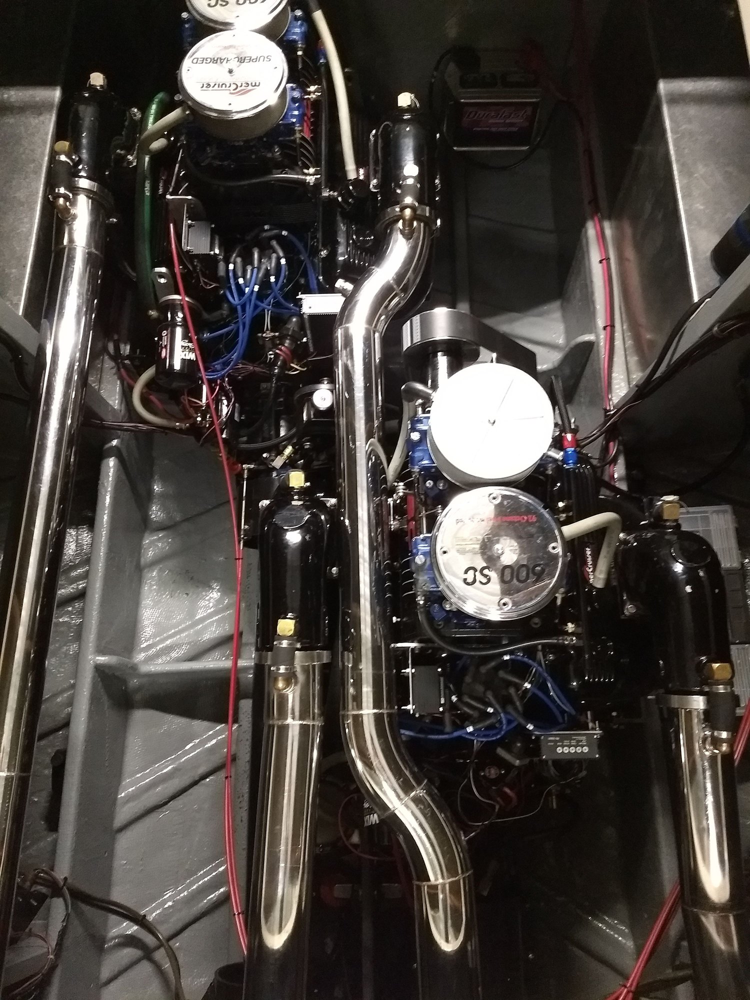

My last build, some may know the engines I built. Who hoo.
Last build, two 650 hp bad boys
B38 is offline
