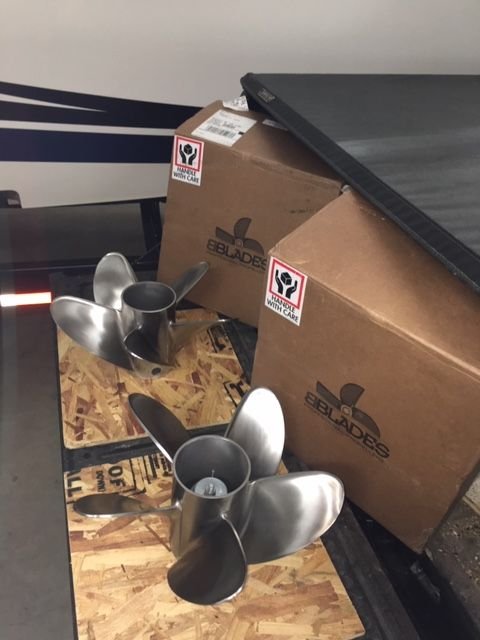

Looking for some recommendations. I have an 07 35 full staggered lightning, 525’s, XR Sportmaster lowers. I would like to buy a set of 32 Maximus but not sure what diameter (15.25 or 15.625) & diffuser tube length. Any help would be appreciated.

I remember that you said it had 7 blade Herings on it - those should be great props. Contact Bblades for more info, as my Fountain had a set of BBlades props ( Maximus) labbed for my boat on it when I purchased it. The blades were really dinged up, so I asked the seller to repair as part of the deal, he sent them to a local prop shop, which screwed them up. As was pointed out to me, the early staggered boats were not set up perfectly from the factory, I ended up installing 1.5" drive spacers to get my slip down and more easily plane the boat. The propshafts are still above the bottom of the boat, Fountain set them really high.

I'd call BBlades for a recommendation. They built some 32 Max's for my old side x side 35. They were great props.

Call me anytime. We can send you some 5-SPEEDS or stock Maximus props for testing or simply build what you need.

I've been meaning to post up for a while that I now have a brand new set of labbed 5 Blade Maximus's from BBlades. Brett took the time to talk to me about the specifics of my boat & what I was trying to accomplish. Great guy & excellent customer service!! Just need the weather here in NY to cooperate so I can get some test time. Thanks again Brett

Have you had a chance to test these new props? If so what have you seen for results?
