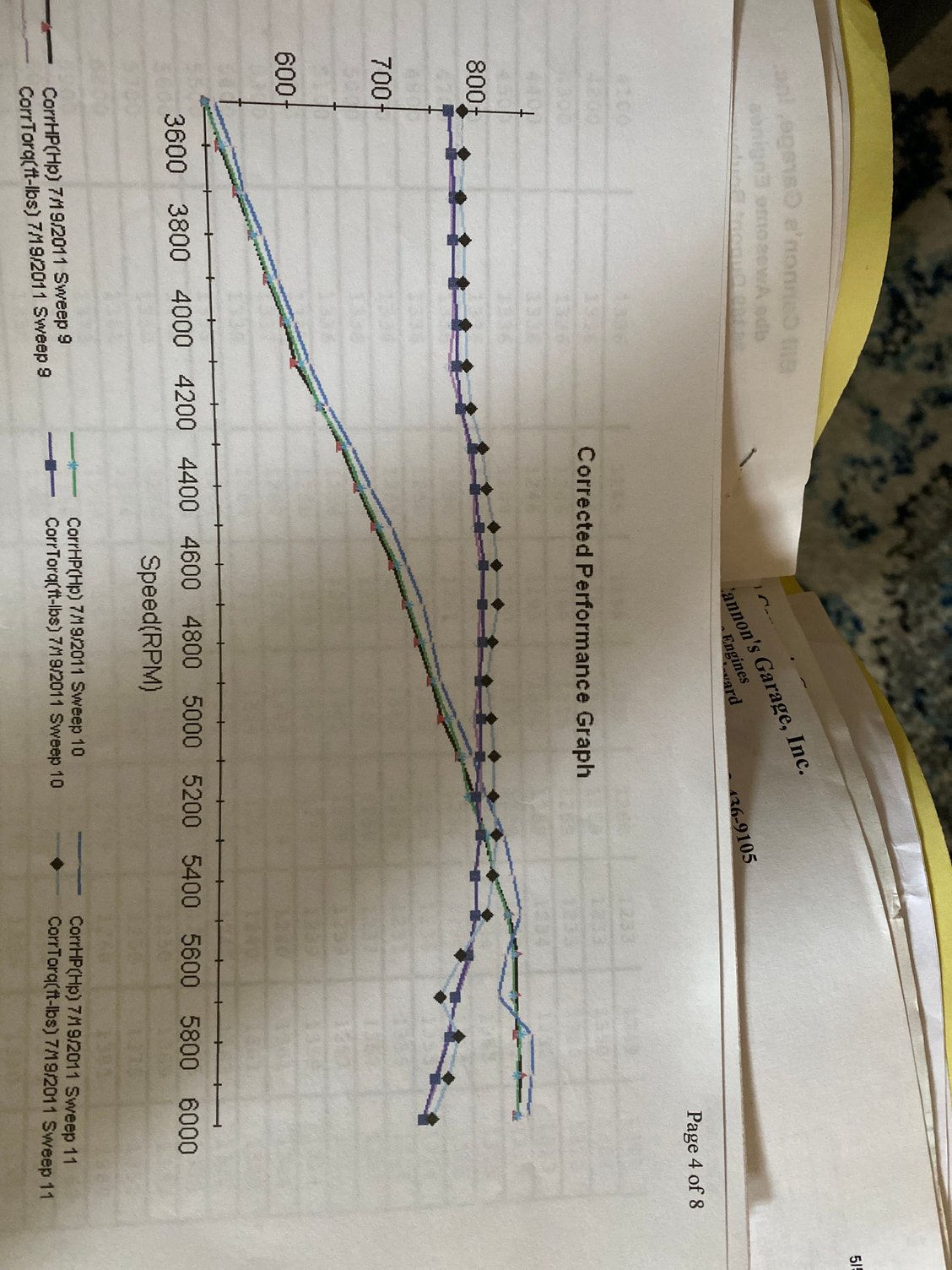

Post a dyno sheet.

Posts: 79
Dyno sheet
Pulse74 is offline

From looking at that sheet you'll be ok spinning it anywhere from 5600-6k. The HP curve is really flat there. The torque curve is downright impressive. It's just gonna be a matter of getting the correct prop on it.
Thanks. I built it a few years ago. Although it makes power to 6K the boat always liked to be propped in the 5500 range. We tried propping to get the RPMs up and the boat went slower so basically you give it what it wants.
With the right prop the boat runs a consistent 84-86mph. Previous owner ran over something and ruined the labbed 28" Bravo 1 prop that was on there and wasn't able to find the right prop since. We tried BBlades, Hydromotive etc and the best prop was a labbed 28" Bravo 1. The only issue is that we don't know exactly how that prop was labbed or who labbed it as it was a hand-me-down. I suspect that it had some diameter cut out of it because we did run an old labbed 28' that a buddy of our had and it didn't like it but for whatever reason, the 28" that we ran for years was the fastest prop.
The boat has an SCX on it and it robs at least 3-5mph so keep that in mind.
