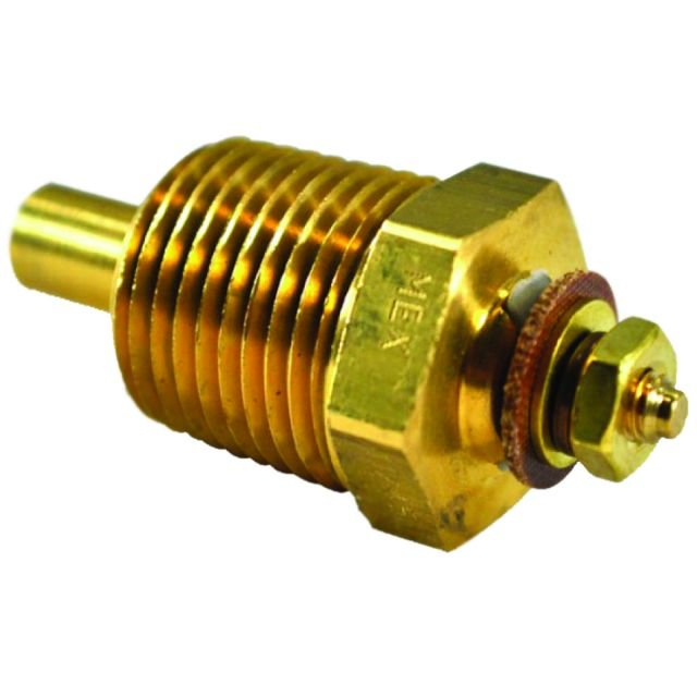

Mine are labeled 102700 which I believe is a temperature sensor with a range of 100-240 degrees. Uses a stud and ring terminal. This appears to be a sensor, not a switch, so the mystery continues. These wouldn't work in the oil system and wouldn't work for the alarm trip on the ECM unless the switch is reading actual temperature (the transmission switch is just that - a switch).
My transmissions have the switch in your reply and are connected to the alarm systems.

Originally Posted by TomZ
Mine are labeled 102700 which I believe is a temperature sensor with a range of 100-240 degrees. Uses a stud and ring terminal. This appears to be a sensor, not a switch, .
Correct.
DATCON TEMPERATURE SENDER SENSOR 102700 ~ Low Range ~ 100-240°F ~ 3/8 ~ OEM
