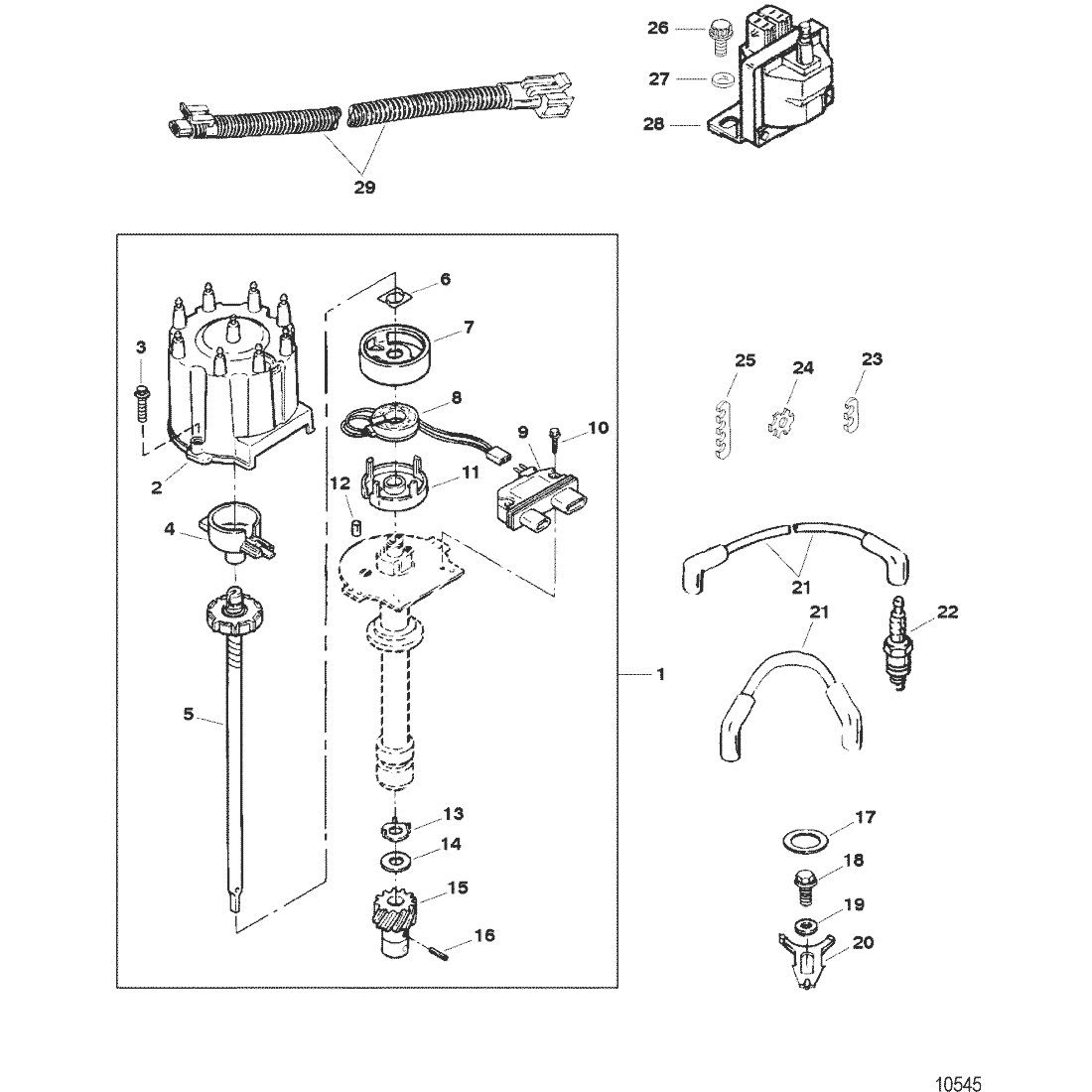

Sure sounds like a distributor module to me. Use arctic silver heat transfer compound (or similar) when you mount it. Remove old compound for dist mounting surface. Read how to apply (extremely thin layer) the compound.
Do not get aftermarket module. Get the Acdelco or Merc one - which will be a acdelco one. Get the #’s from your original one.
#9 is the module
