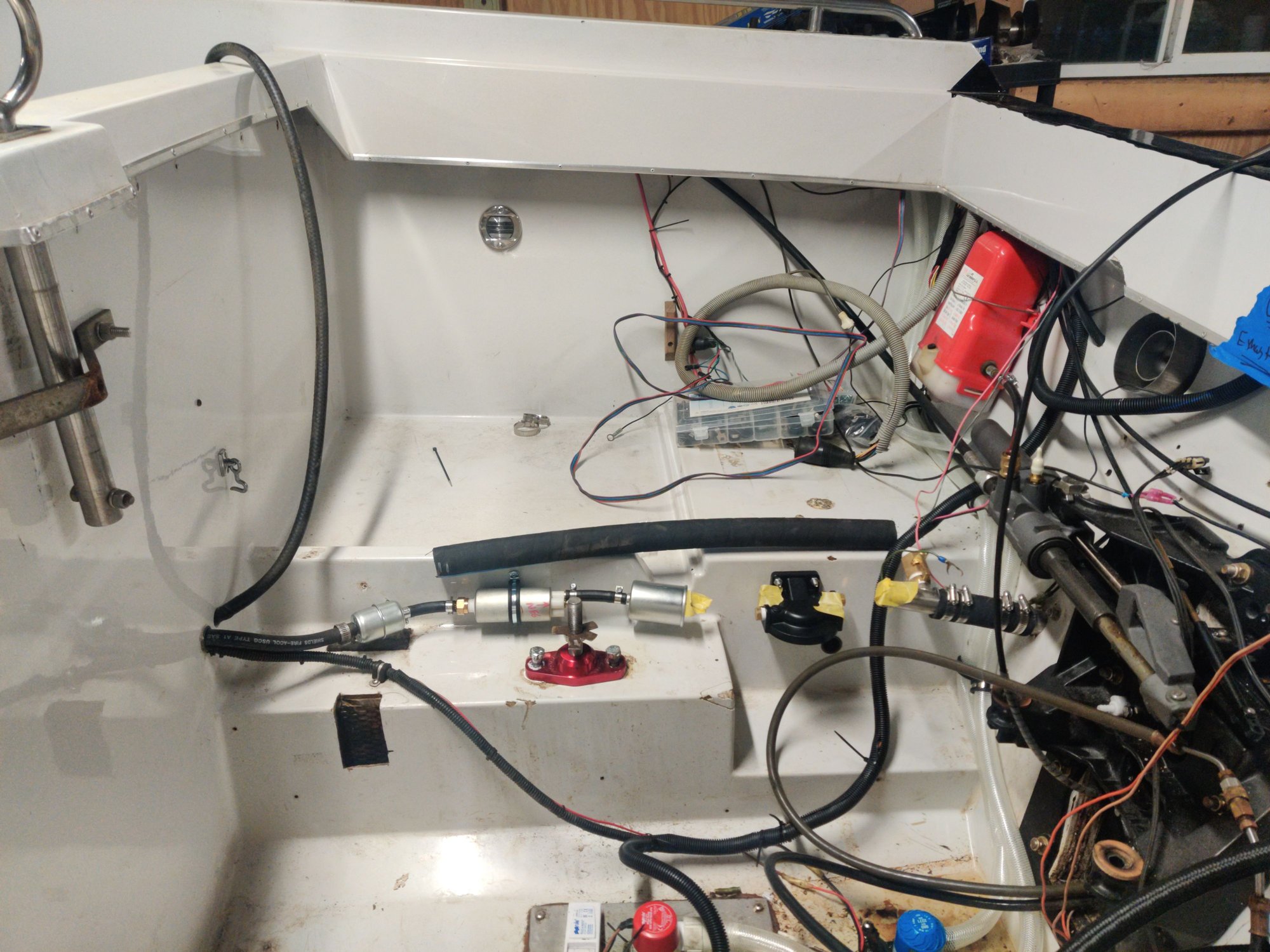

I have mine on the stringers. As you can see I return right before the filter. You want your return hose the same size or preferably one size larger not smaller.
Returning back into the supply line like that I understand why a fuel cooler is necessary but I would think going back into t a 100Gal tank it wont be as critical? Problem I have it the fuel filter is mounted up higher than I like I may have to look into relocating my fuel filter as well but my engine bay is quite tight in a Baja 252. The pain in the ass is since my Holley HP is on B/O im going to be running on a carb until the fall when I switch over to the Holley EFI so ill be doing things twice!
