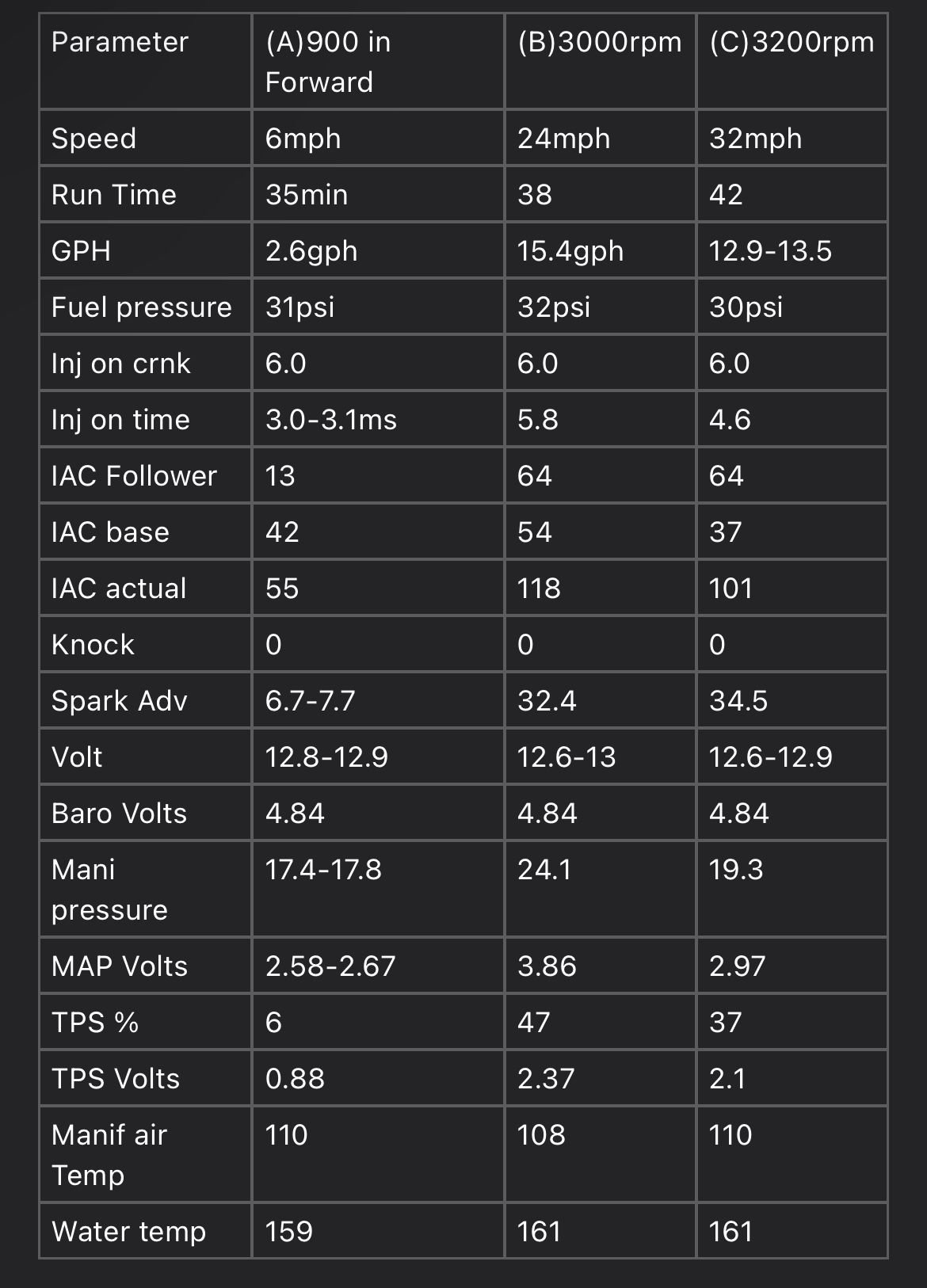

Data:
You can see when it’s running like crap (column b), it shows way more TPS, at a much slower speed, way more GPH, increased pulse width, etc compared to column C at almost the same speed.
*I will attempt to attach the chart and videos, not allowed due to post count*

Data:
