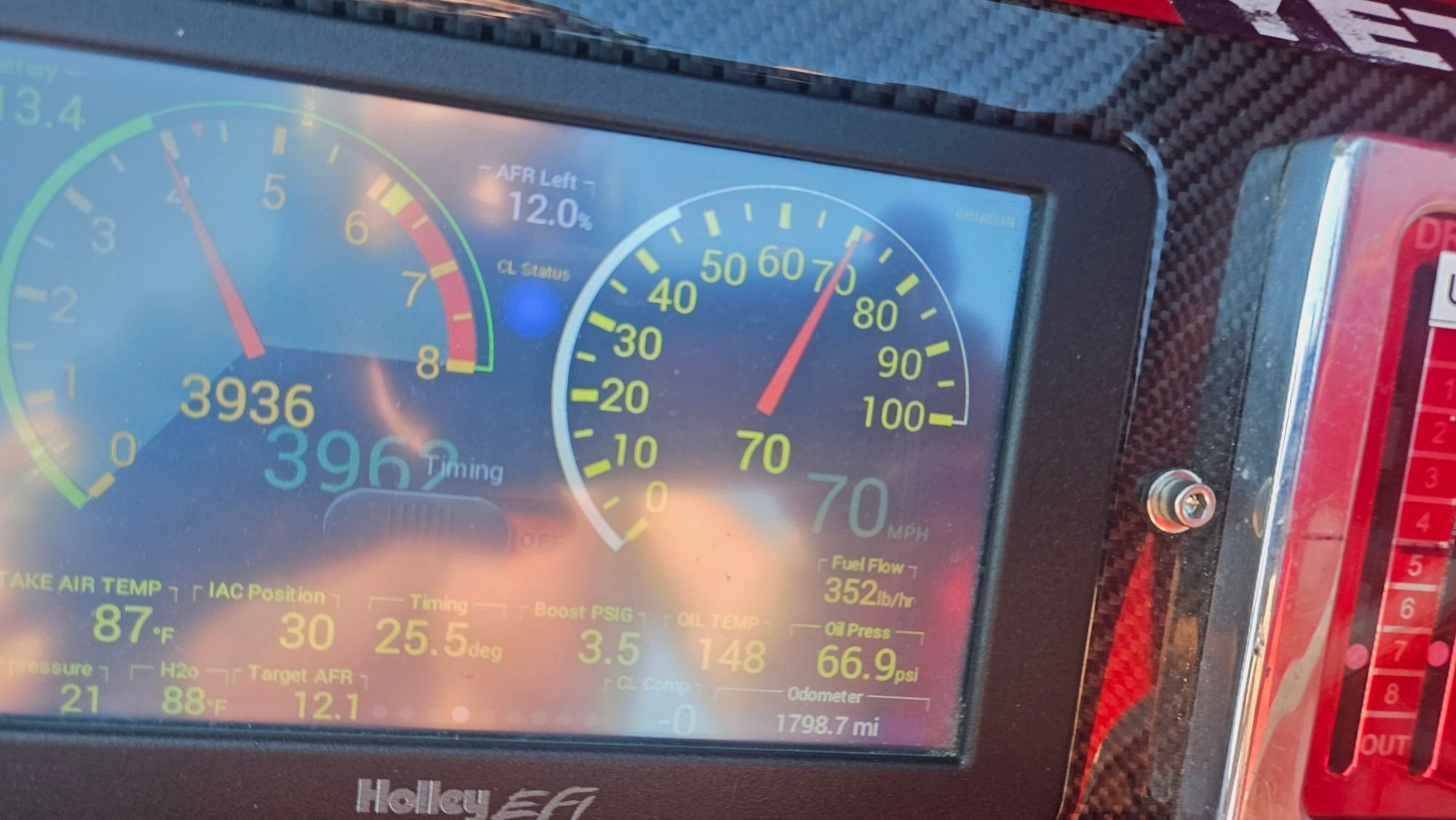

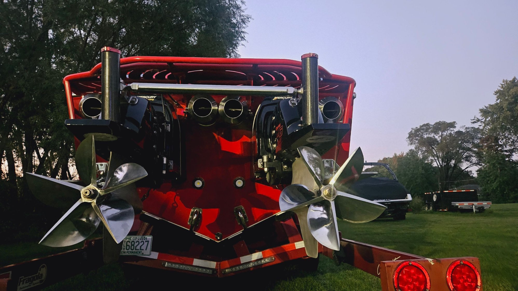

Question Cleaver labbing
I have a stock merc prop (kinda thick) that`s a pitch or two too large . 18x31 R15
The cruise is great 70mph at 3900 but I would like less engine load at cruise , Thats about 3-4# of boost versus 1-2# with a 18x29 R18
If labbed how much cruise speed should I expect to lose?

What HP rating are you props? I would think your boat likes the 18 rake more than the 15 as well, no?
100% right, it loves more rake. I`d love to try a 20* rake.
I spoke to Cutting edge, he could get me some more rpm in the midrange, I would lose some speed but also run less boost and the props would be thinner .. hmm . I got some decisions to make.

The cruise is with 31 pitch is really nice .... 4000k rpm and 3.5# of boost.
