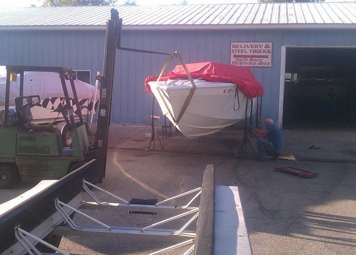

What Jeff said.
Quick visual putting my Panther on stands.
