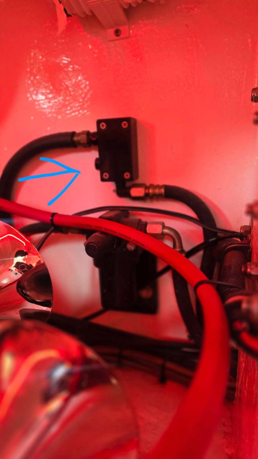

I'd like to hook up the other power steering pump.
I have this in the boat, would it be as simple as hooking up the pressure line to that port.. and figure out where the return line goes?

Dan, if you want to operate both PS punps at the same time, you need a sinple check valve system from each pump source where it joins into the single pressure feed. You also need to have a common resrvoir.
Alternative solutions: have valves setup to swith feeds if one engine or pump fails...to run the other one. (One would be just freewheeling until needed)

I would say it depends on if that box has check valves to prevent fluid from flowing backwards into the other pump. And then there needs to be a way for the fluid to get back into both pumps.
You would need this IMCO valve Search

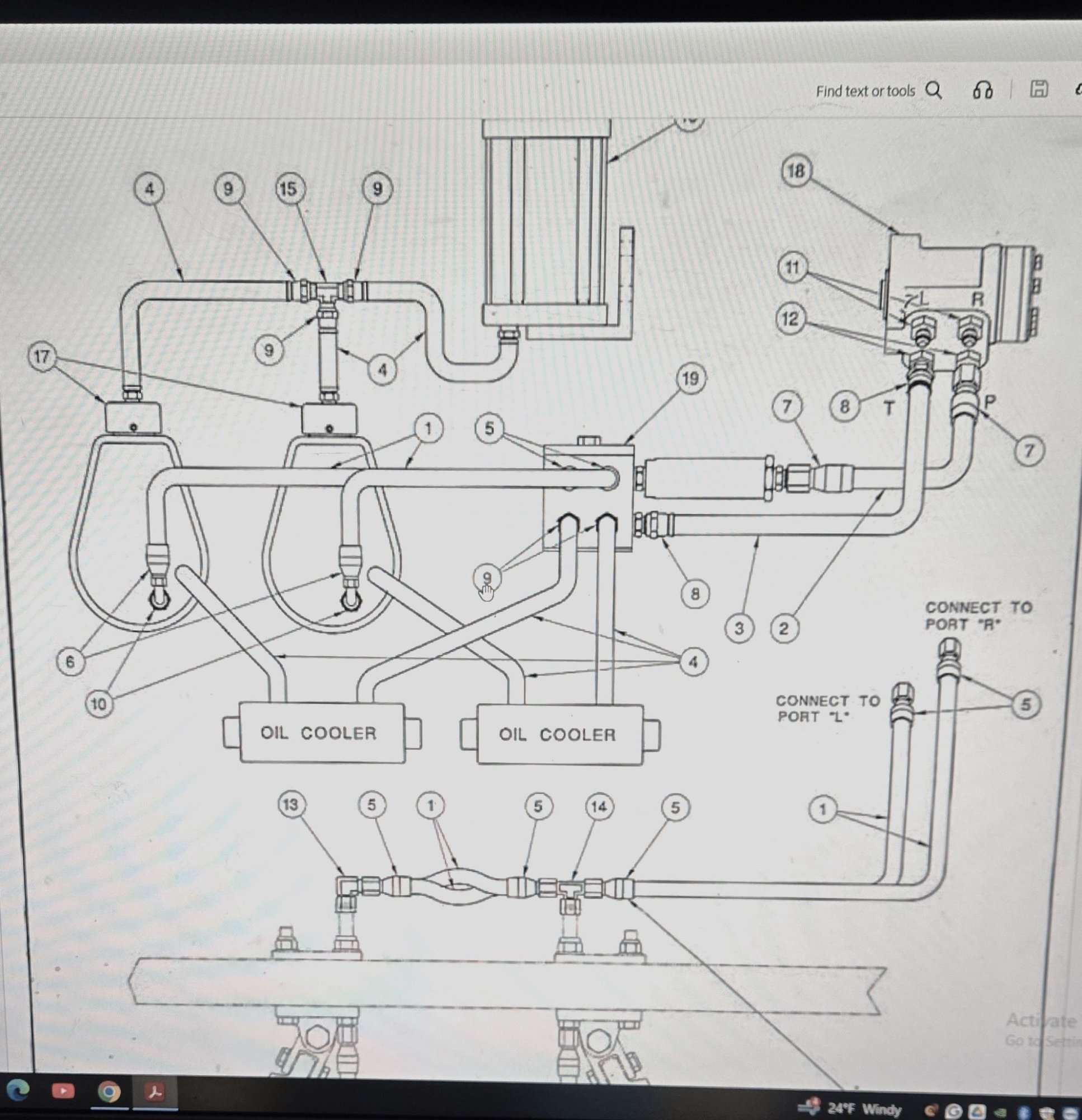

I think this would be the diagram that valve.
ICDEDPPL is offline
This looks correct other than fluid returning to the pump from the coolers. It should return to the reservoir
