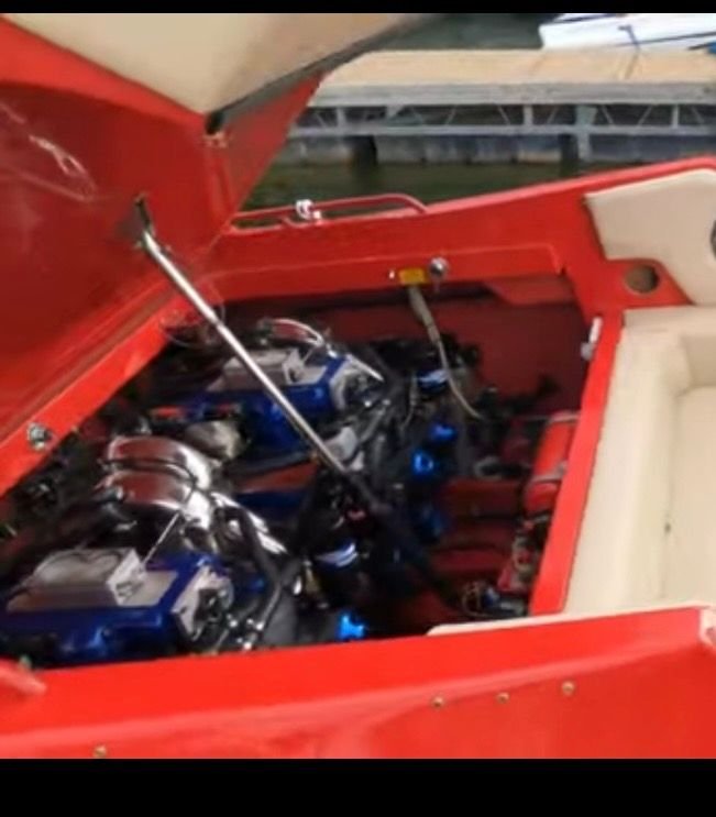

Anyone know anything about this intake >

Default Anyone know anything about this intake
Looks like 500efi that’s been modified
any though good or bad or who made it

Any better quality picture ?

Best I could do
saw it on a video and did a screenshot

Yup.
A few engine builders did that mod to the OEM intake for more airflow and a few extra hundred more rpm that intake otherwise kinda flat lined at.
Tyler Crockett was one of the builders, i can't remember the others. Do a google search thru offshoreonly.com 500efi intake manifold modifications
or similar
