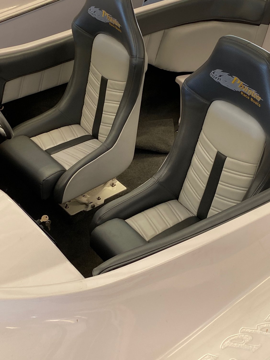

I have these Shockwave S5 models in my 30 Phantom and they work great. These adjust to the passenger's weight which is something they may all do but it it very helpful in smoothing out your ride.

Beautiful boat! Were the shockwave seats original equipment or did you retrofit? Which S 5 are they? Who did the uppers?
