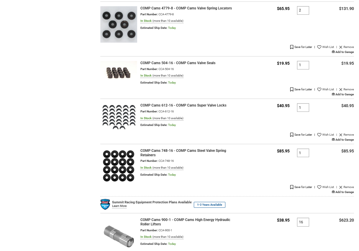

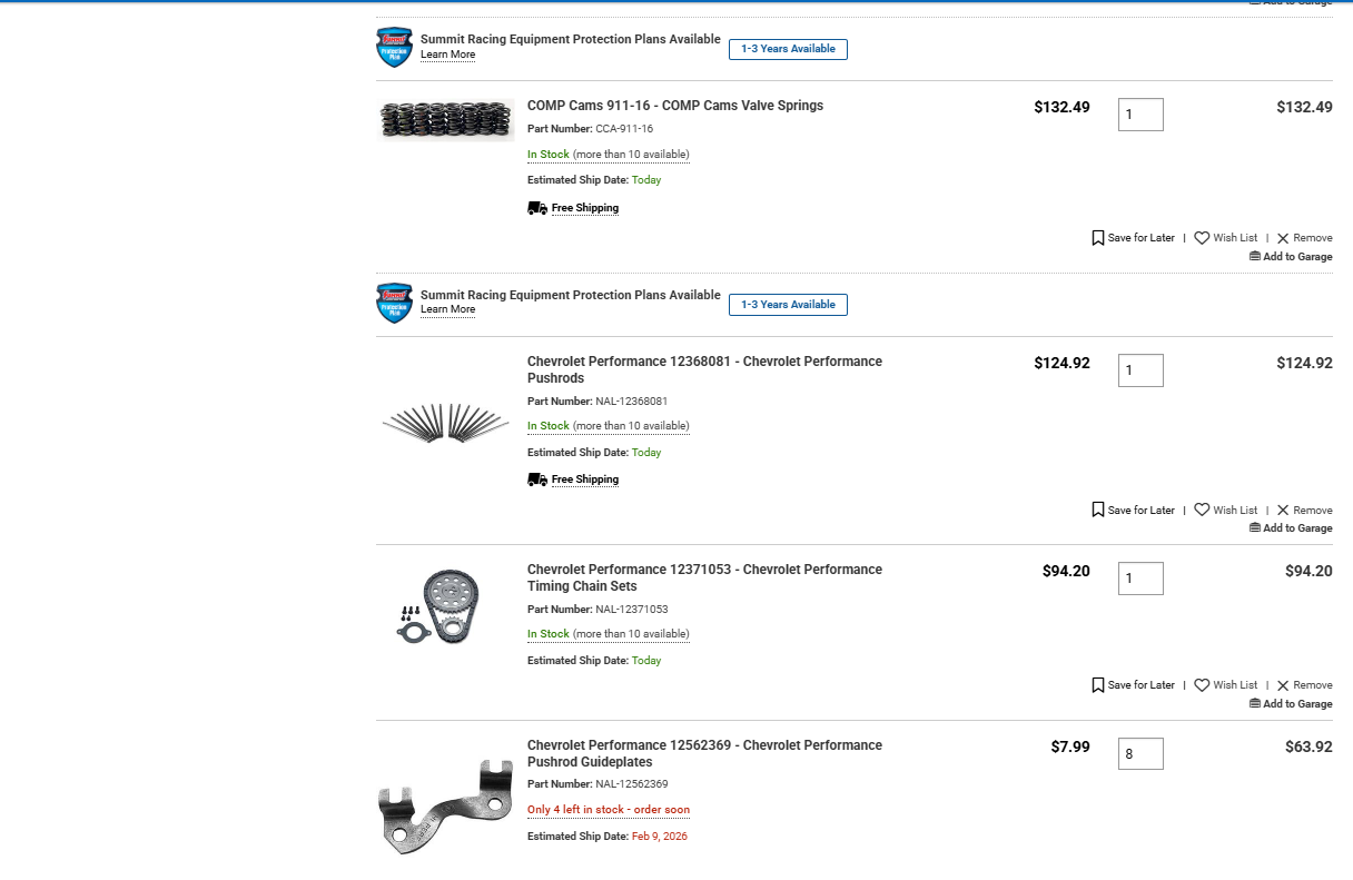

Parts list below. Some folks find the comp lifters to be noisy and agree the GM performance Part lifters seem to be the way to go. Obviously pick a cam. All of these get you near 500 hp.
