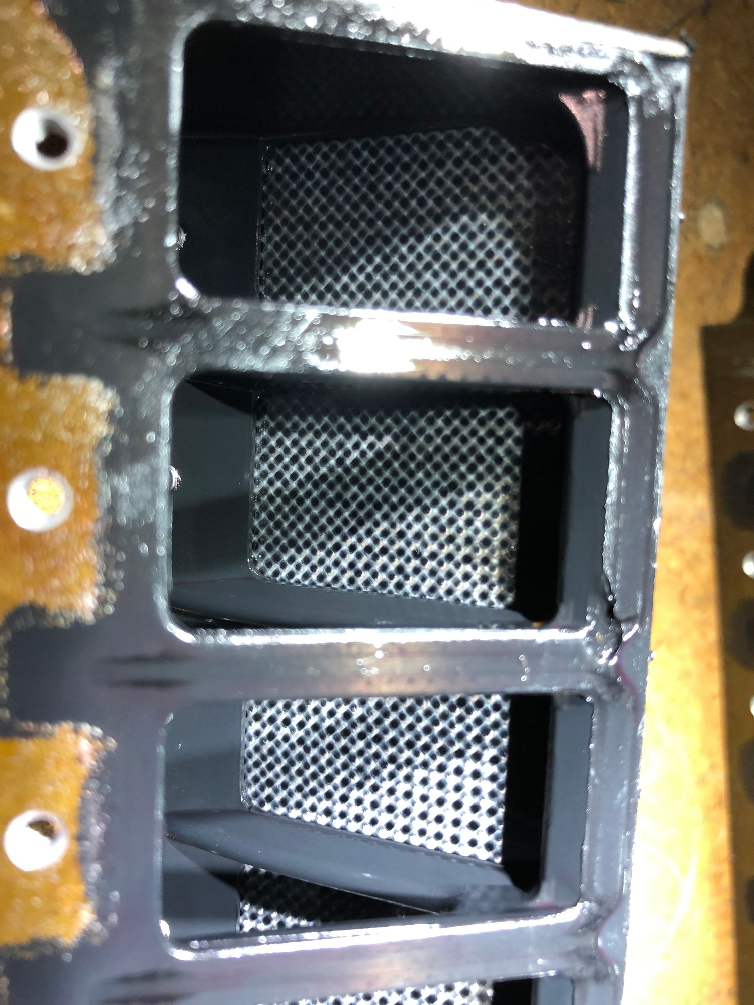

I had CCMS do their reed cage mods last winter and also run their reed sets. There was a noticeable improvement at idle.
IDLife Express 03-07-2019 08:16 AM
The problem with rubber is that with fuels, it will always break down. A way to fix this issue is to remove the rubber, clean the metal cage and dip the cage in ProSeal, then lay the cage on a sheet of glass, with a smaller cut piece weighted to the top side creating a perfectly flat sealing surface. Trim as needed for airflow with a fine X-Acto blade and if you started with a truly cleaned surface, they will last as long as the reed itself.
ProSeal is a fuel sealant used to build tanks in the wings of aircraft, seal aluminum panels and retain sealing on pressurized windows for nearly every aircraft made in the world.
Double Rigged 03-10-2019 06:45 PM
Reworked Cages w/new Mercury CF Reeds
Double Rigged 05-05-2019 06:23 PM
Reed update. Motors run great with new reeds and machined reed cages. Idle perfect. Well worth the work

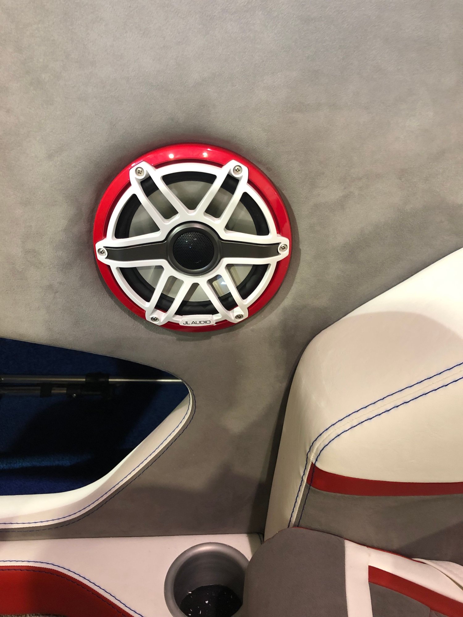

New Project underway. With a new interior comes new cockpit JL Audio M6 speakers with LED’s and new lighting project underway. Awaiting parts from Lumishore. Stay tuned for some new cool stuff with full color change, multi zone cockpit lighting tied to my underwater lights controlled through my Garmin GPSMAP 8612.
https://cimg7.ibsrv.net/gimg/www.off...c2f859148.jpeg
https://cimg8.ibsrv.net/gimg/www.off...05f86910d.jpeg
JL M6’s custom painted rings
