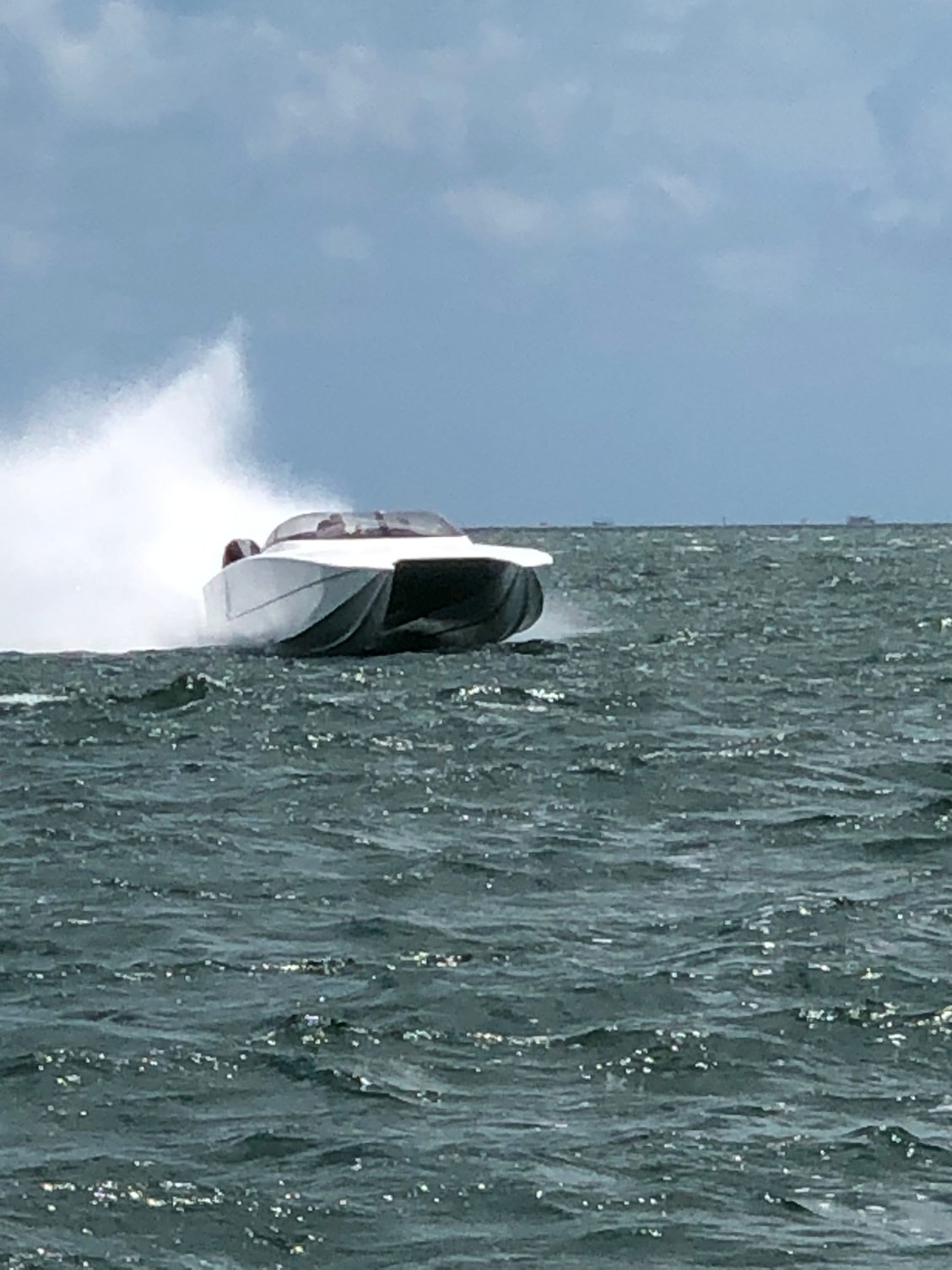

OSOSteve 08-26-2020 01:23 AM
Here is the maiden voyage, the first two hours are break in so have not had a chance to get a top speed number. Ran out of prop and had very high water pressure to motors need to come up and larger pitch prop but there were a lot of rpm's left and were in the triple digits already obviously.
Special thanks to Troy Hannon from Supreme Marine and John Tomlinson from TNT Custom Marine for providing the power when 450's were hard to get and his input on some rigging recommendations from a recent rig job he did on a similar boat.
https://www.youtube.com/watch?v=RNW4...ature=youtu.be
