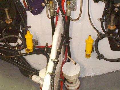

Here you see the flush valves (yellow) that shut off the hull water pickups when running on the hose. Neat!. Supplies the sea pump only, no water overboard thru the pickups.

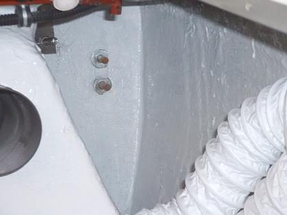

Clean & white to the deepest recesses of the hull. Clean enough Fred?
