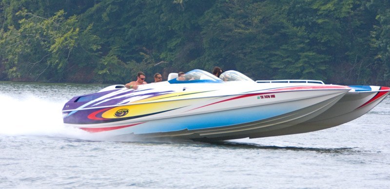

I have a 2003 36' Poker Run, 650 MDG's, motors set forward, shafts 1.5" above the bottom of the sponsons, notched transom, stock 34" B1 props,. 118 MPH max. Motors are getting freshened over winter so we'll see if we pick up a couple mph.
It carries the bow nice and runs with near neutral trim. A tunnel tab eliminates any porpoise at the transition between 60 and 80.
According to Jay's pre-delivery test notes when the boat was new it ran 120 MPH with labbed 34 B1's. I had a pair of labbed 34's, but threw a blade before I ever ran it all out.
Here's a link to our club website with a trailer for the 2008 poker run on the front page. There's a pretty good clip of my boat near the end that shows how it carries the bow. Check it out... http://www.musiccitypowerboat.com/Mu...tion/Home.html
I suggest setting the motors forward. The first time you need to work on them you'll really appreciate the easy access.
Good luck, have fun, be safe!
Jeff
