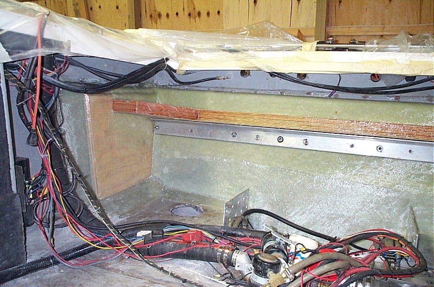

He has tripples on his 31 spirit. They had to do all kinds of strengthening to the transome and he has lots of pictures of what they did to it.
Basically a huge micro lam beam added in hoizatally.

I second what George Yurick said. Also you wont have very good range for trips with 3 and a small gas tank. When I picked up my boat in 91 there was a 26 RR with triple 2.4s in the yard at Ocean Outoard. Tony told me it was a real handful but ran about 100. I think 2 300x will be about 90 with proper rigging and dial in. Also I'm just running 2 batteries for the 3 engines, saves a little weight.
Pictures of what Jeff was talking about.

That aint no microlam. 3 layers of 1/2" marine ply with 2 layers of biax between each layer and 2 layers top & bottom, then glassed in. All done with West System epoxy.
30ctsutphen 10-06-2010 10:41 PM
Christ its stronger than a freakin micro lam beam!
