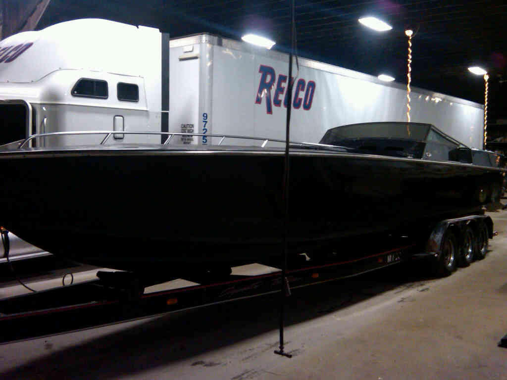

Libertarian 06-22-2012 05:12 PM
33
http://www.flickr.com/photos/80987470@N07/7422249952/
Crash-Box 06-22-2012 09:00 PM
1 Attachment(s)
Originally Posted by Libertarian (Post 3715632)
Congrats !!! Best of luck with Her ........
Attachment 477334
Libertarian 06-22-2012 09:10 PM
Thanks, the pictures definetly do her justice. Needs quite a bit of updating.
Thanks for getting picture on also, Not sure why it wouldnt work for me.
