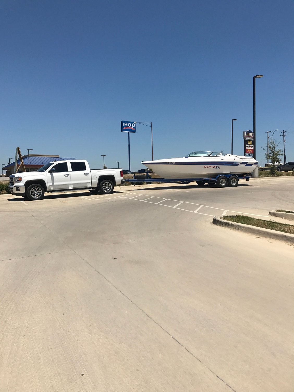

Donzi1979 03-06-2018 03:28 PM
Originally Posted by ziemer (Post 4614034)
I had a '15 Sierra with the 5.3 and Max Tow option, and it did ok with my 30, but the 6.2 will run circles around it. I've now got a '16 Sierra with the 6.2/Max Tow and it is a beast. Much better than the 5.3. I had a Ford with the 3.5 EcoBoost, and it was even miles better than the 5.3. My '15 had a 3.73 rear too, over the stock 3.42.
Only problem with the 6.2, is that no one really orders them that way, so they're really hard to find. As for fuel mileage, my 6.2 is actually better on the highway than my 5.3 was. Only difference is I do run 93 in the 6.2.
^^^^^^ I had an 08 5.3 1500 crew 4wd 3.73 and a loaner 2014 5.3 with the same set up and it doesn't even compare to 6.2. I ordered a 1500 SLT 1500 4wd 6.2 8 speed 3 years ago and it will out pull any half ton I have ever been in. I pull my 7500 lb rig (5500lb boat and 1800lb trailer) on regular basis and can get 10 to 13mpg. Is it bad a$$ Dmax "no" and I didn't want to spend $70k to get a 2500 Dmax with all the same options but it a very comfortable truck for everyday use, with tons of torque and I have pulled the boat on 300 mile trips with ease.
The down fall is the 8 speed which mine already had the converter replaced at 15k and still has the dreaded cluncking between lower gears, this has been corrected on the later versions in 16 and up and I assume the the 10 speed will be better. I also added air bags as the 2014 and up springs are a lot softer than my 08. And it will roast a stock 3.5 eco boost of the same vintage. Before I get flamed I know it is a heavy stupid truck and not a sports car.
