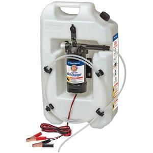

Wouldn’t an engine oil extractor pump work as a mitt vac since we all have one laying around anyways?
