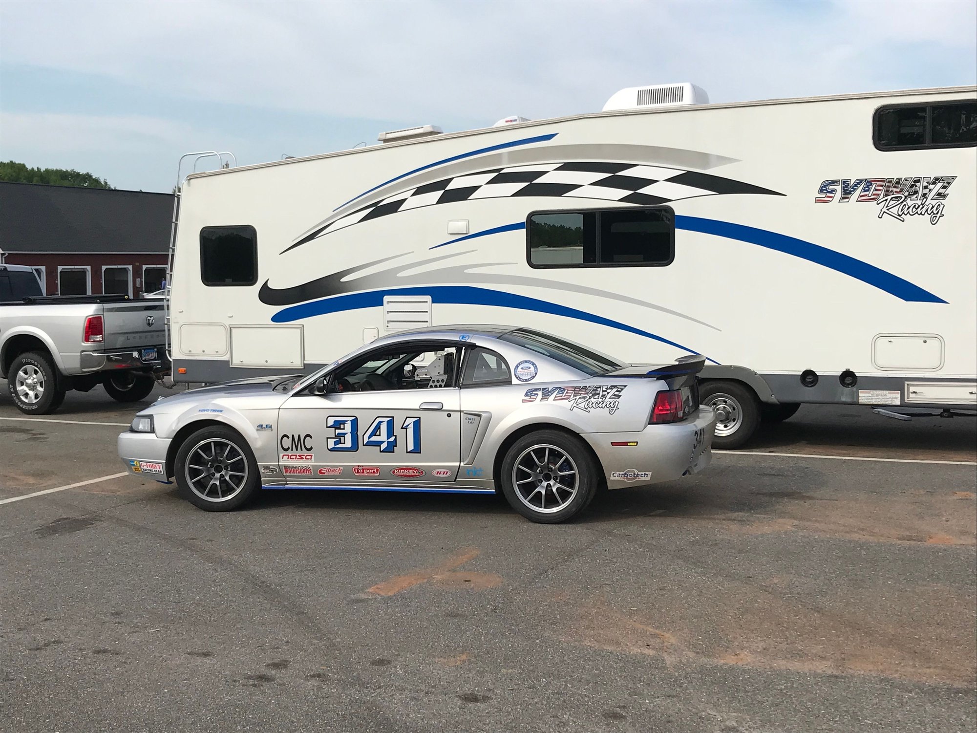

I bought this in September for my toy/racecar hauler; and LOVE it.
TPMS-APP-6.html
It comes with a repeater, and it works great.
If you don't have solid metal valve stems, you will have to change out to such, but that's not a big deal. With a portable bead breaker, you could DIY with the wheels still on the trailer (one at a time).

Originally Posted by C_Spray View Post
Thanks, Brian. I assume that the sending units are sealed, so dunking them at the ramp is not an issue?
Iím pretty sure itís good for that. You would have to confirm. I had to install the batteries and O-rings. And they sell a service kit for such which makes me think they are good for dunking. The have it on my Toy Hauler.
