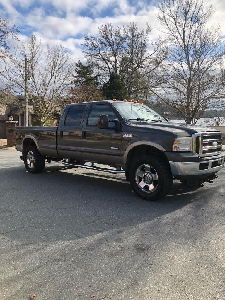

My buddy studded his 06í 6.0 at 120k ish miles and at 121k miles his head gasket blew. Apparently the studs need to be torques intermittently after installation. Hereís my 06í 6.0 with 328k on the clock and no head studs. As was said above, itís all how you take care of and drive your stuff.
