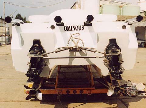

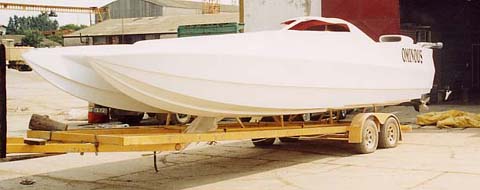

here I am!
himm last year I had single 502 in 28.But my engine was not very healty but it ran around 80's.I think with a healty 400hp inboard you should run around 90-95.
this year I have installed twin 522 cu in. and tested the boat once but the steering system went of and we did not have chance to go fast.
I am still waiting my as£hole-boat builder to finish the canopie; then I can tell you how it reacts at hi-speeds
my advice: 28 is not the best choice for inboard in speed-point of view.But looks and sounds cool.
I hope my boat will finish in two weeks ,will keep you informed ,if interested;
here are some pics.
here are some pics.
