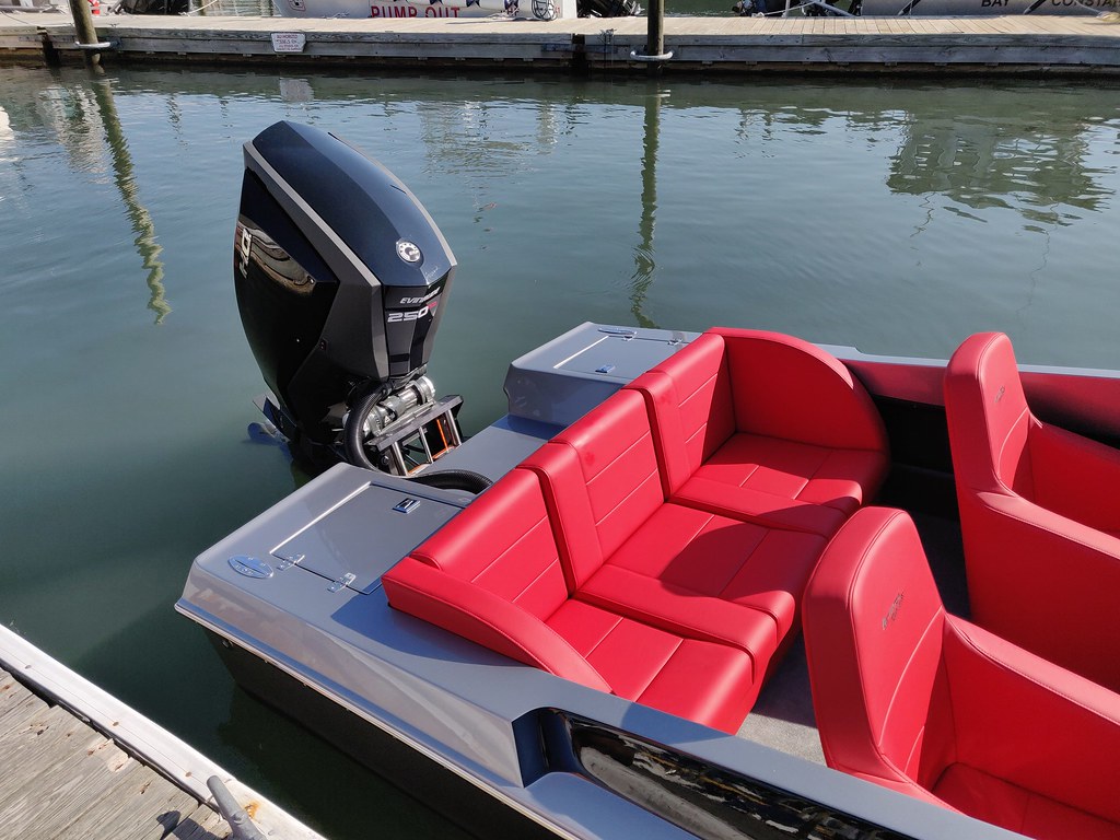

Well, we have the interior installed. Buttoning up a few things. Have to say, the interior looks better than I thought. Was a little unsure when I picked the color. Pics don't show the color well either. Have a few props to try yet, and wont' get a chance until next week. Ran great when we did a quick spin in the Long Island sound, some decent size waves. Love the sound of the big Rude. So quiet at idle, but has a nice deep sound when the RPMs get going. Boat is solid as a rock.
Have a Bravo XS 27", Fury 4 25", ProMax 28", and slightly modded Trophy Plus 26" to try.
Attachment 576499
Attachment 576500
Attachment 576501
