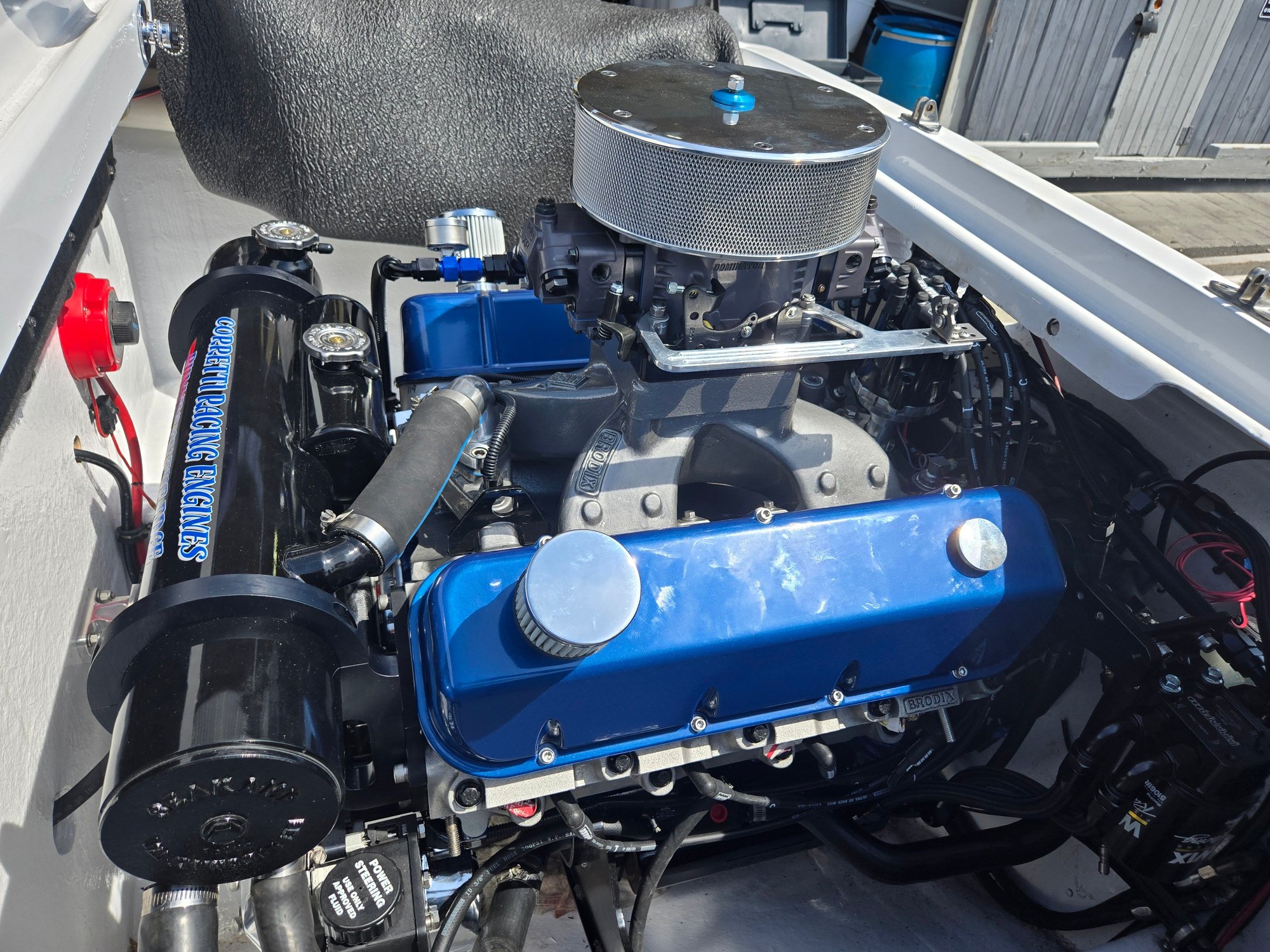

OK so alittle update.....motor is in...took some elbow grease but we got it in....it is a very tight fit....lol....waiting on the seadeck install.....a pic and video.....

kreed 04-29-2026 06:44 AM
WOW....that looks amazing! Man, this boat is gonna run good! Looking forward to some speed numbers. Nice work on this resto...such a cool boat.
