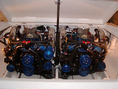

My 2002 ,37 has had some engine mods to the HP500's, 509ci, @ 590 h.p. with a top end of 90.2 on gps @ 5700 rpm on worked 30 bravo's and a 1 inch drive space. The drive spacer really helped cut down the slip. Pretty good for stock looking power and stock Bravo drives.

Nice Excursion, 90 is a big #, especially with a reliable package like that!!

James/Excusrion's boat is sick fast. Realize though that 2002 and earlier boats will run a tad faster with same power as they are a bit lighter. 2003 boats and up have a full cabin liner, whereas the 2002 and earlier boats do not. Rollin' Thunder, another 2001 AT here in VA owned by OutlawMark runs around 85 with stock 500s and an agressive X-dimension with full genset, diesel tank for genset, and AC.
