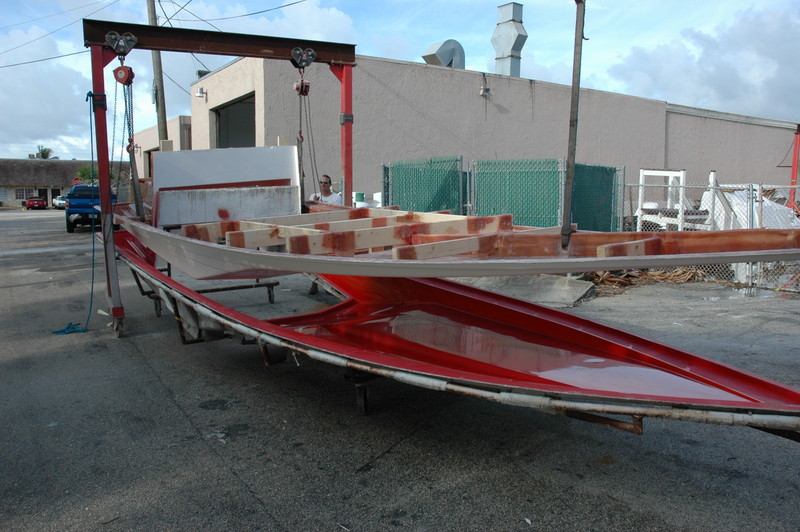

New 28 deck out of the mold.

Nice! So the top portion is the "plug" and the bottom portion is the mold you will use to make the actual deck correct?
The term plug refers to the model we pull the mold from. It generally is disposable when the mold is built.
Here's the easiest way I can give you an example. Hopefully this won't show my age too much: When you were a kid do you remember making a plaster model of your hand in grade school for your folks? They would take a small plate or bowl and fill it with plaster and you would press your hand into it and wait a few minutes while it dried? Pull your hand our and there was an imprint of your hand?
Your hand was the plug. The plaster dish is the mold. You could fill the mold with a material, pull it out and there would be your hand! Kinda same as a boat.

Look'n good! now the real fun begins. So this makes that 28 deck mold a throw away or are you going to use the frame for the 29?

Well. what is it? egg beaters or I/O? Does the same mold work for both?

The top part (white) will be cut and lengthened, faired, gelled and become the the new deck plug for the new 29 model. Then a mold will be taken from that which will become the new 29 deck. Then the actual 29 deck will be pulled from that new mold. That's why boats are so expensive, basically have to build two boats prior to being able to layup and pull the first actual boat..
