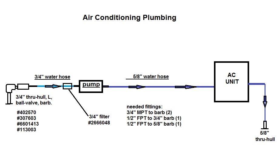

Where you the guy I talked to last week that couldn't locate the AC unit?
Anyways we order in the AC parts as needed. Nothing on the shelf. Here's a schematic with the part numbers from Port Supply. The pump is available from a number of vendors. I buy ours in the AC kit.
Pat

No we haven't spoken. I've call twice and left messages both times. I'm not sure the a/c is going work even if the pump is replaced? Can I buy the entire kit thru you to replace it? It has a 5k btu in it now, is that still what y'all are running in them? I'm in Texas and it gets really hot. I want something that'll get cold, not just cool it down.

You can buy the units complete. Call Ed Ruff. However I would see if the pump in the bilge works first. As Drock said it is a couple hundred instead of a couple thousand.
