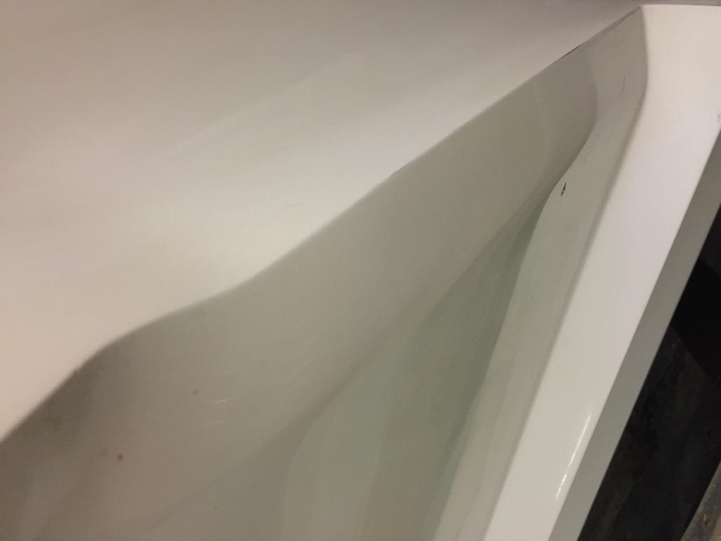

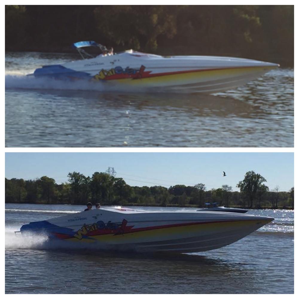

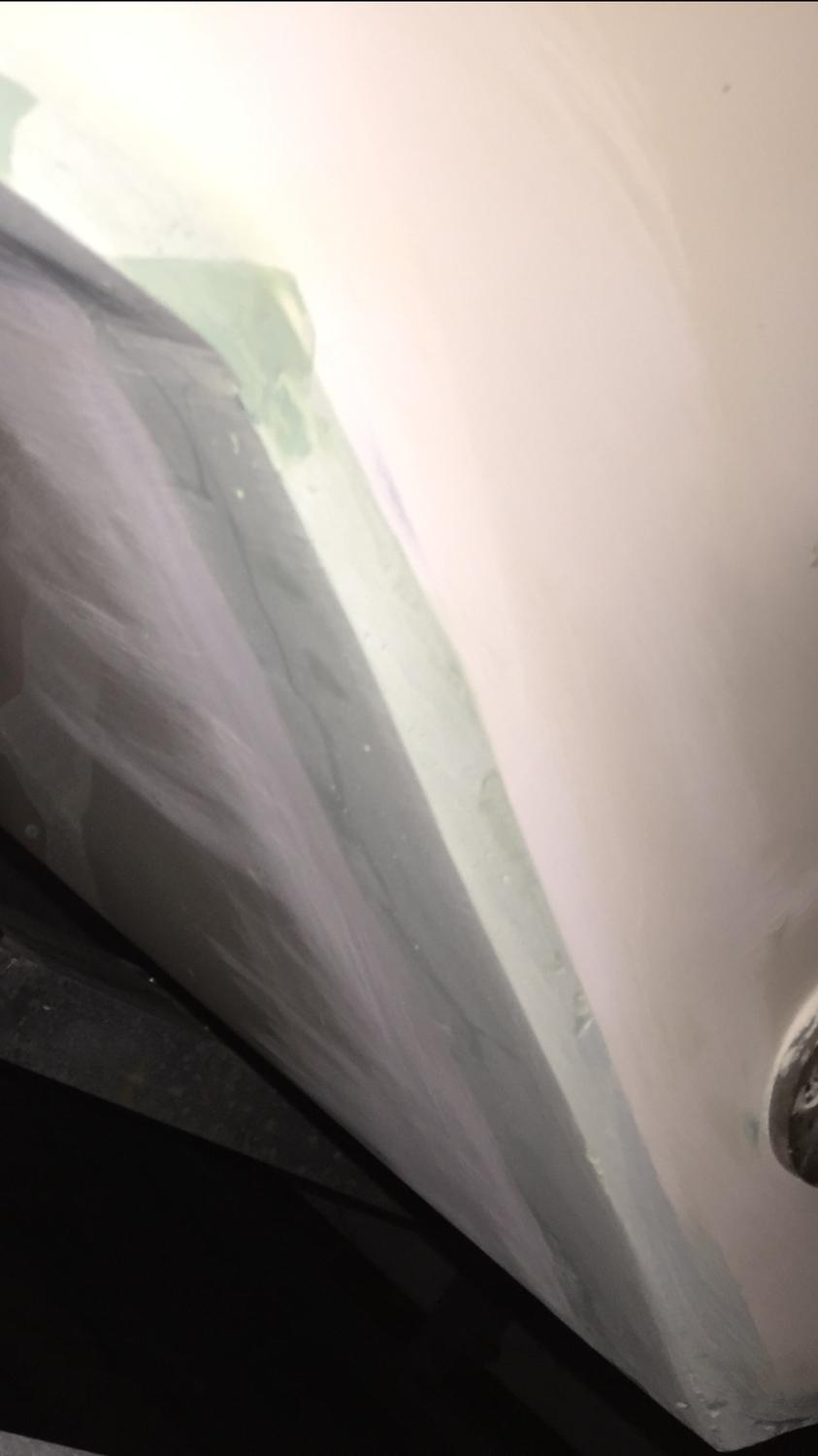

It's hard to believe by putting back the straight edge on the step from a 2 inch bevel that was done to prevent a porpoise above 100 give me about a 10 mph gain at 3500 rpm[ATTACH=CONFIG]555173[/ATTACH][ATTACH=CONFIG]555174[/ATTACH][ATTACH=CONFIG]555175[/ATTACH]

Glad to see the boat is back to performing well, getting stock power dialed back in.
