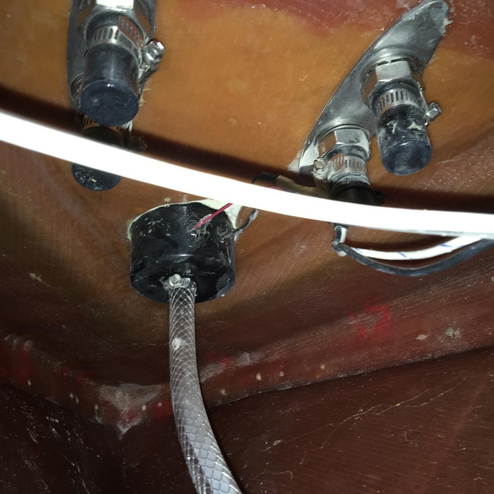

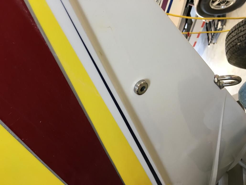

I had same issue.
I installed the correct size drain in the hull and also needed to replace the drain cup on the bow light, one grommet was missing and both wires were coming through the hole with no grommet. So between the drain fitting not being the right size to drain the amount of water causing the light cup to overflow, the overflow was also from the missing grommet.
Not a drop of water after fixing those 2 issues.
Pwraddr is offline
Old 07-21-2016 | 08:34 PM
Joined: Aug 2011
Posts: 1,696
From: Metro Detroit
All the white silicone was from someone that tried to seal the hose on the wrong sized drain.
The new drain isn't as small as the original but at least now it is all sized correctly and can flow the amount of water without backing up.
